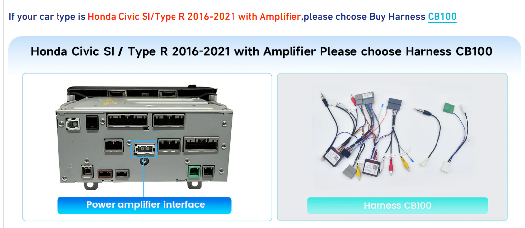

  • Just installed G13 and I am not receiving any sound neither from phone or radio. All connectors are connected and even the bypass is connected as well. What could be causing this?
  • if your car have high amp version buy cb100 compatibility for honda civic
  • @Erick Mendez If possible to provide a pic of shoiwng the back of you radio?
