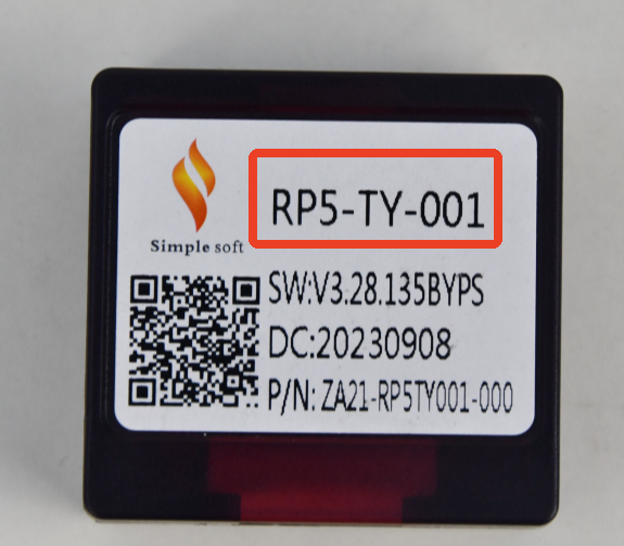

  • I have a 2020 Toyota Tundra and just received my Andriod 13 unit.  I unboxed the wire harnesses and there are two sets.  One for the 2014-2019 (CB004) and 2020-2121 (CB047).  The directions state that the Canbus Box module is shared but, in my box, both harenesses have a seperate Canbus box.  To make it more confusing, they are different size and ID #s.   On the CB004 is the RP5-TY-001 and on the CB047 is the bigger RP2-TY-001.   Has the instalation group started sending out complete harenss systems.  I don't want to hook up until this is clarified.  Are the directions out of date and there has been an update or was there an error in packaging?
    I have the 2020 Toyota Tundra and should be using the CB0047.  Looking for some clarification before I complete the install.  Is the RP2-TY-001 the correct (came attached) or should I switch and use the RP5-TY-001?

  • @Matthew Bartelt
    Thank you for your contact  and sorry for the confusion.
    CB047 with  RP2-TY-001 is for the 2020 Toyota Tundra.
    We remain at your service.
  • I have a 2018 tundra and dont know which box to use
  • @Aj Mayo
    For the 2018 tundra,please find the CB004 cable with CANBUS RP5.
