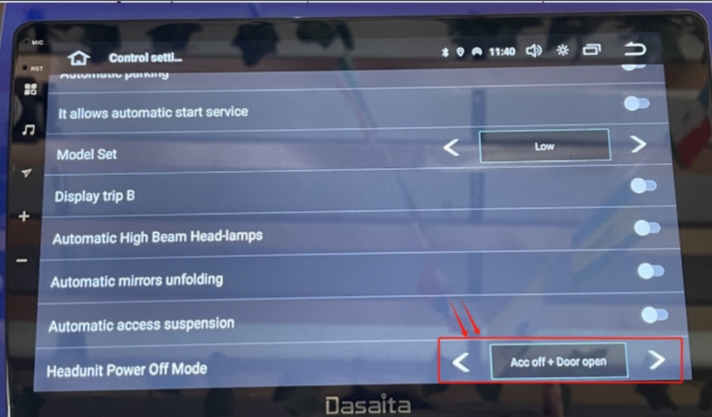

    Has anyone installed a Dasaita radio in their Jeep and noticed it stays on even after removing the doors? The head unit doesn’t recognize the doors are off due to the sensor mismatch.
    Solution:
    ✅ Go to:
    Control Settings > Head unit power off mode → Select "Acc off + Door open"
