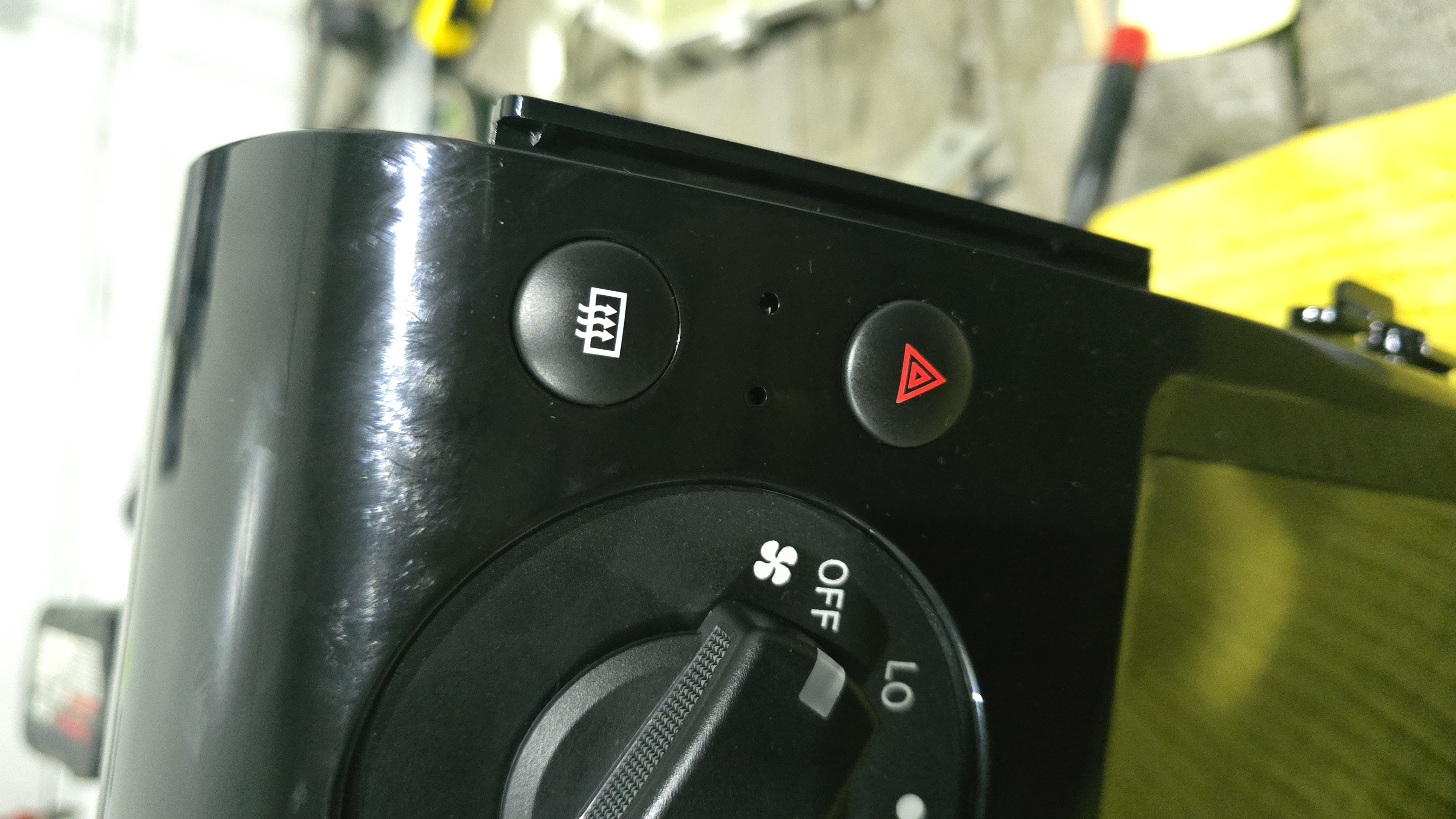

    Recently bought the FJ Cruiser large screen which replaces the OEM hazard switches with new ribbons and switches. The hazards won't go off as if the switch is not working. If I replace the Dasaita switches with the OEM ones I can turn them on and off.

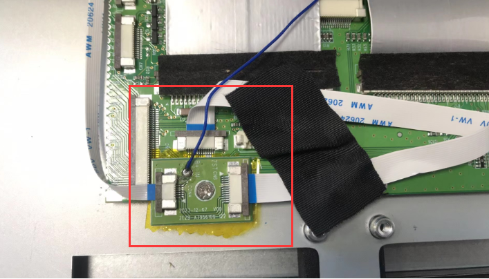

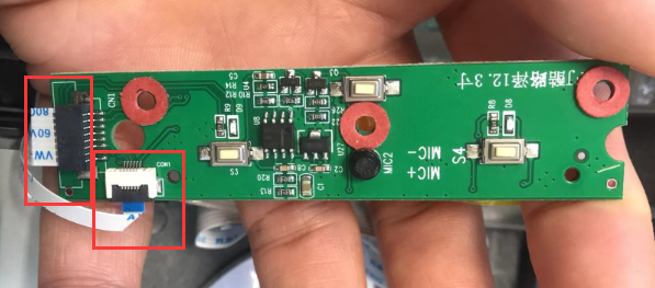

    If possible, could you please try to check if the ribbon and the board for the hazard are connected properly.

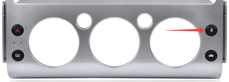

    For further confirmation, please tell us whether the Seat Belt button can light or work.

    If I remove the ribbon from your switch and replace the switch with the OEM switch, it works perfectly.
    As soon as I install the Dasaita switch again, it doesn't work. This is the same with the seatbelt button.

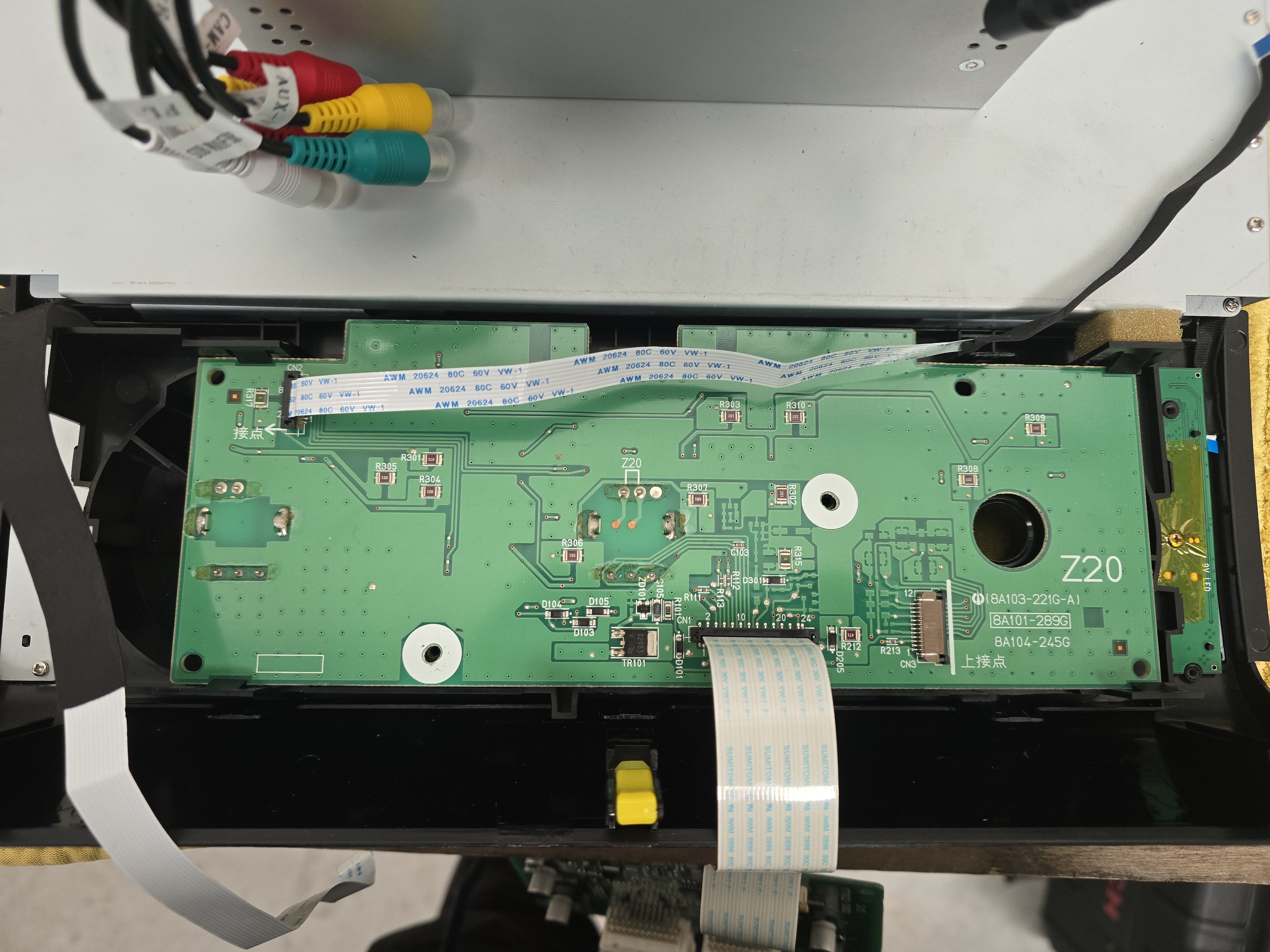

  • Please see my circuit board. It's different to some of the photographs you seem to post.
  • @Support Dasaita Ive now tried flipping the ribbons on the Dasaita (switch side) of the ribbons and this now lights all the lights up. The rear demister is working, the hazard light lights up, but when I press it nothing happens
