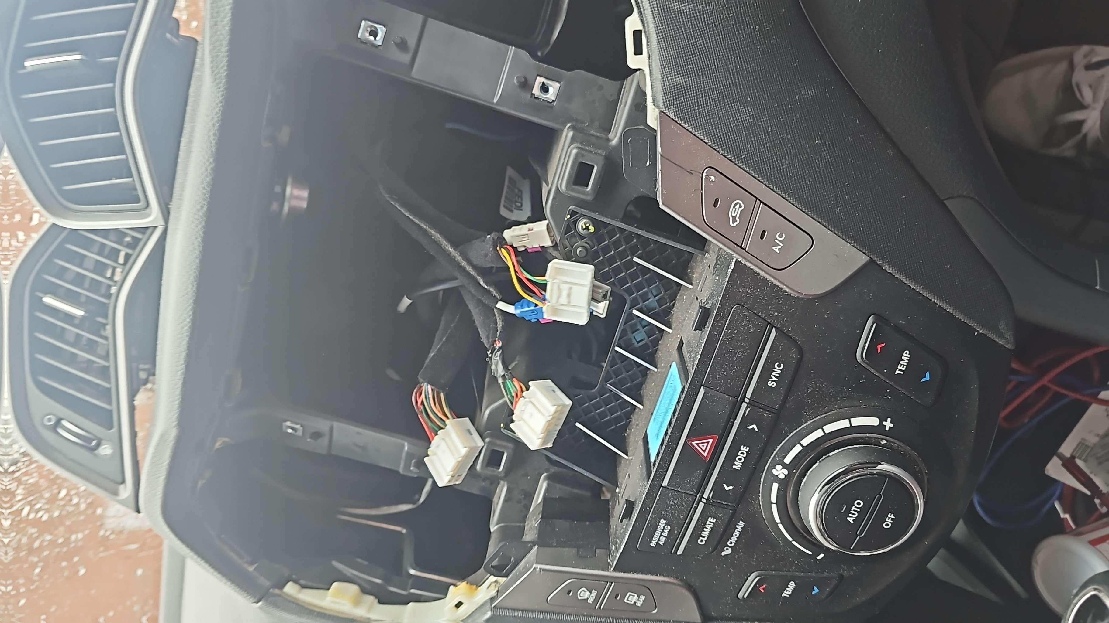

    ​The head unit boots up perfectly, and the CAN-Bus decoder is working partially – it reads car data like air conditioning, battery status, and open doors. However, there is absolute silence in the speakers. The factory Infinity amplifier just won't wake up.

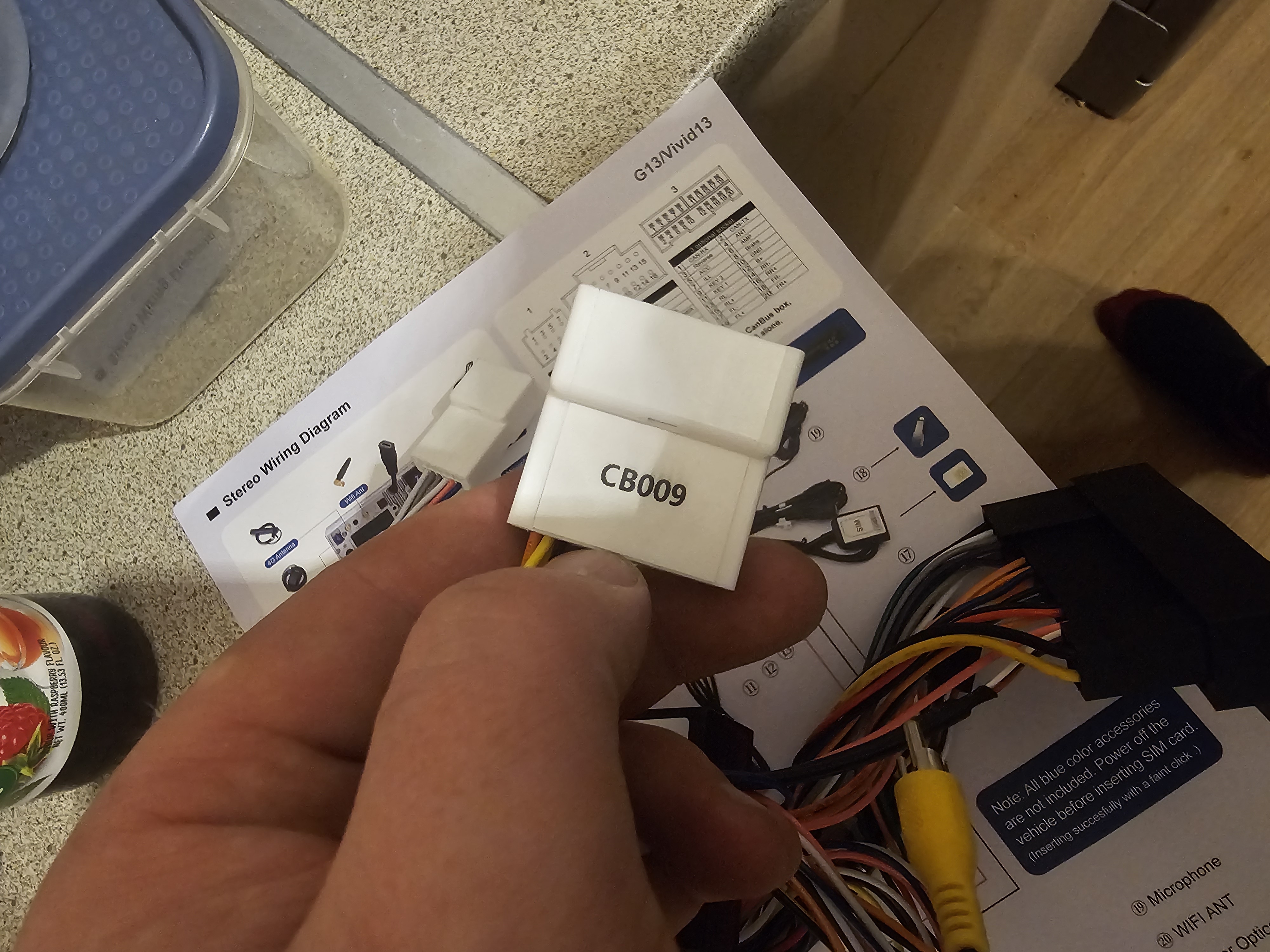

    ​I have spent over 5 hours troubleshooting this, and I am pretty sure I received the wrong universal wiring harness meant for the base audio system. Here is what I found:

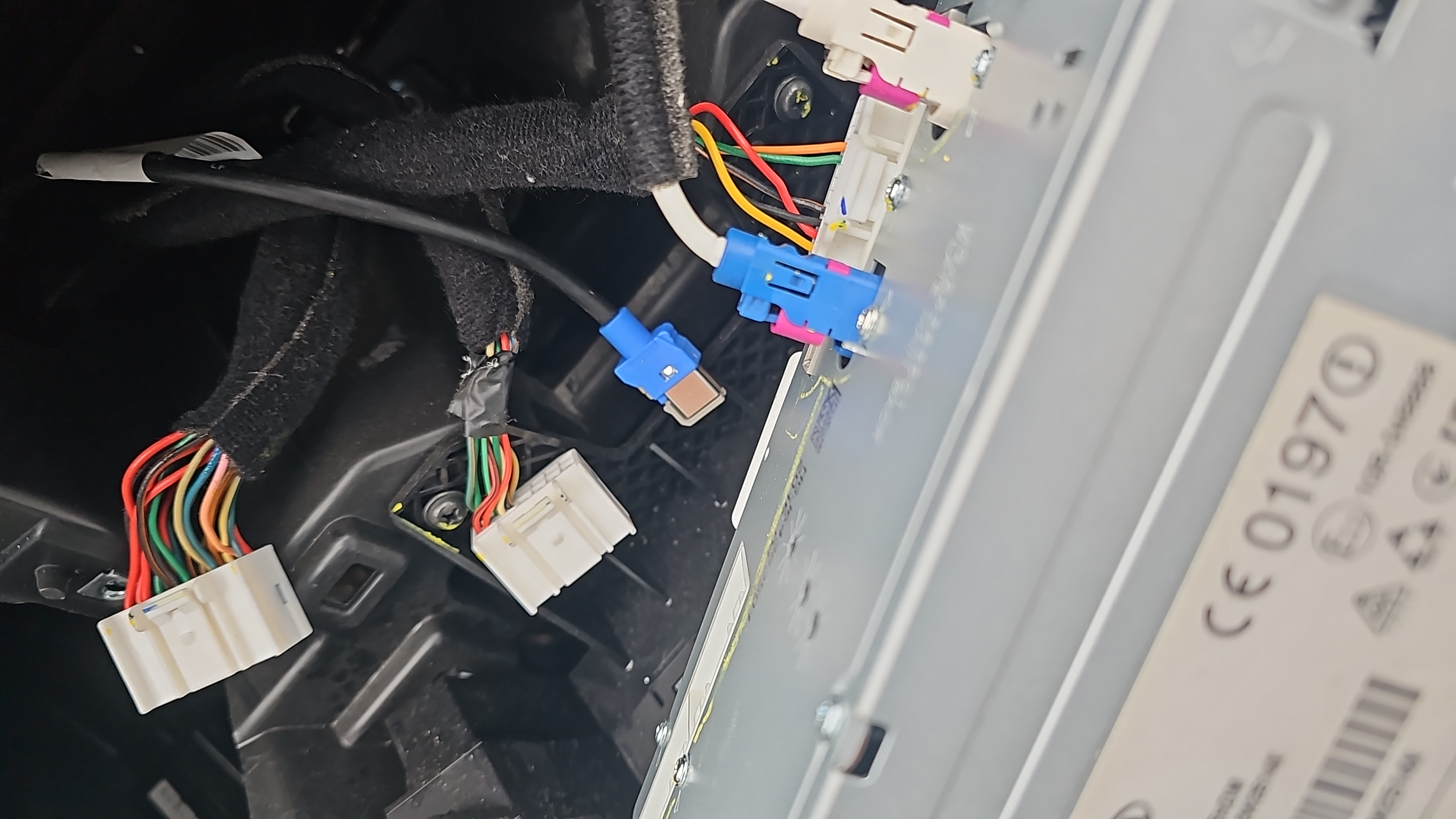

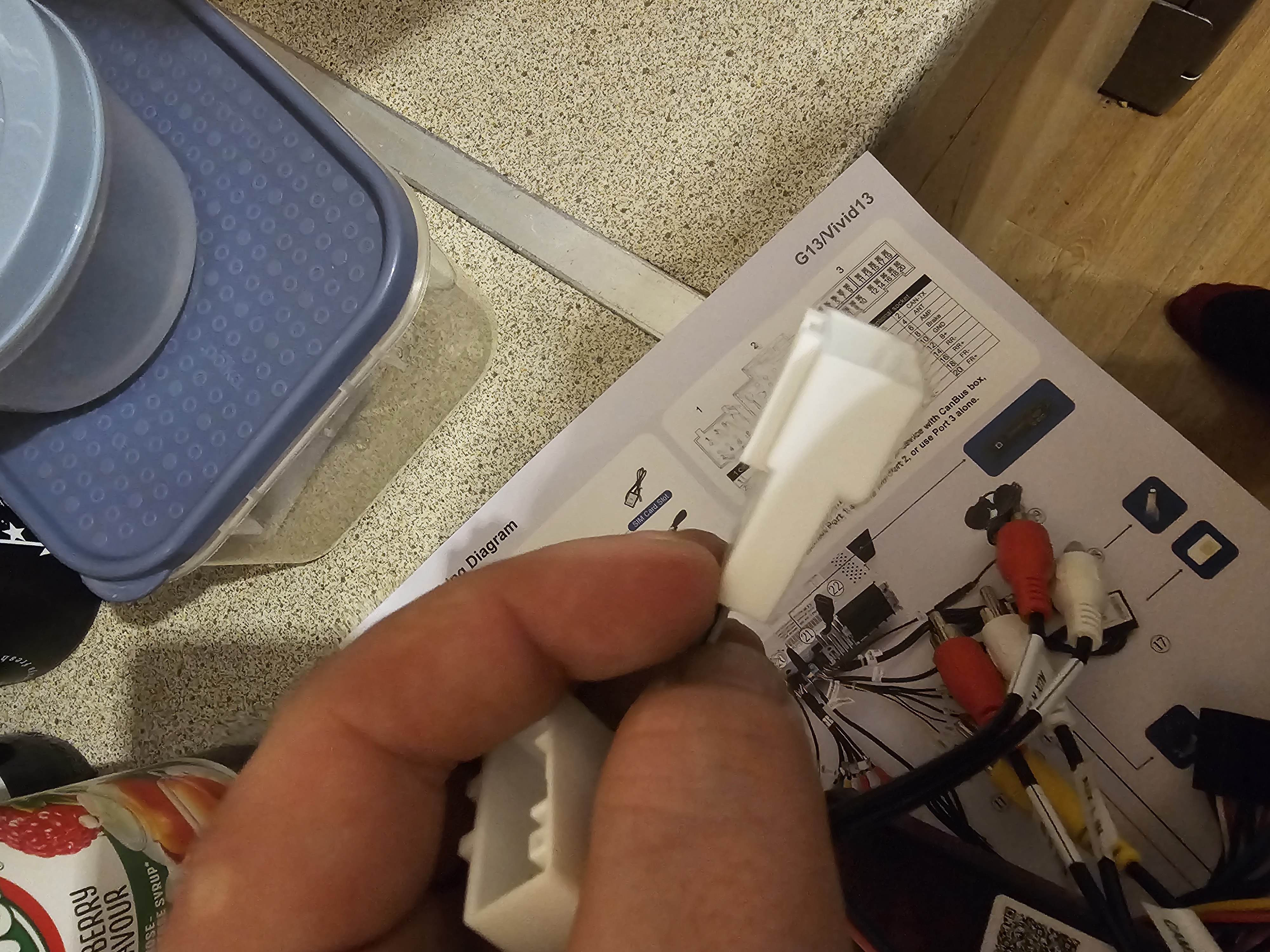

    ​Extra loose connector: There is an extra white plastic plug on the car side that is left completely loose because there is no matching connector on the Dasaita harness.
    ​Missing pins in CB009: The main CB009 connector is missing at least 2 critical pins needed to pass the amplifier triggering signal from the car to the radio.
