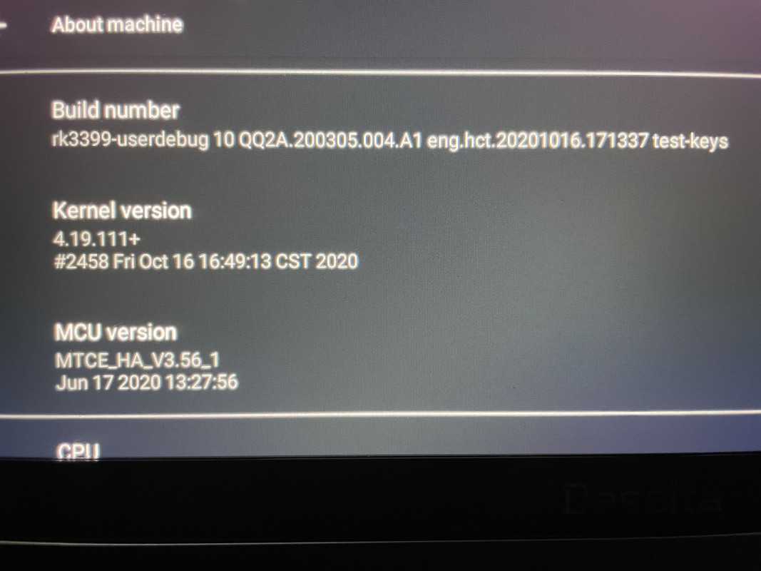

  • What updates would I need to bring my Dasaita's firmware and MCU up to date based on this screenshot?  Not very knowledgeable on the Android system, so specific links for updates highly appreciated.  Thanks!
  • Well, I used the links that are listed in this forum.  They worked, but on the 1st try, it locked up my unit and I had to do a factory reset.  Luckily, this worked.  I then tried the update again and it took.  Everything seems to be working.  All I need to do is re-install all my apps.  Unfortunately, I did lose some data for a mileage app that I use when deliverying.  Good part, I can now split screen!!!
  • @Juan Perez link for MCU 3.78 3.78:https://www.dropbox.com/s/3hd3ci3rp07ddnt/dmcu.img?dl=0
    link for firmware
    HA3_rk3399_10.0_ota(20211015)
    https://www.dropbox.com/s/35ymf7k1bwddcpo/HA3_rk3399_10.0_ota%2820211015%29%E5%8D%87%E7%BA%A7%E5%8C%85.zip?dl=0
