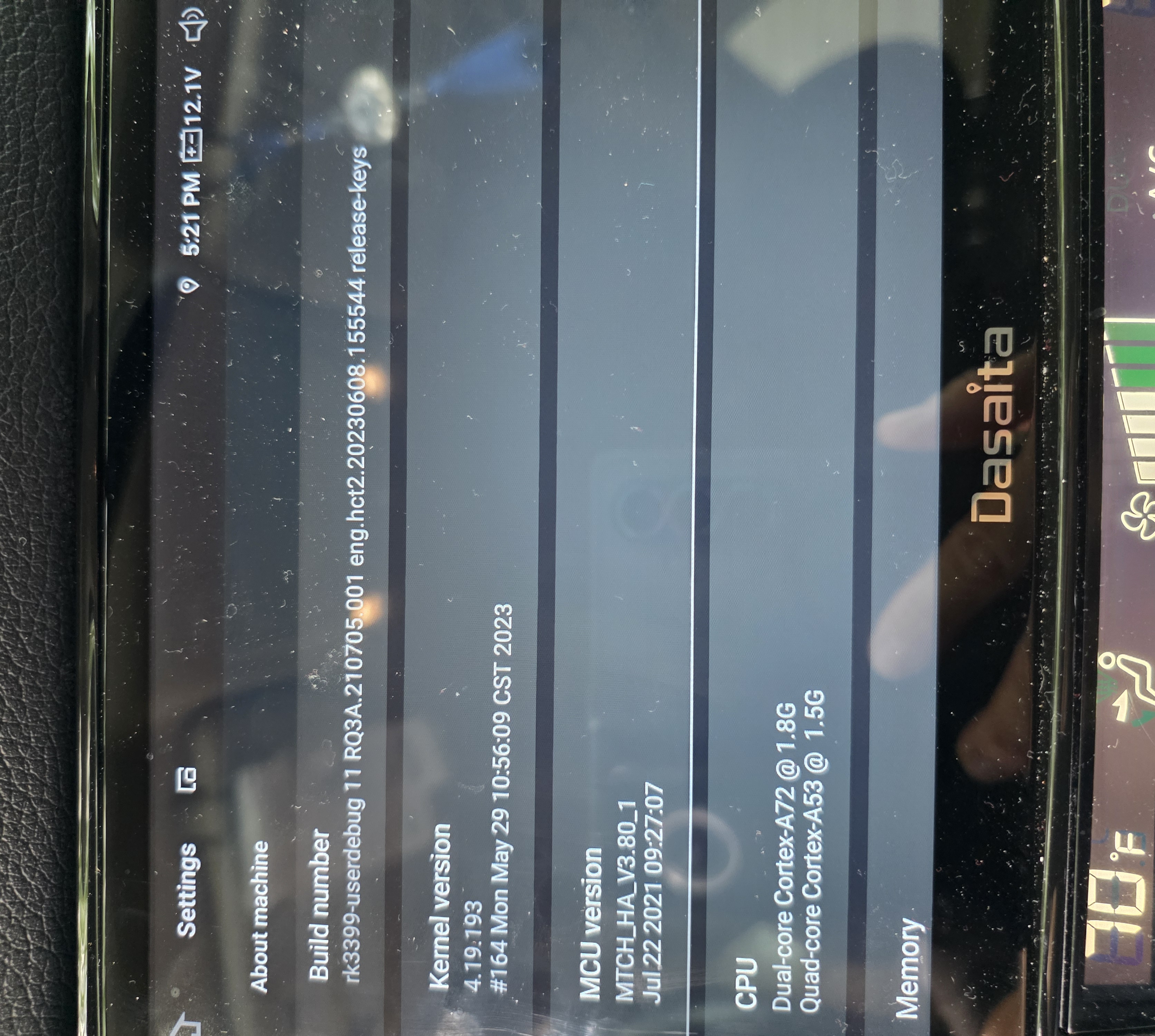

  • I'm having issues with the blue connections with my new phone. Before, no issue with my Samsung Galaxy S25 Ultra. Now, no connection with my Samsung Galaxy Fold 7. Any help will be greatly appreciated.
    Here's my Dasaita radio:
  • @Jovan Mercado
    Thank you for your contact.
    Here is the latest vivid 11 version
    Vivid11(20250401)
    https://www.dropbox.com/scl/fi/gvynerjbwf5qlcap3bphs/update.zip?rlkey=v1p7o6vppnyfpm9cgwguqwak2&dl=0
  • @Support Dasaita Thanks!!
    I will work on this and let you guys know how it goes.
  • @Jovan Mercado No problem,thank you for your time.
