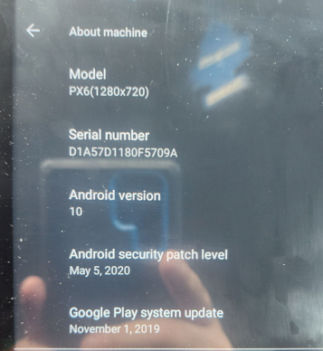

    In order to help you better, please provide the following information:
    Order Number & Purchase Date.
    Picture: Settings > About Machine > Build Number; MCU version.
  • @Support Dasaita
  • @Robert Sullivan
    Please firstly try to use a Pin/Paperclip to press and hold the RST Button for 15 seconds to enter the recovery interface to do the factory reset.
    (Tap "Wipe data/factory reset" > "Factory data reset" > "Reboot the system now".)
    Here enclosed the operation video for your reference:
    https://www.dropbox.com/scl/fi/6mhzgijcv059wo2s9octl/G13-RST.mp4?rlkey=366exgktisqwb4ml1elqoge2u&e=1&dl=0
    If no luck, then please check the update tutorial below and give it a shot.
    System Firmware-MAX10-20230302:
    https://www.dropbox.com/scl/fi/mwzw2q4ojdfoz3mnp0i08/update.zip?rlkey=np70fog84q4mmy903xsofdz13&st=znaujgwo&dl=0
    Copy the file “update.zip” to the root directory of USB drive.
    Alternatively, please manually go "Settings > System > System updates" to start the update.
