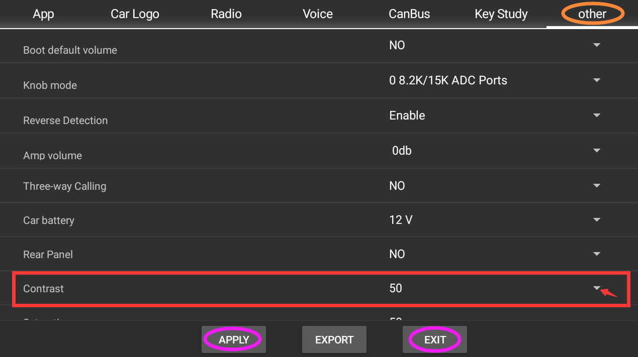

    Please try to do as follows:
    Settings > Car > Factory setting (password :126) > Other > Contrast > Adjust the value > Apply > Exit > Reboot.
