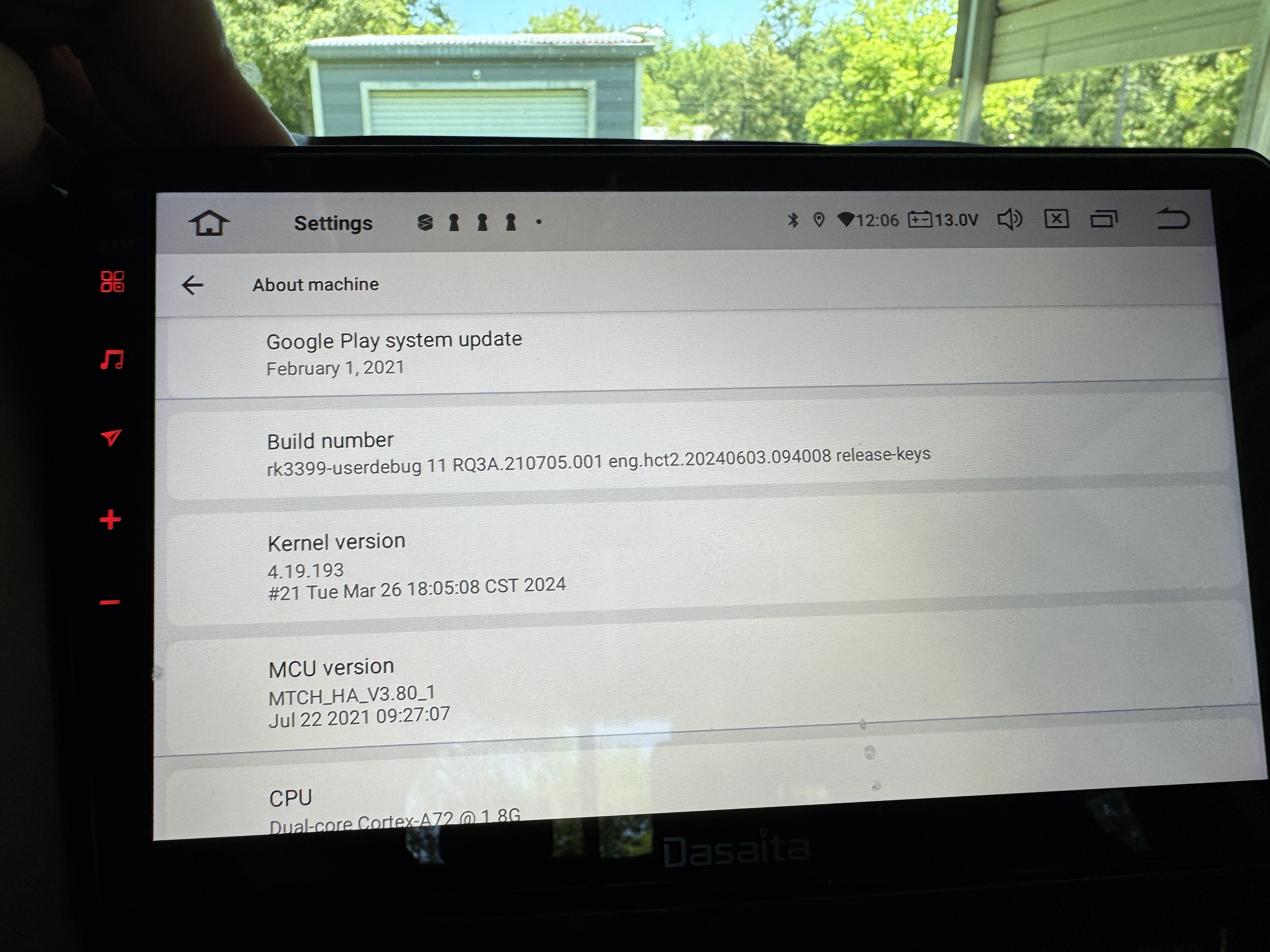

  • Yes, that would be great. Im not sure if they're detecting some leftovers when I install the Apple Music App. When I started rooting it, I found all types of options, but nobody helps to remove it once it's been done.
    I tried going in to recovery mode, erasing the data and cache, and then I installed the version linked below. Does choosing to erase and reset from the menu inside Android OS do a different level of erasing than the recovery mode? How does that compare with choosing the "erase and reset" option when doing an OTA update from a flash drive.Version before updating
    release date 20250401
    telenav_vivid_rk3399_11.0

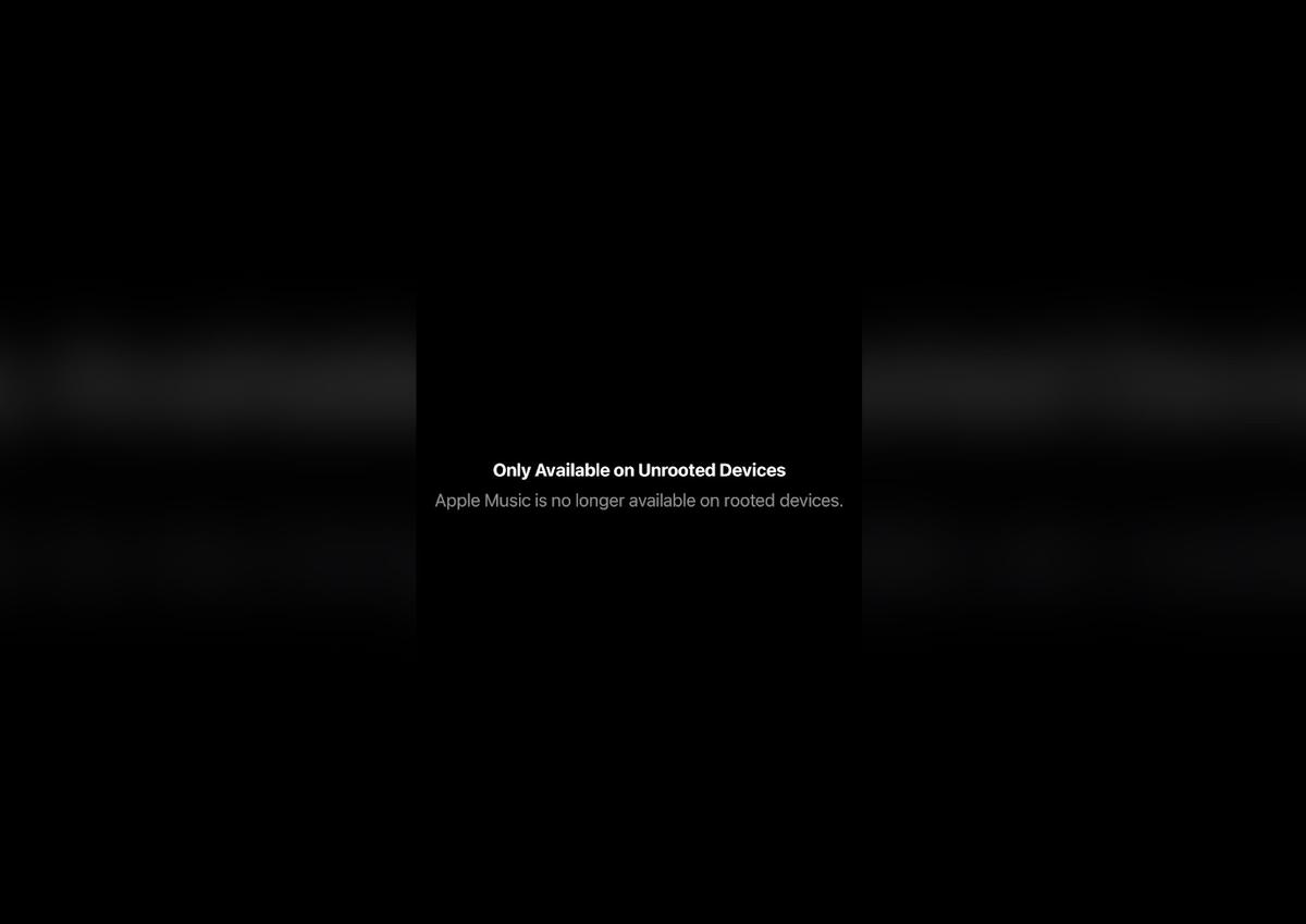

  • Ah, I misread that. Is there a writeup on doing a complete rom flash? The unit is not rooted, but certain apps say it still is. Doing the flash format is not removing whatever is that indicates it rooted to detectors.

  • This is the error I'm getting when I attempt to open Apple Music app. This is not my photo, but the error is the same. I've done recovery installations/updates choosing to wipe data and cache and installing the version of Vivid11 you provided earlier in this thread. Can you possibly send me a link to the full rom version of Vivid11s so I can erase the device entirely and install full vanilla version of PX6 Vivid11.
    Apple Music rooted error
