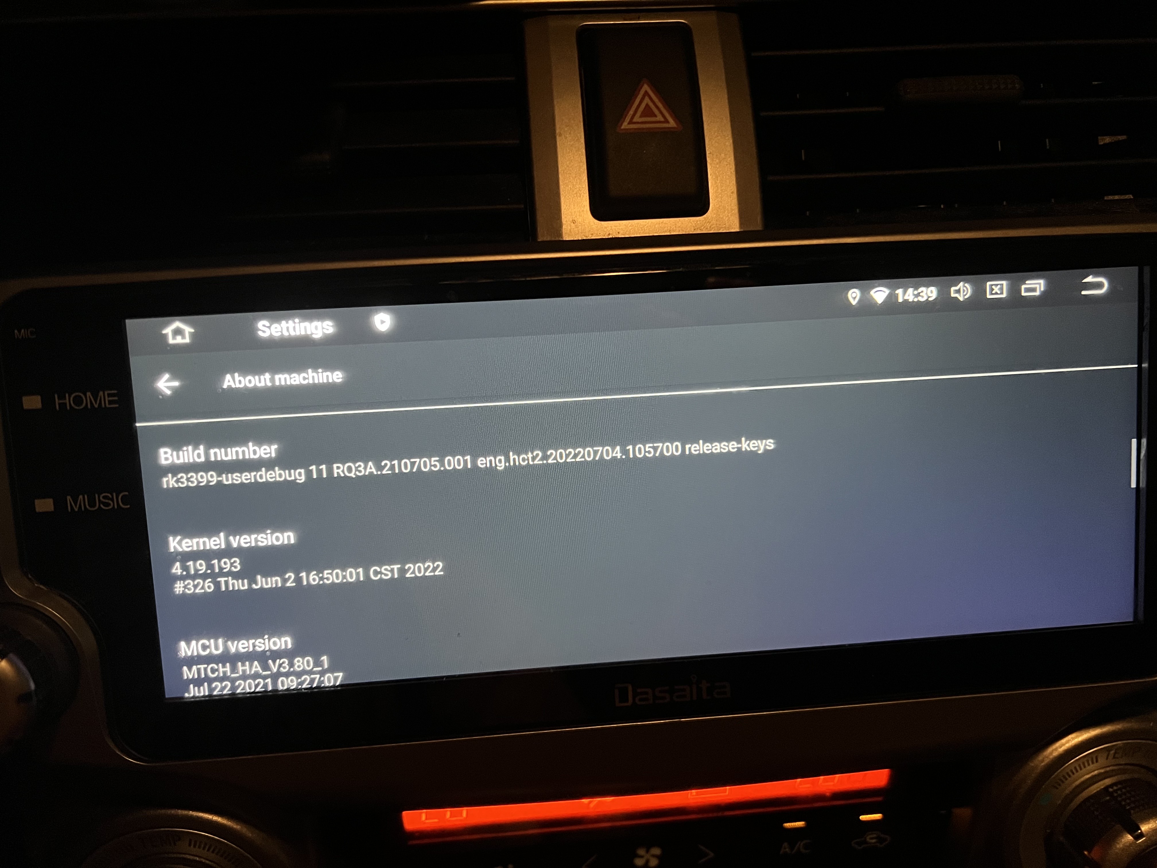

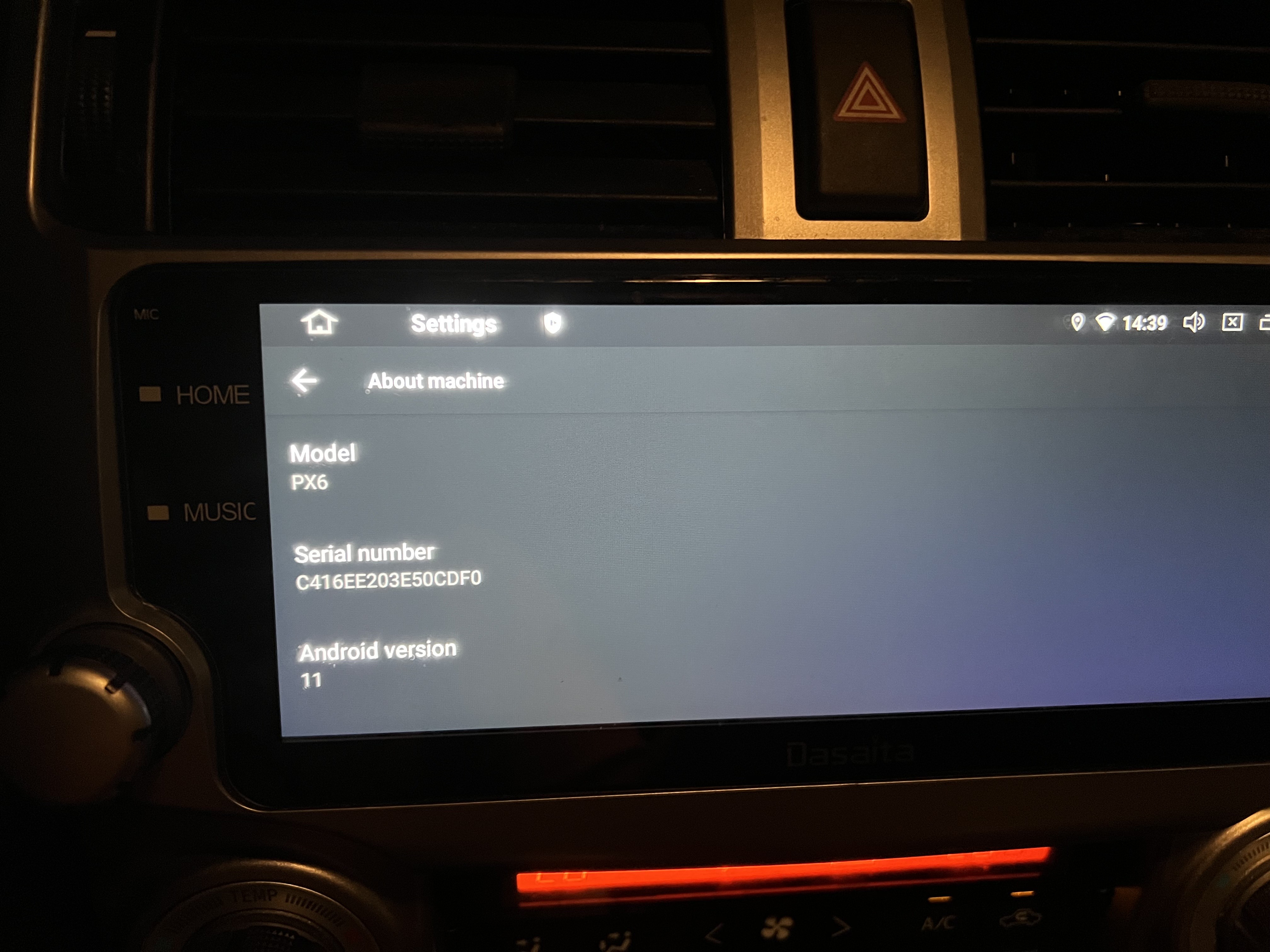

  • Hi! I have a PX6 Android 11 Headunit For My 2011 Toyota 4Runner And I've been on the ios26 beta for a while now and i turned on the Smart Display Zoom on Carplay which is now known to cause a bug for Zlink where it either gives a black screen or being stuck on a "Connecting" Loop, which I'm stuck on.
    Some say the fix to this is to update their Zlink firmware and/or an update to the android version. I was wondering if there was an update available that I should do for either Android or Zlink? When i click Check For Updates on Zlink it gives a "Onneterror". The Zlink Firmware I Have is APK Version:4.0.41.11
    This is the second time I'm posting on here since for some reason my reply to the first post is not working. I've provided the images of my Model; Android Version; Build Number; MCU version.

  • @Dustin Beseke
    Pictures: Settings > About Machine > Model; Android Version; Build Number; MCU version.
  • I've uploaded them pictures twice, not sure why they are not showing up.
