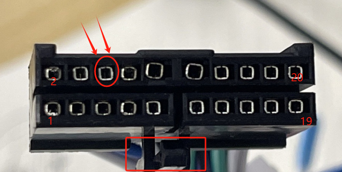

I just installed a G13 in my 2019 Toyota Corolla. I need a 12 Volt subwoofer remote turn on signal to send to my sub.
Any ideas where I can connect the sub's 12 Volt remote turn-on lead?

@Amtiskaw We are wondering if you are asking the AMP pinout, if so, you could refer to the diagram below.
Thank you. That worked. It was the blue wire that connects to the antenna connector in the Corolla.
