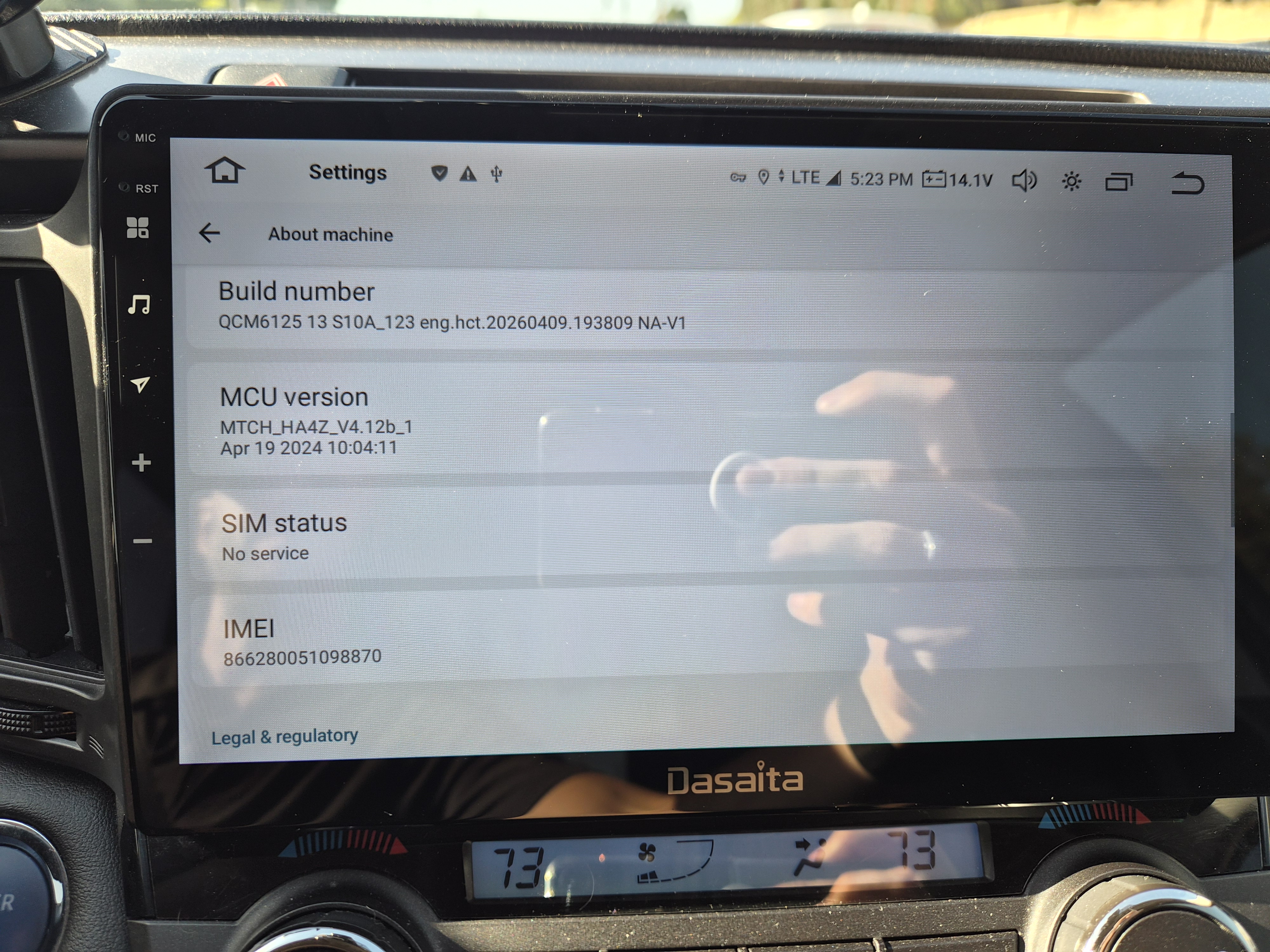

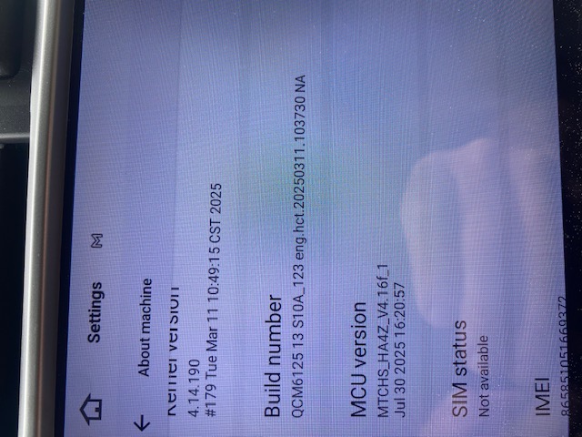

@Michael Uribe
Please go to Settings > About machine and send us a screenshot about the current Build Number and MCU version.
Thank you for your time and cooperation.
@Michael Uribe
Before updating
@Support Dasaita
Hello, below is a screenshot
