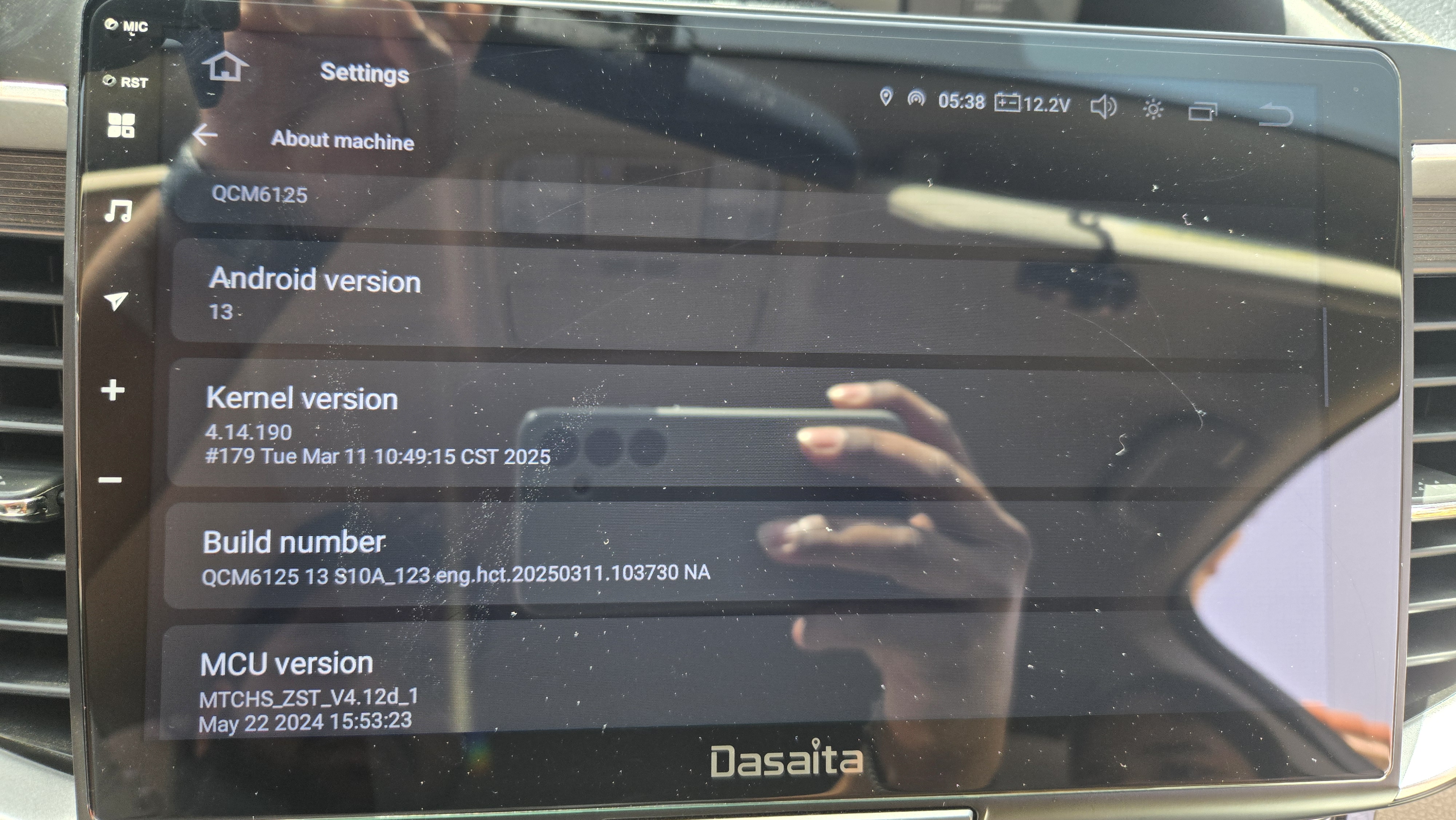

Zlink/Andriod auto keeps disconnecting and reconnecting every 3 to 4 mins. Already tried factory resetting didn't fix the issue.
Build number: QCM6125 13 $10A_123 eng.hct.20250311.103730 NA
MCU version: MTCHS_ZST_V4.12d_1
Phone: Samsung, Andriod version 16, one UI: 8.5

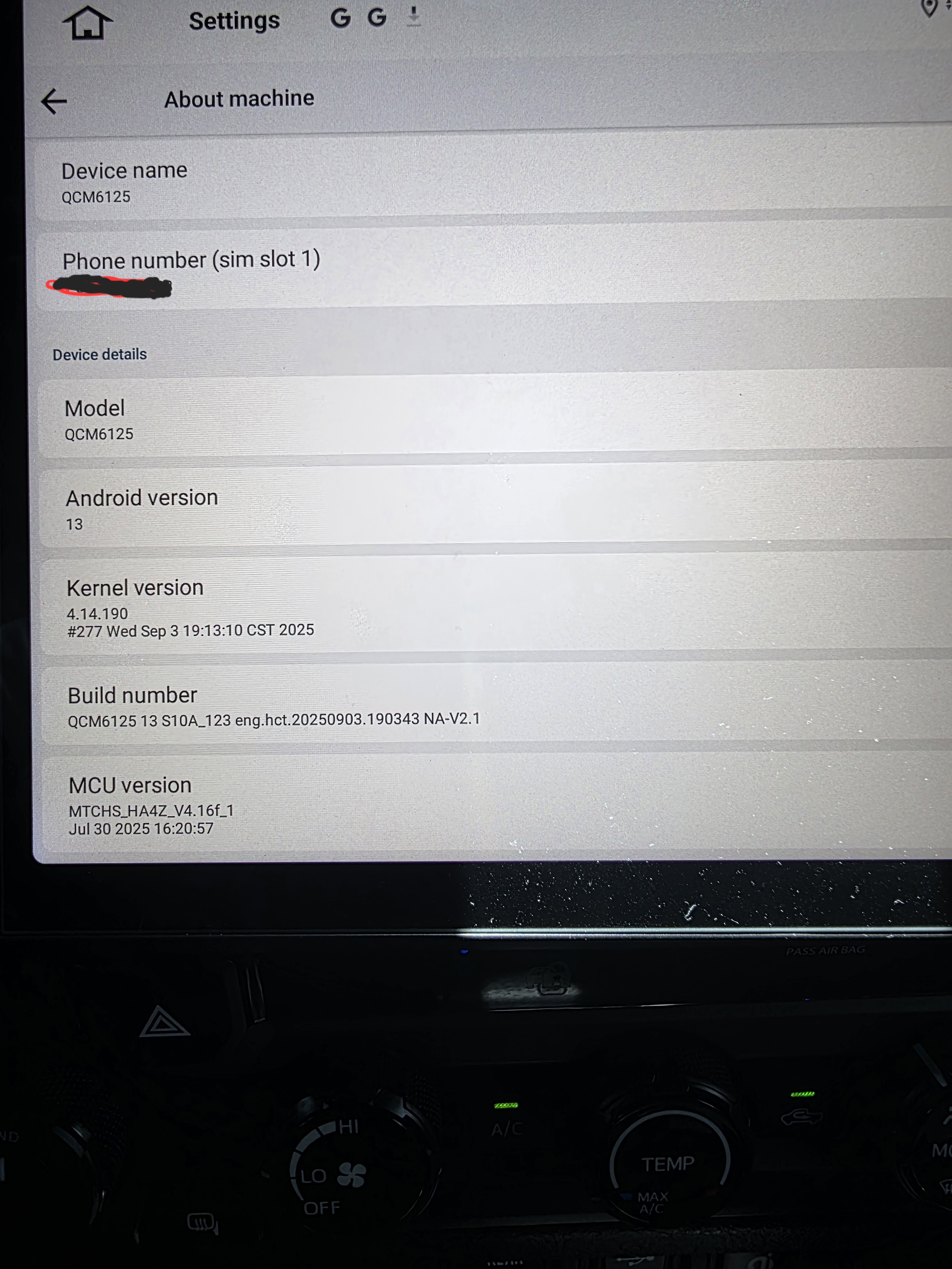

I am currently having the exact same problem on the same headunit. Keeps disconnecting and
restarting every 2-3 minutes.
Having the same issue, looking for update/fix
