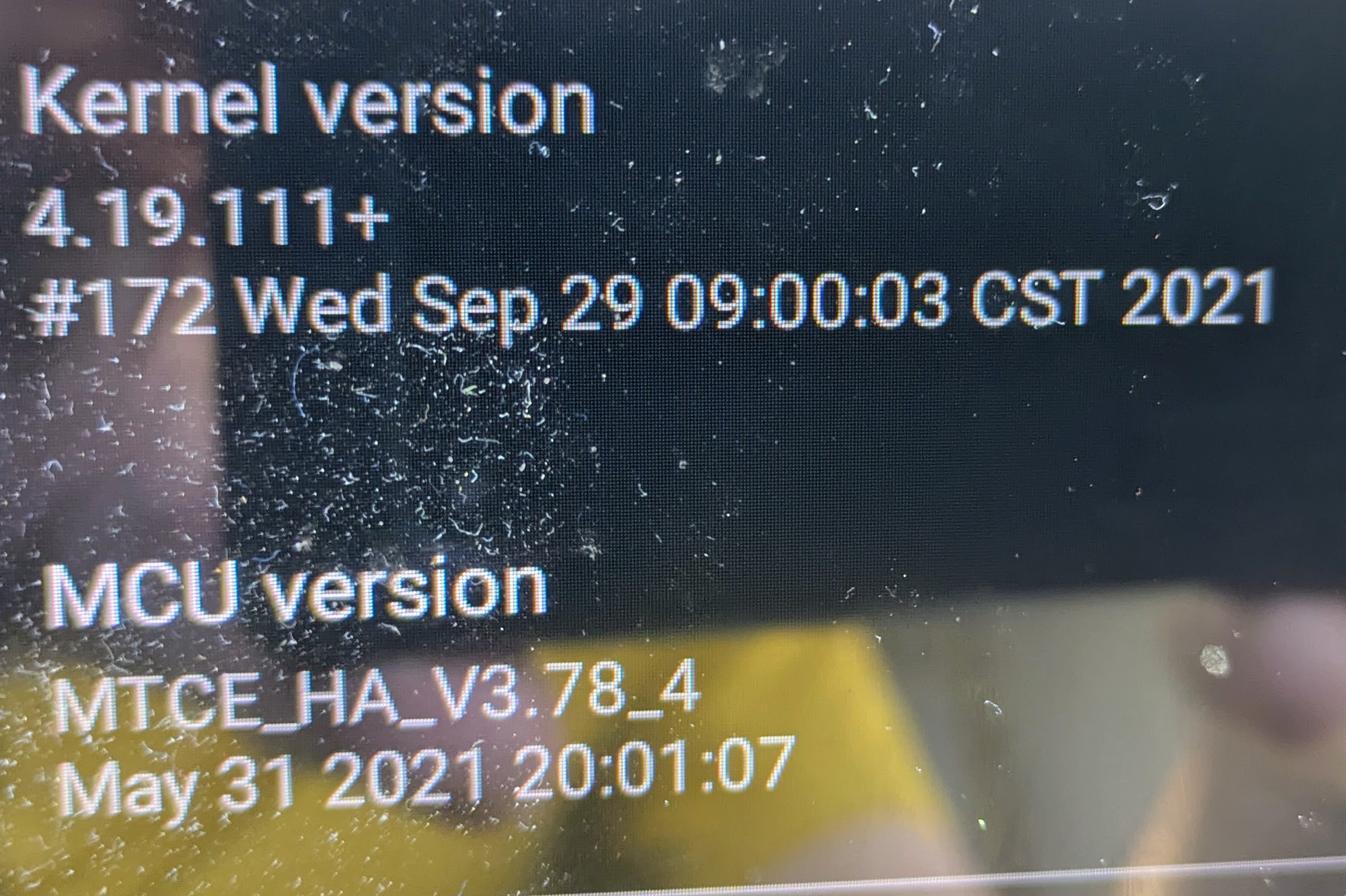

    Photo of unit with MCU Build and Kernel details:
    Kiefer Headunit / Build / MCU / Kernel information

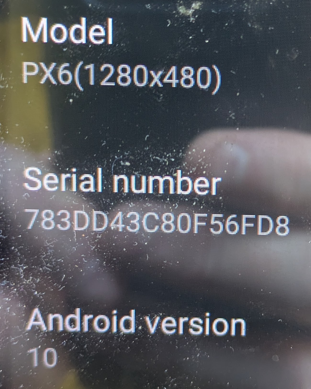

  • @John Kiefer
    Order Number.
    Picture: Settings > About Machine > Model; Android Version.
    1) Ordered on September 17, 2022  Order# 112-5359650-8085867   amazon
    2) PX6  and Android 10 Model and android version.
  • @John Kiefer
    Thank you for your reply.
    Regarding to your issue, we suggest that you can try to update the firmware.
    MAX10 Version(20230302): Make Sure your unit is PX6 Andorid 10
