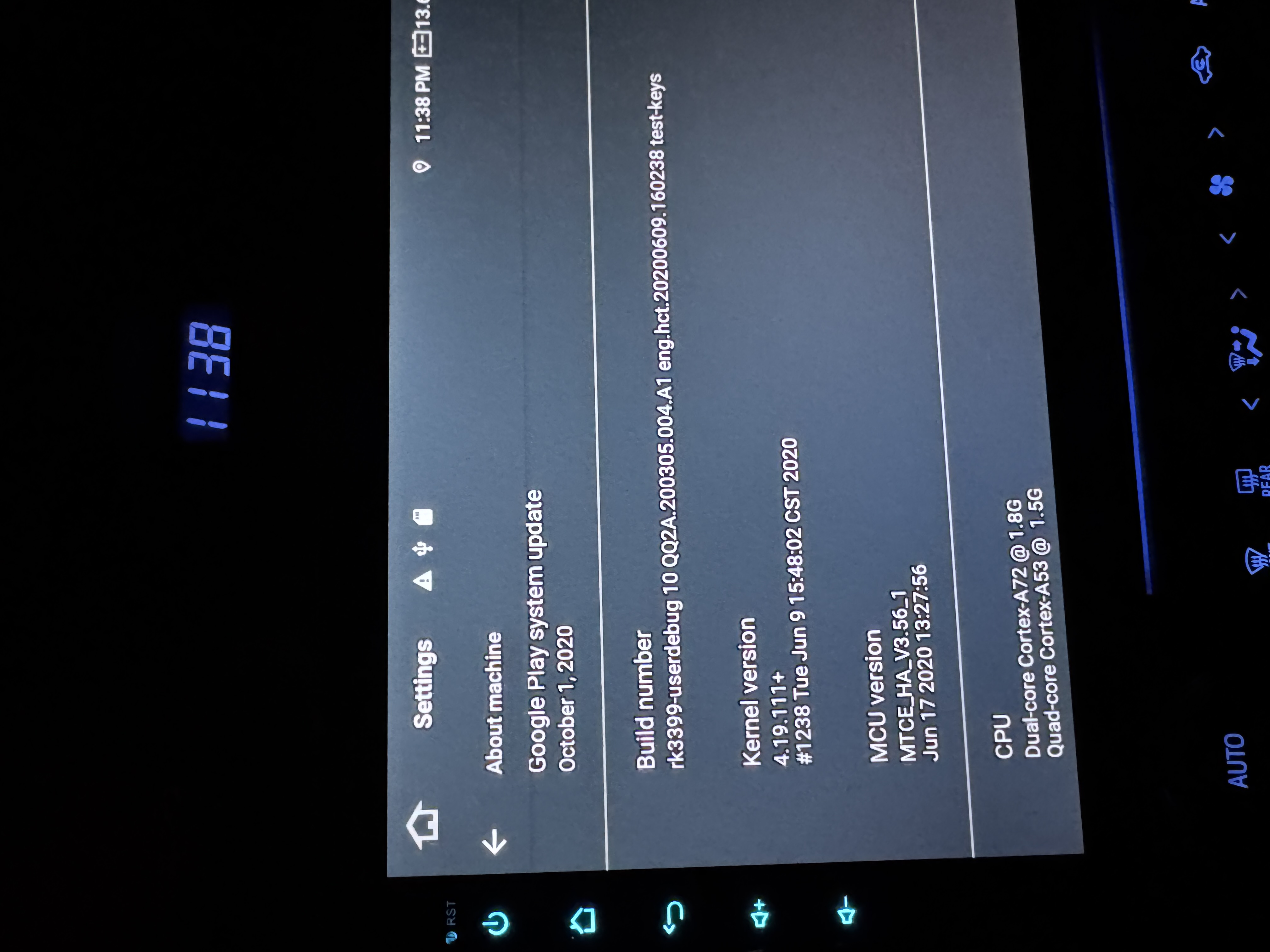

  • @Support Dasaita - Thank you! I've still been having some issues with zlink disconnecting randomly, random reboots of the head unit and apps crashing (with pop ups).
    Someone told me to download this update from 2024:
    https://www.dropbox.com/scl/fi/q6xth470whr5sz5vfrn0k/update.zip?rlkey=7fzg210e29xm2ghwu3cexxr5z&dl=1
    which addresses all of the above. However when I tried to install/update, i got the below screenshot. I am on build 29 but it is for build 30 and above. Are you able to provide me the file/download link for build 30 firmware so that I can then update to april 2024 after?

  • @Support Dasaita Hi, thank you for your reply! I followed your steps but still see an error about “expected build 29.” Can you please send me the correct update file that upgrades my PX6 from build 29 to build 30 so I can then install the latest firmware? Thank you!

    As the new system is introduced, we will gradually stop supporting older devices to ensure that the new system can run better on new devices while protecting the data security and device performance of users of older devices.
    If it is acceptable for the different UI,here is a firmware for the Public version for reference:
    https://www.dropbox.com/scl/fi/05xsn33yaco1qzc8fmn2v/update.zip?rlkey=7lj4j3l1unpb7mured9svoc2g&dl=0
