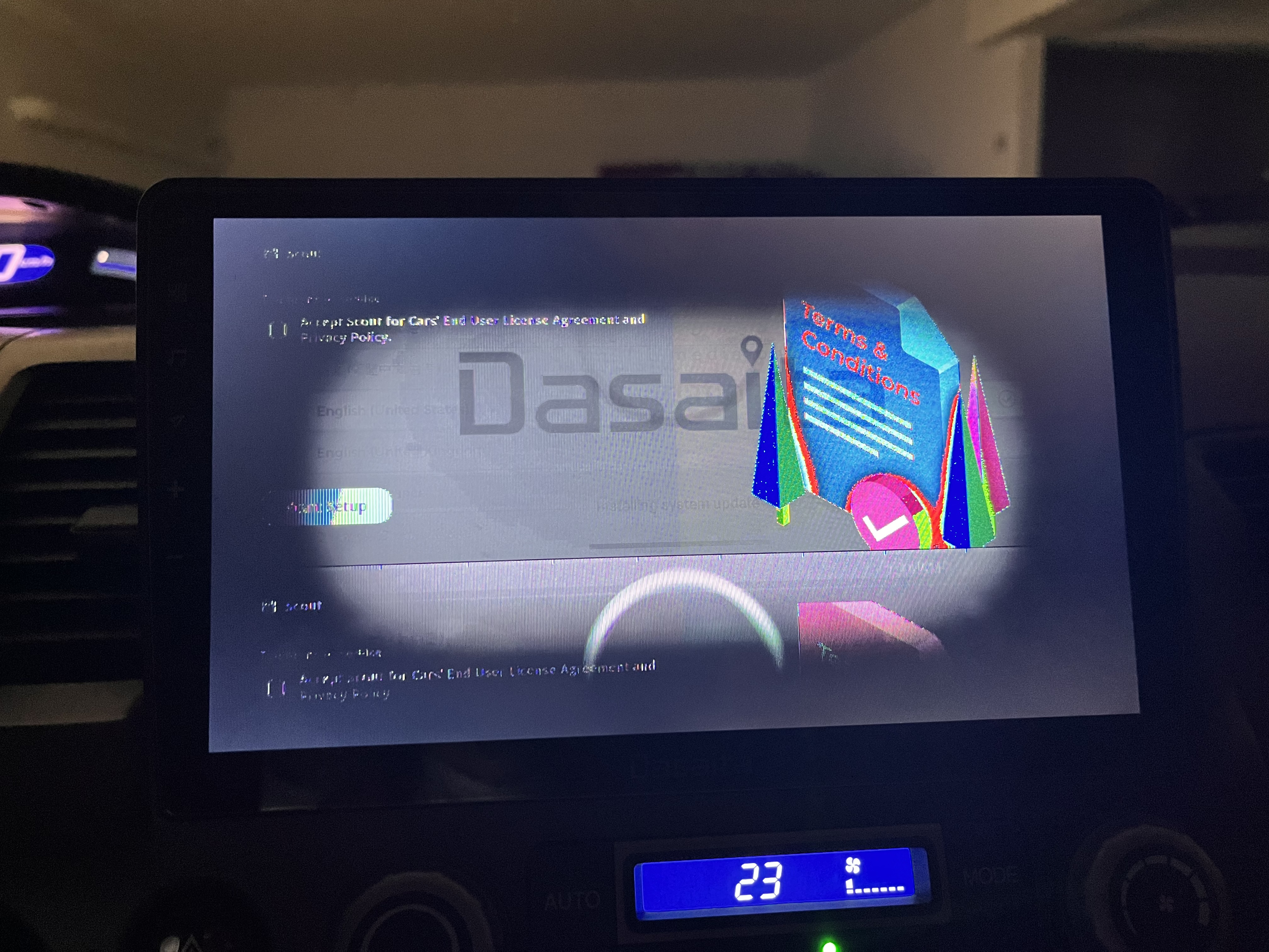

Unfortunetly the instalation of the firmware didn't went as expected and now my display is nonfunctional.
I leave here some picture with the current status and unit configuration with the hope that you can help me resseting it and make it functional.

picture taken before the instalation

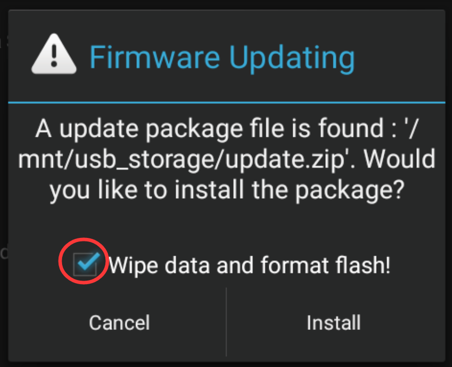

Regarding to your issue, we suggest that you can try to update the firmware firstly.
System Firmware-Vivid10-20250401:
https://www.dropbox.com/scl/fi/ffkmhx1eo7mibgg1pj04v/update.zip?rlkey=91a37rat2z5gwmzw1ildgpgc2&dl=0
Copy the file “update.zip” to the root directory of USB drive.
Alternatively, please manually go "Settings > System > System updates" to start the update.

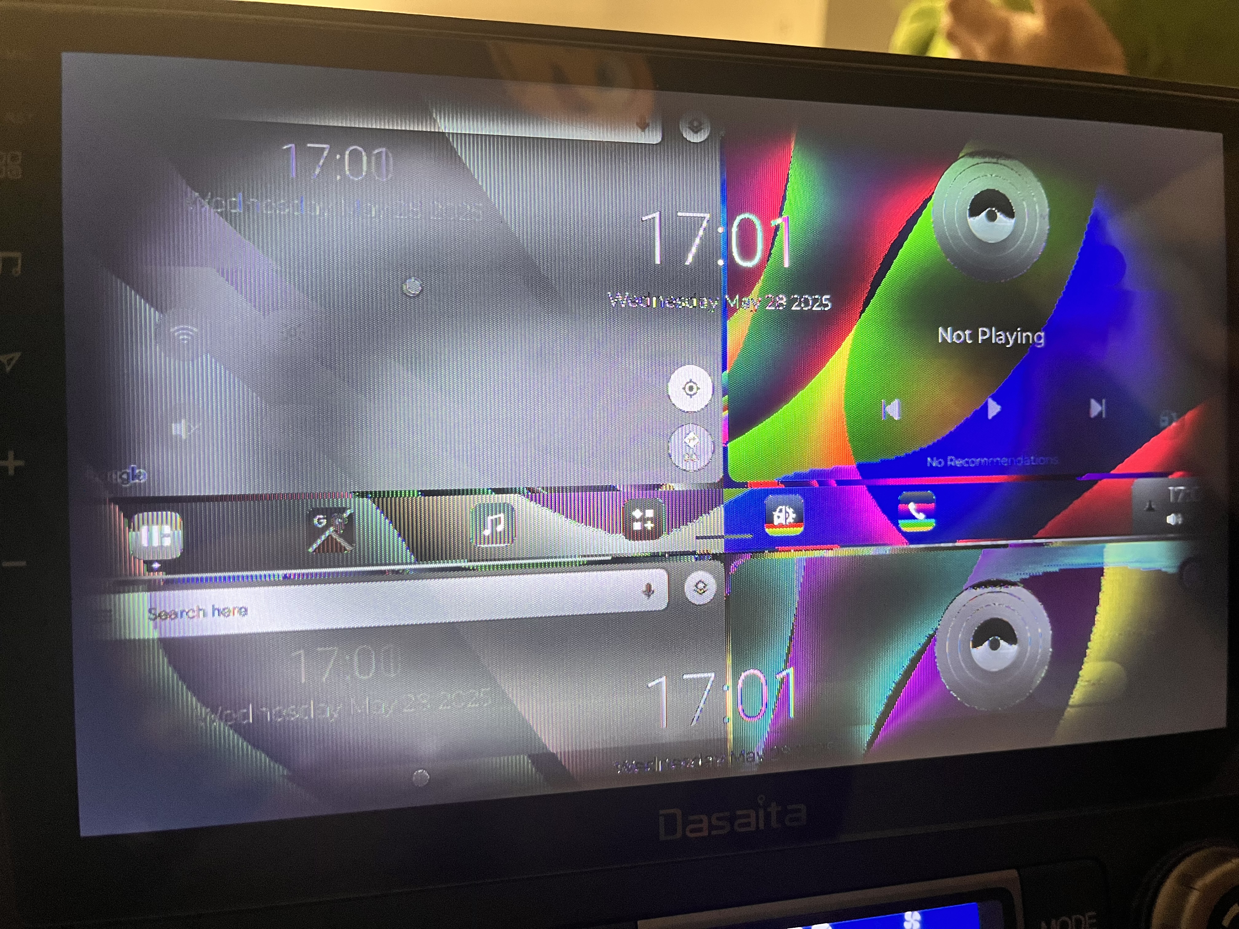

Dear @Support Dasaita ,
Unfortunetly "no luck".
I hope that the bellow picture can answer to your last question and you can provide me with further assistance.

Please try to upgrade the screen parameters.
https://www.dropbox.com/scl/fi/abwx9jbl54gzik4hjgl48/dmcu.ext?rlkey=syy83iyd25i5wl9n1b09tgzhf&dl=0
Download above file and copy it to the root directory of USB drive directly.
Make sure the file name is "dmcu.ext".
Power on the head unit, wait for the boot process to complete.
Insert USB drive into the head unit via USB cable and wait for a few minutes.
Power off the head unit and then reboot it.
@Support Dasaita ,
unfortunetly it didn't fix the screen parameters.
is there anything else I can try?
@Razvan Ionut
Regret to tell you there are no other options can be advised.
It most likely caused by the improper/unnecessary update.
In this case, it is difficult to fix.
