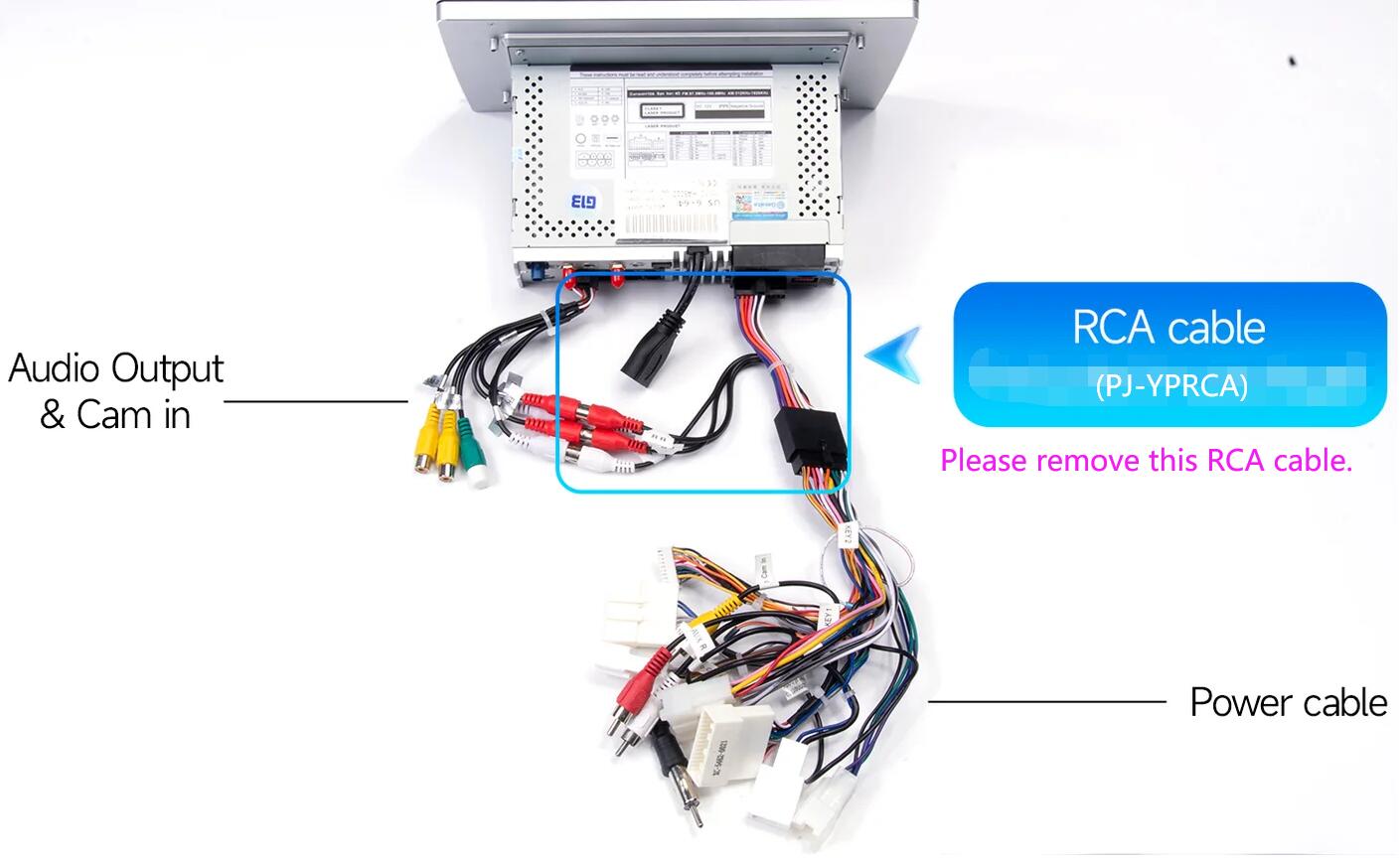

    We’ve noticed many recent reports about partial/full speaker no sound or low volume issues. After troubleshooting, we found that most cases are related to the RCA adapter (see attached image).
    Key Points:
    1️⃣ RCA Adapter Compatibility
    • This adapter is ONLY for cars with factory-installed amplifiers (e.g., JBL, Honda Premium Audio System).
    • If your car does not have a built-in amplifier, using this adapter may cause no sound, extremely low volume, or distorted output.
    2️⃣ Static Noise?
    • If you hear static, it might be a software issue.
    • DO NOT upgrade firmware/MCU yourself. Instead:
      • Go to Settings > About Machine and note the MCU Version & Build Number.
      • Contact our support team to verify if an update is needed.
    Recommendation:
    • If your car has no factory amp, remove the RCA adapter and connect speakers directly.
    • For further help, PM us or email support@dasaita.com with your order number and car model.
    Hope this helps! Let us know if you have questions.

  • I am having the same challenge with low volume, but your first post image does not specifically say which one is the adapter, can you please clarify?
  • @Fernando Martinez
    Please refer to attached pictures.

    If your car donsn't come with factory amp,please don't connect it.
    Thank you. I was able to get support from Tech team and sort thing out.  It works perfect now. Kudos to Support team!
