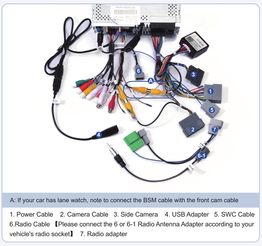

    • Ensure the Front cam wire is properly connected to the BSM wire.
    • HA5262
    • HA5206:

    About the aftermarket rear view camera, please refer to below photo.
    Please confirm that you have enabled the rear view camera and lane watch:
    Go Settings > Car > Factory setting (password :126) > Other > Reverse Detection > Enable;
    Go CanBus > Right View > Normal > Apply > Exit > Reboot.

  • @ivan lange If you want the side camear automaticaly show on screen,just turn on the setting:
    Settings>factory setting (Password: 126) > Canbus >Right view camera
    And also the side camera RCA connect to F-cam cable.
