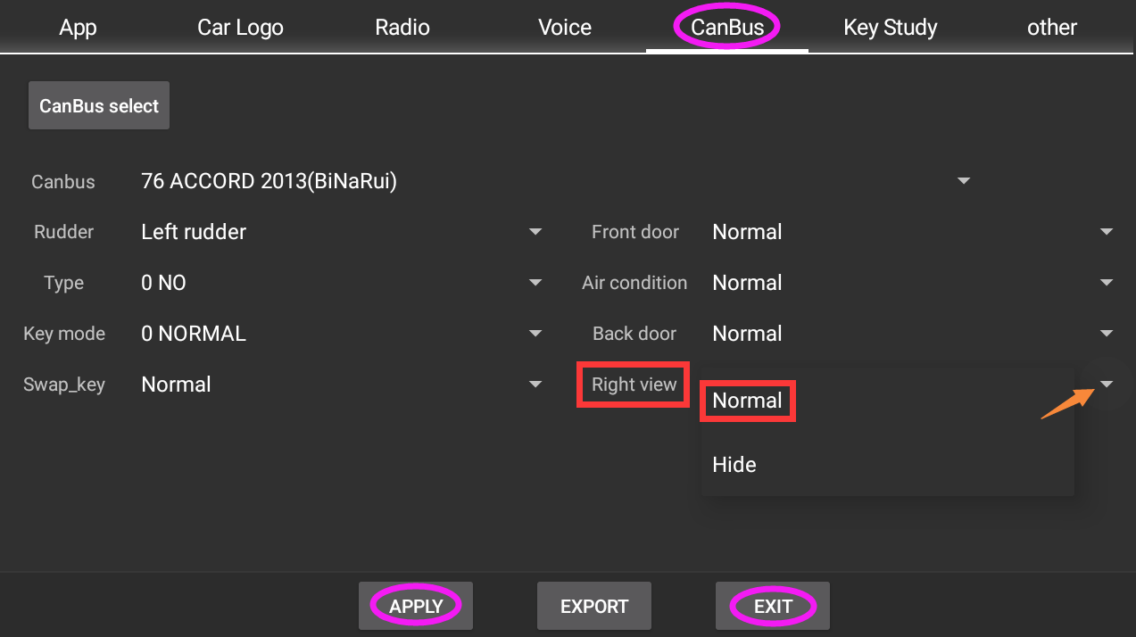

    • Enable Right View in Settings:
    • Go to: Settings > Car > Factory Settings (126) > Canbus → Enable "Right View".

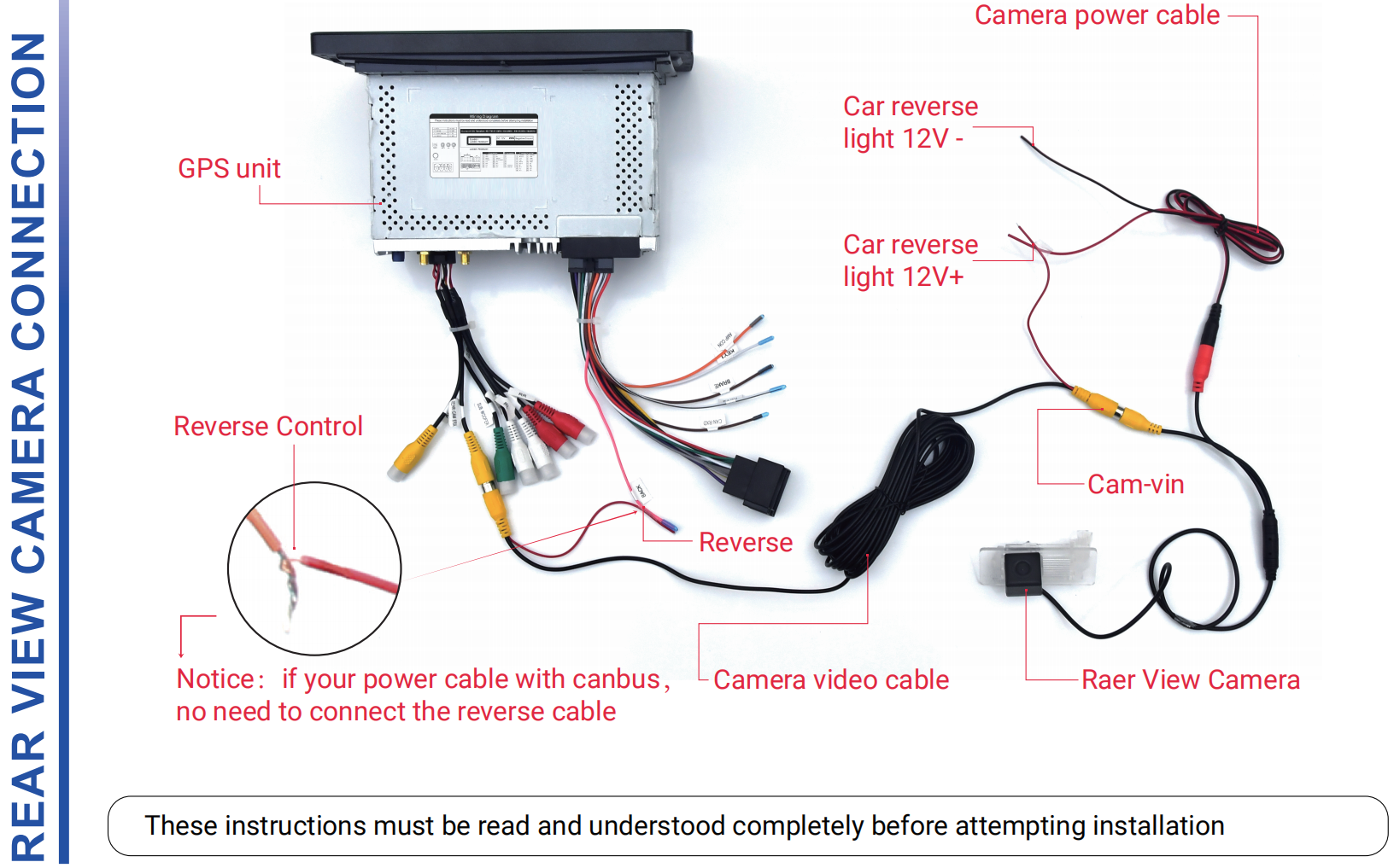

  • but my CB071 harness did not come with a BSM VIN. After installing the dasaita rear view camera, both rear camera and side view camera dont work, like at all. I have Cam Vin plugged into the daisata rear view camera i installed. I do have a front camera rca but i dont have anything plugged into it.
  • @ivan lange
    About the aftermarket rear view camera, please refer to below photo.

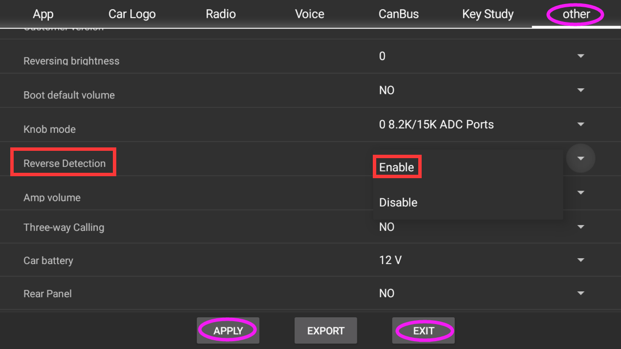

    Please confirm that you have enabled the rear view camera and lane watch:
    Go Settings > Car > Factory setting (password :126) > Other > Reverse Detection > Enable;
    Go CanBus > Right View > Normal > Apply > Exit > Reboot.
