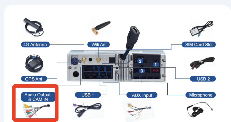

  • Please email or provide a link for installation instructions for connecting an amplifier to the headunit. I lost the wiring diagrams/ manual. - sound is red/white? and remote power on/off the amp?

    For the aftermarket amp ,here are the connection for reference:
    Please note that the harness comes with 4 Audio Outputs(the red and white plugs on the RCA cable) and please give them a try.
    Also please make sure the amplifier control cable is connected to Dasaita  unit’s AMP control cable. Please find the attached circuit diagram of the 20-pin power cable and check if there's a wire labeled "AMP“
