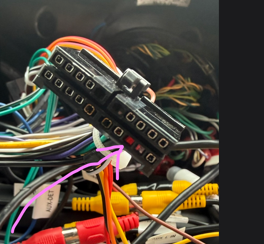

1.Audio Line Connection:
1)For connecting the audio lines of your subwoofer, you only need to use two out of the following: RR (Rear Right), RL (Rear Left), FR (Front Right), and FL (Front Left).
2)Do not connect the subwoofer line directly.
2.AMP Line Connection:
1)Locate the amp line and carefully strip a small section of the insulation.
2)Connect this stripped portion to the command line of your amplifier to ensure proper signal transmission.
