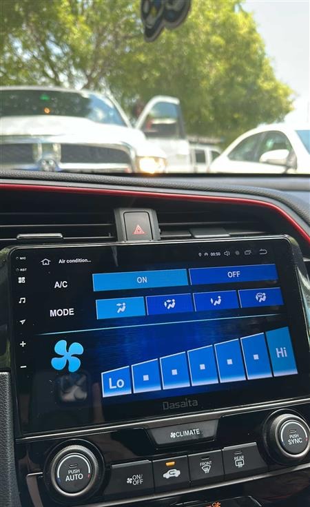

Hey guys , not sure if anyone else has had this issue but I just installed a new head unit and the A/c control screen pops up but when I press it on the screen it doesn't do anything.
I can't change the fan speed etc no matter how much I touch the screen

so the a/c control screen works intermitenly and what i mean by that is when i press the climate button the screen to adjust the A/C comes out but no matter what i press nothing can be adjustedand my a/c is stuck on the highest fan speed

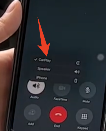

CarPlay phone calls have no audio I can't hear them and the other person can't hear me.
@Support Dasaita I tried switching to car play for calls on the phone and still no audio

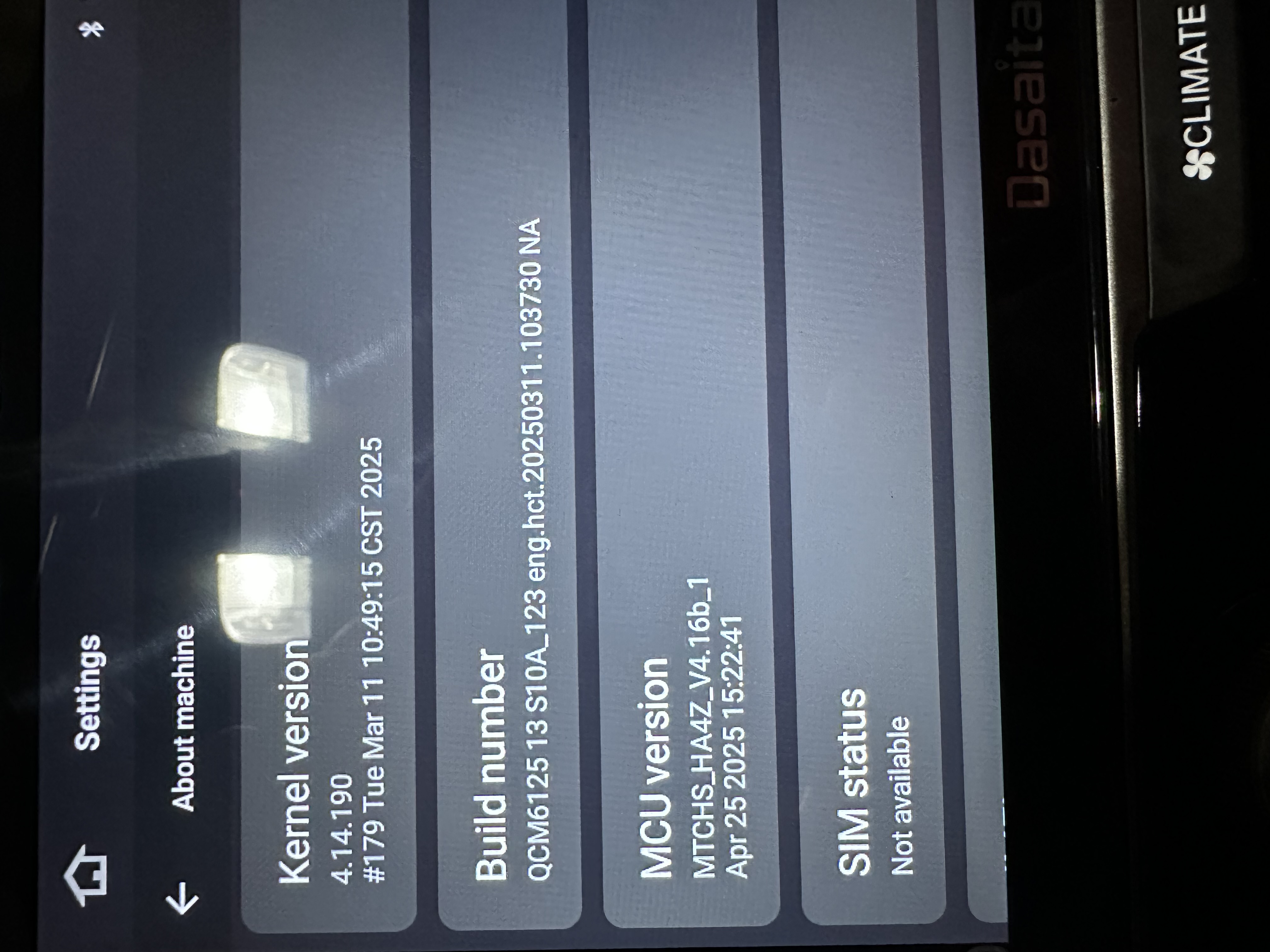

here Is the information requested
@Jonathan Albisu
Usually the built-in microphone is good enough for phoning calls, but we also included an external microphone just in case.
How is the volume for the bluetooth calls?
G13(20250620)
https://www.dropbox.com/scl/fi/jstacxfz4l9svgsjchmnr/update.zip?rlkey=hacqwnttcyb7wn7uoostpzwtv&dl=0
②4.16e:
https://www.dropbox.com/scl/fi/dxj9tjs9pnzv9actri0g9/hmcu.img?rlkey=g5hk0gsmuhaxqolypqf28occ8&dl=0
