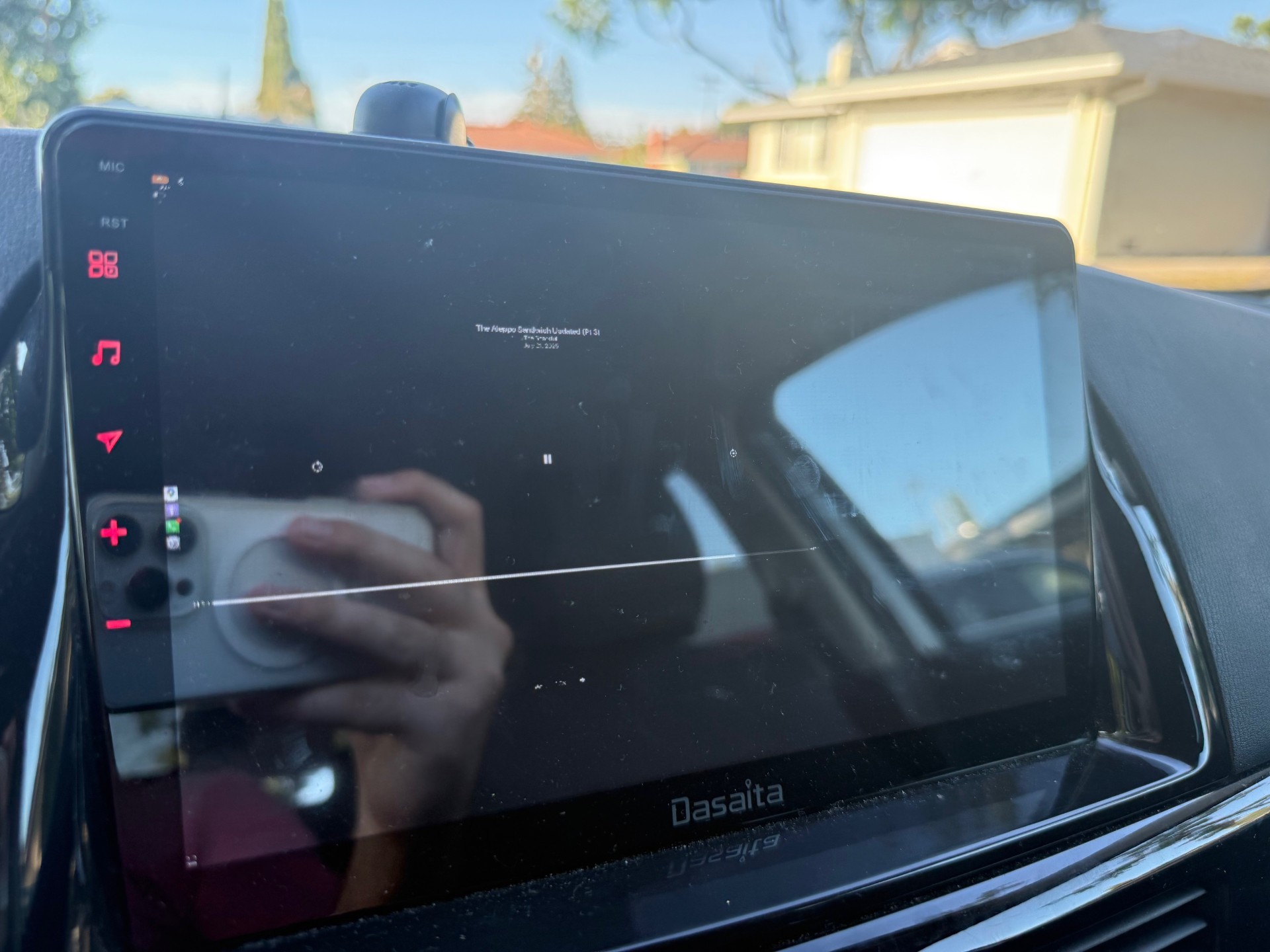

Hi I am having an issue with my unit it was working well for some time, but now it seems to have a weird bug as the resolution seems very off (very small icons). According to the firmware links I should download, but I think I need a newer version of Zlink. The forums seem to imply updating to version 6 is best. Please advise and thank you very much.
My car is running:
PX6 - 4GB (1024x600)
Android 10 - Kernel 4.19.111+
Zlink - 3.5.57
HA3_rk3399_10.0_ota(20230803)
https://www.dropbox.com/scl/fi/sy068zz4tgokutkfhuwkt/update.zip?rlkey=uuhukuun3882rz4cyqxsgs9k6&dl=0
I have the same issue too 😭. Can't find any solution. And even can't return to IOS 18 as I haven't backed up.
OK that's actually great news because hopefully this will be a known issue and we can get some attention for a work around. Can anyone confirm working combination of iOS26 and Zlink versions?
Similar issue. My phone connects to CarPlay, but Zlink sticks on the "Connecting" screen and never loads the CarPlay screen. So no mini icons for me. No CarPlay screen whatsoever. My Zlink version is 4.0.41.12. CarPlay was working fine until IOS 26 Beta update to my phone.
When you are connected in carplay you need to press the Settings> Display>Smart display zoom(disable)
@Andy Swag Same issue stuck at "Connecting" screen, was able to fix by factory reset of Dasaita machine. But now stuck on the same small icon issue with IOS 26.
