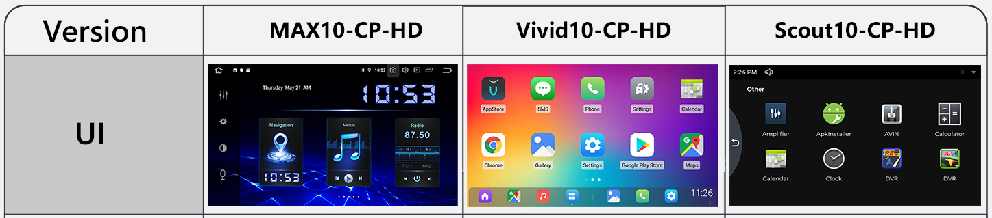

    Please tell us your UI(MAX/ Vivid/ Scout).

    The interface used is Vivid .
