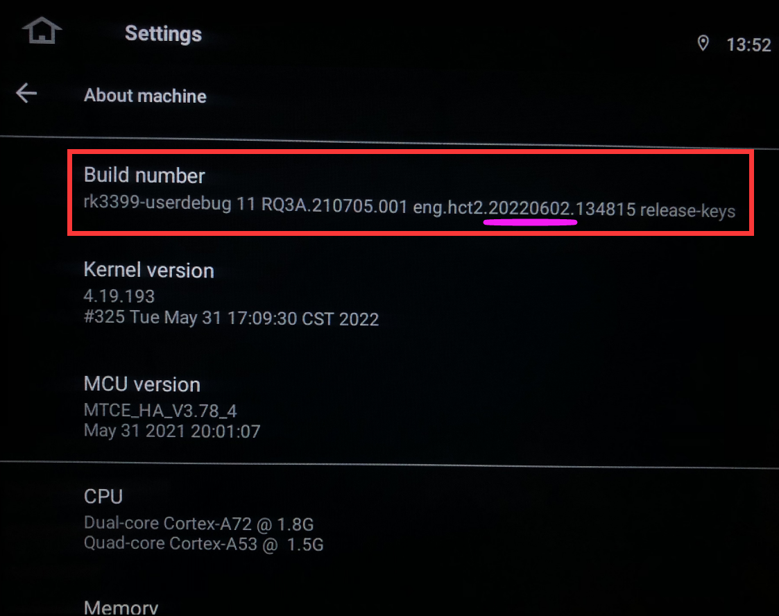

In order to help you better, please send the Build Number picture to our email.
βοΈEmail: team@dasaita.com
Settings > About Machine > Build Number
@Support Dasaita it wont let me upload photos for some reason
here is the build number - rk3399-userdebug 10 QQ2A.200305.004.A1 eng.hct.20210111.104138 test-keys
@Brandon Contreras
System Firmware-MAX10-20230302:
https://www.dropbox.com/scl/fi/mwzw2q4ojdfoz3mnp0i08/update.zip?rlkey=np70fog84q4mmy903xsofdz13&st=znaujgwo&dl=0
