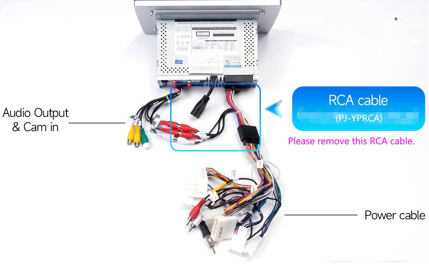

    Thanks for your message.
    We'd like to know if you connected the RCA adapter cable.
    If YES, please remove it to see how it goes firstly.
  • I disconnected them and got no noise out of them. What should i do next?
    i updated system to lastest version and still sounds very low
    if the RCA cable is disconnected there's no sound, once connected you can hear the music but it comes out at 65 decibels which compared to the stock one is much lower
