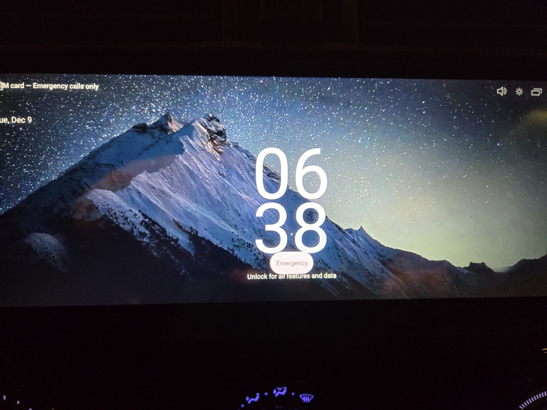

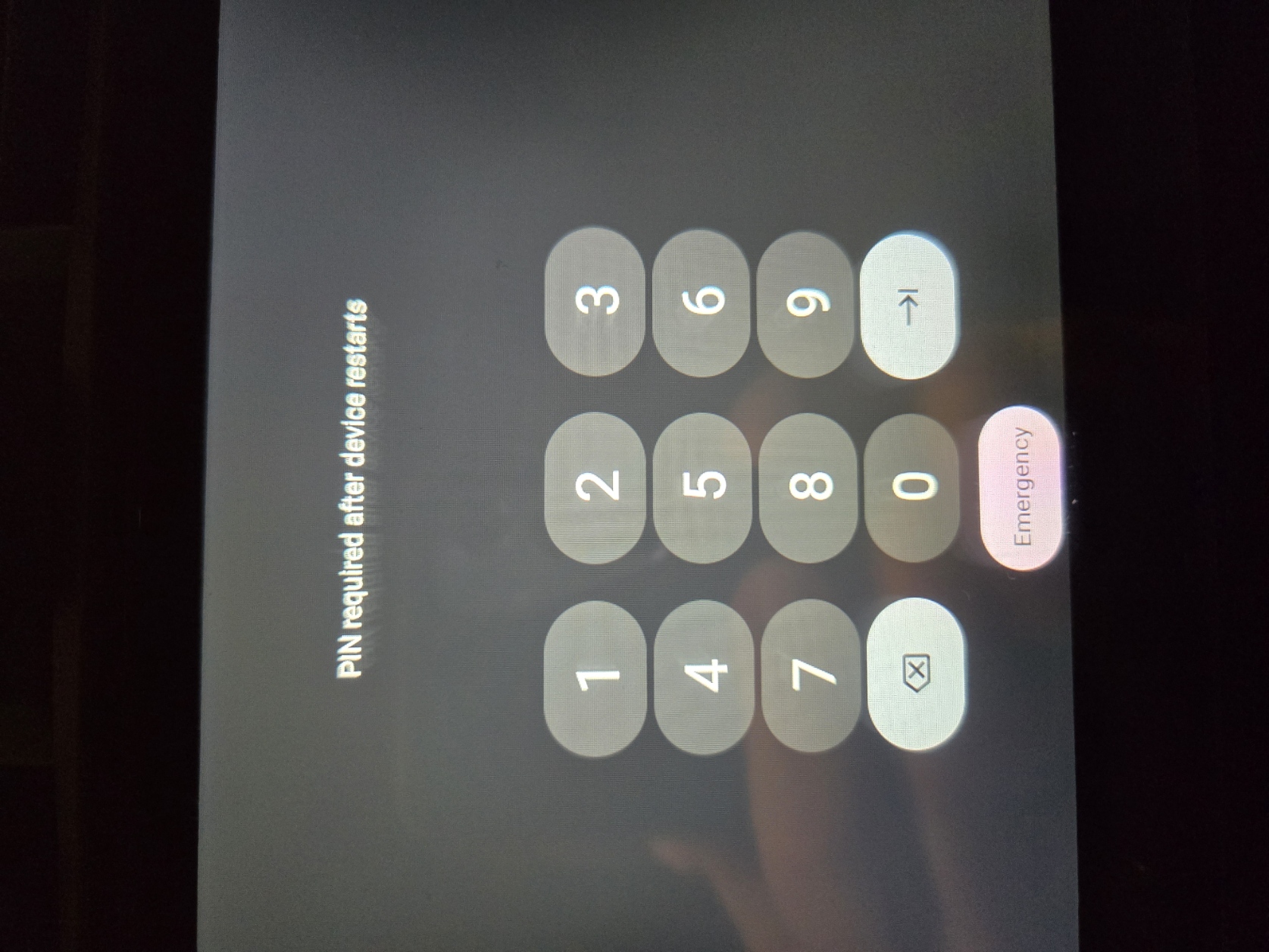

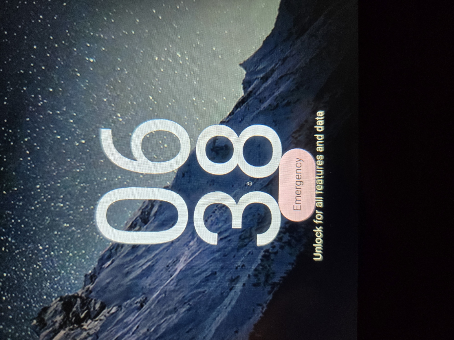

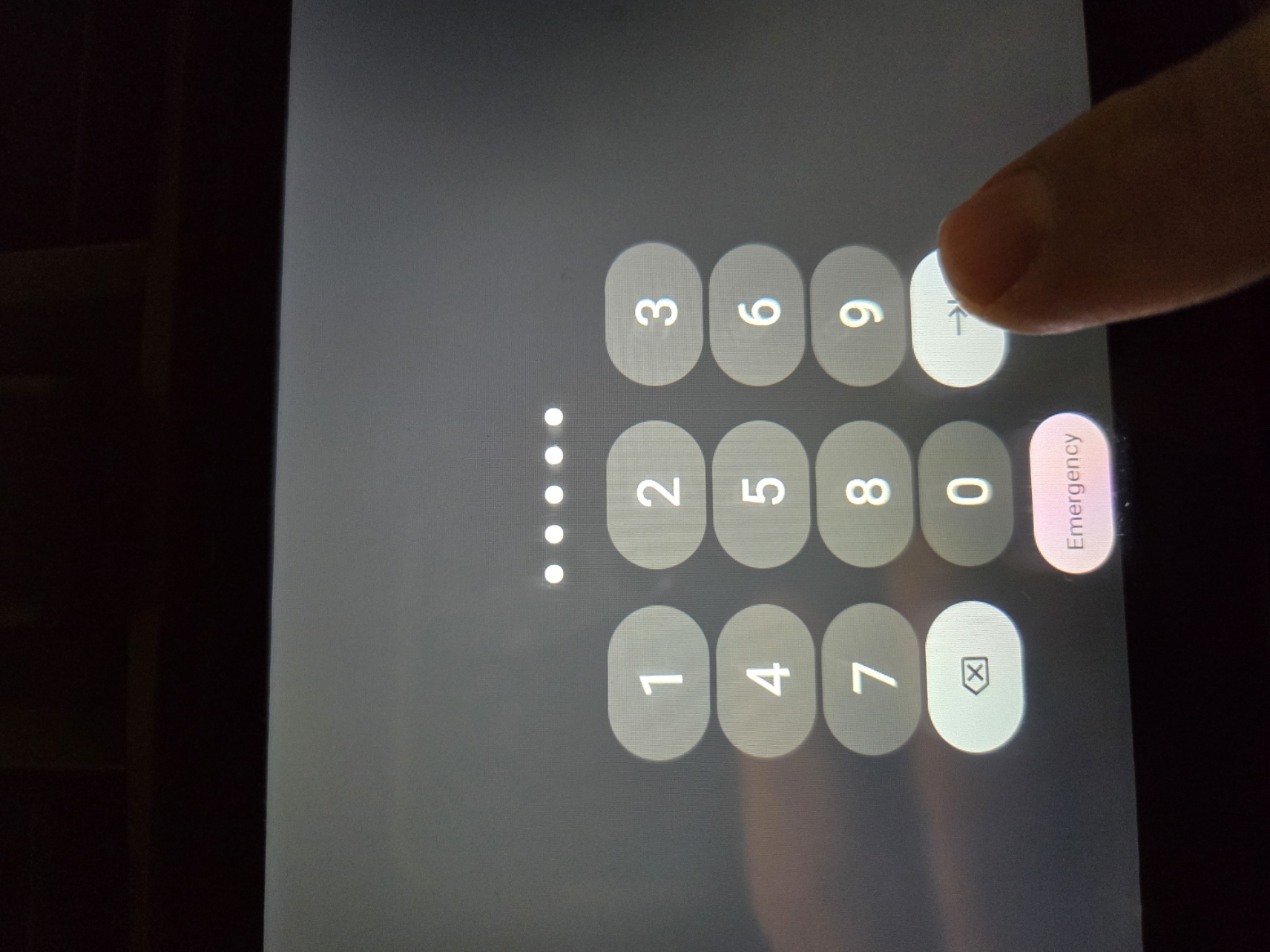

  • I have a 2019 4Runner with the Android G13 Dasaita Head Unit.  I have accidentally enabled a pin code on startup/boot up and want to disable it but cannot find the menu to disable it or changed the pin code.  Now everytime I turn on my vehicle, I have to enter a pin code and this is an unwanted extra step to get into my Dasaita unit.  Please advise and help.
  • try removing your Google account, and then add it again
  • Thanks for the reply, but unfortunetly it did not work.  I think I may need to do a factory reset if I can't disable this feature.  There is a menu for it somewhere because I was in it when I set up the pin code, but now I can't find it.  Hopefully, another person has dealt with this issue or hopefully, Dasaita will have a solution.
  • @Mochi Kiwi Thank you for the suggestion.
  • @Support Dasaita Thank you!  That worked (the factory reset)!  There is no more PIN being requested when the unit starts up.  So far everything appears to be working after the factory reset.
