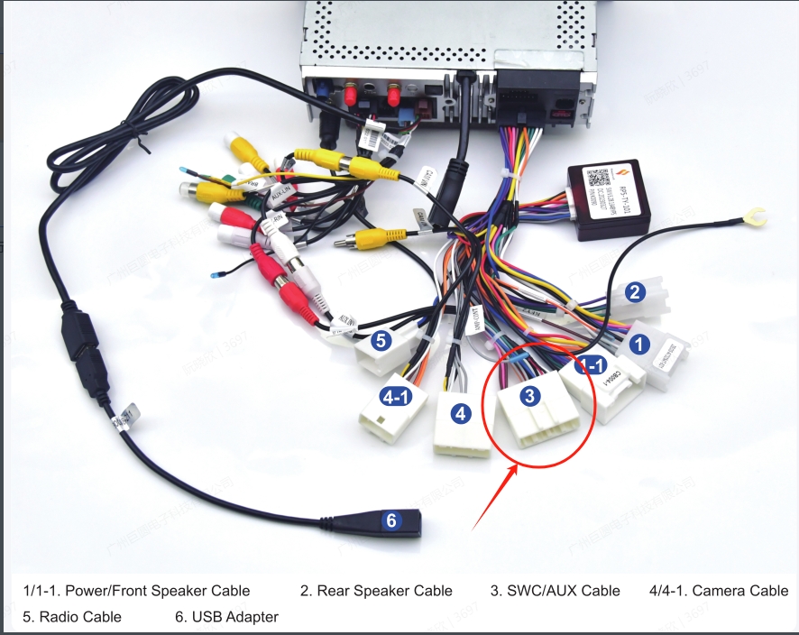

    I was curious if you could provide the pinout for the CB004-1 harness. Does it wire all 28 pins of the Toyota connector as pass through or only select wires?
  • @Mike Carbary Please let us know if you mean the No.3 connector.
