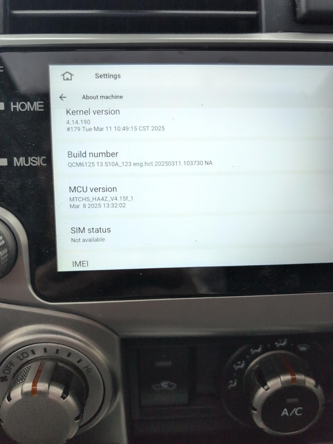

  • I have a Dasaita G13 installed in a 2010 Toyota 4Runner.
    Model: QCM6125
    Android: 13
    Build: QCM6125 13 S10A_123 eng.hct.20250311.103730 NA
    MCU: MTCHS_HA4Z_V4.15f_1
    My reverse camera works, but the screen shows the vehicle/radar graphic on the left and the camera image on the right. I would like the reverse camera to display full screen.
    Please confirm whether my unit is G13 V1 and provide the correct firmware and MCU update files for this specific unit.
