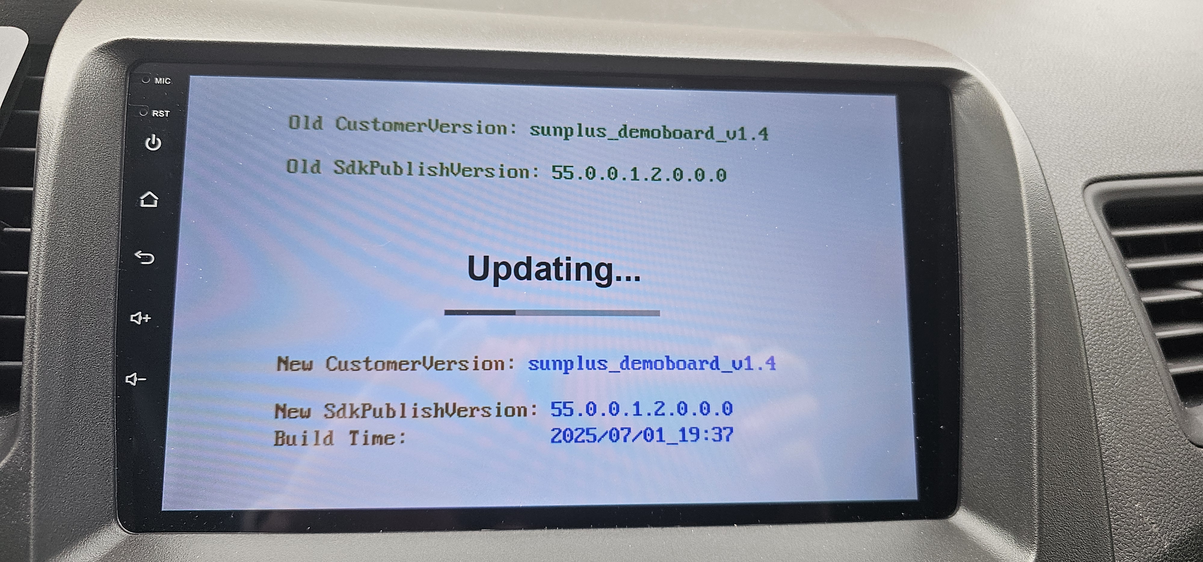

  • @Support Dasaita hi, called your support team and they suggested a firmware update. Can you provide a link? Current firmware
  • @Mittens
    https://www.dropbox.com/scl/fi/q3g8g4qxx9di02k4f3ggm/HS2901-9-UI05-MIPI-WD090HBM30AC_S0_80-YL_01-WiFi-D-play-CP-Dasaita-MIC-2025.7.1.zip?rlkey=5if3v4br00yx1ifi748cty6ji&dl=0
    1.Unzip the file and then copy the "ISPBOOOT.BIN" update file onto a USB drive that has been formatted to the FAT32.
    2.Insert the USB drive into the head unit, and it will prompt "Update via USB".
    3.Click "OK" to proceed with the update.
  • @Support Dasaita  looks like the update was already installed from factory  so no difference in firmware. Also didnt resolve the issue
     Still no sound during phone calls thru unit.
