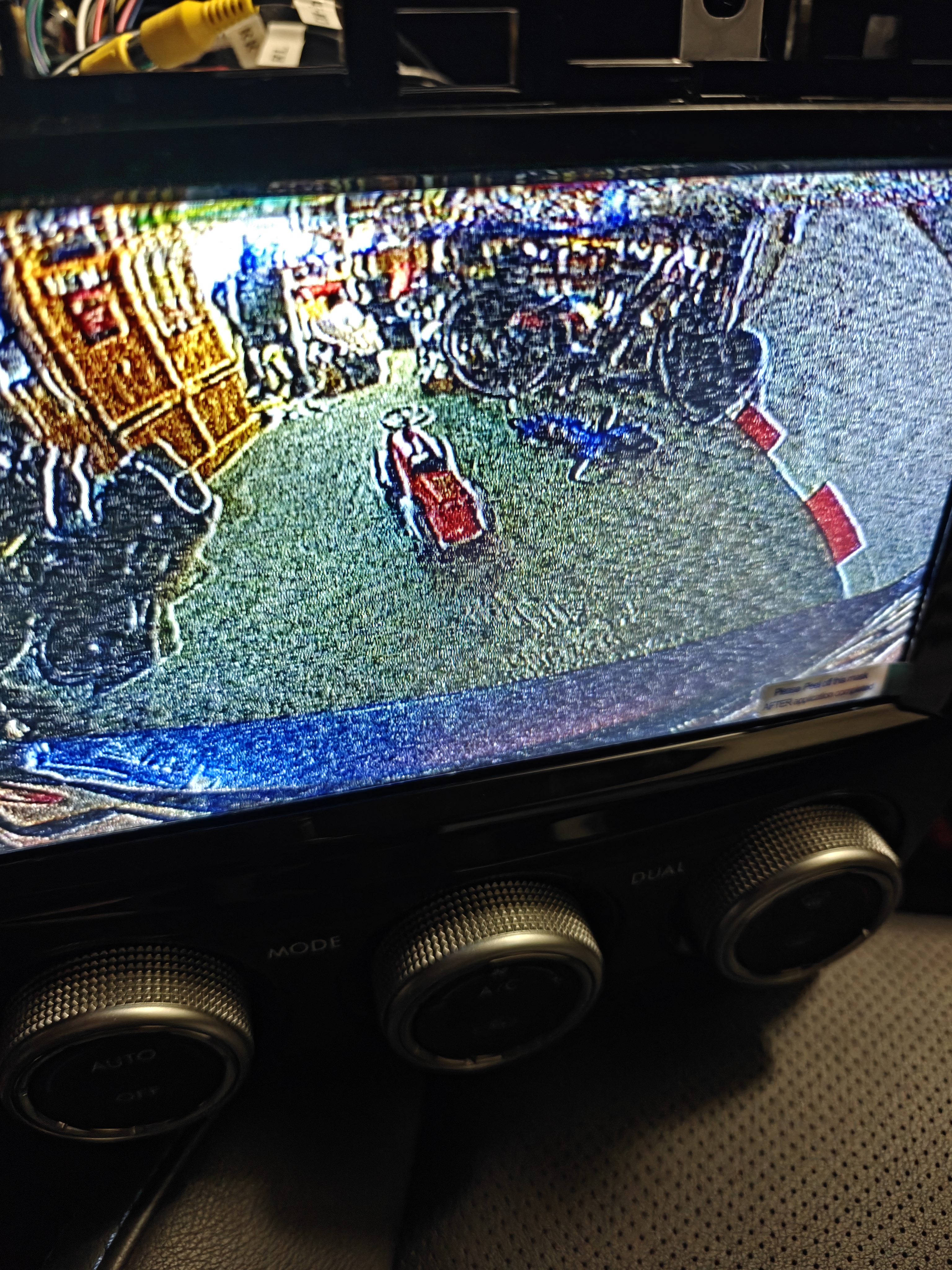

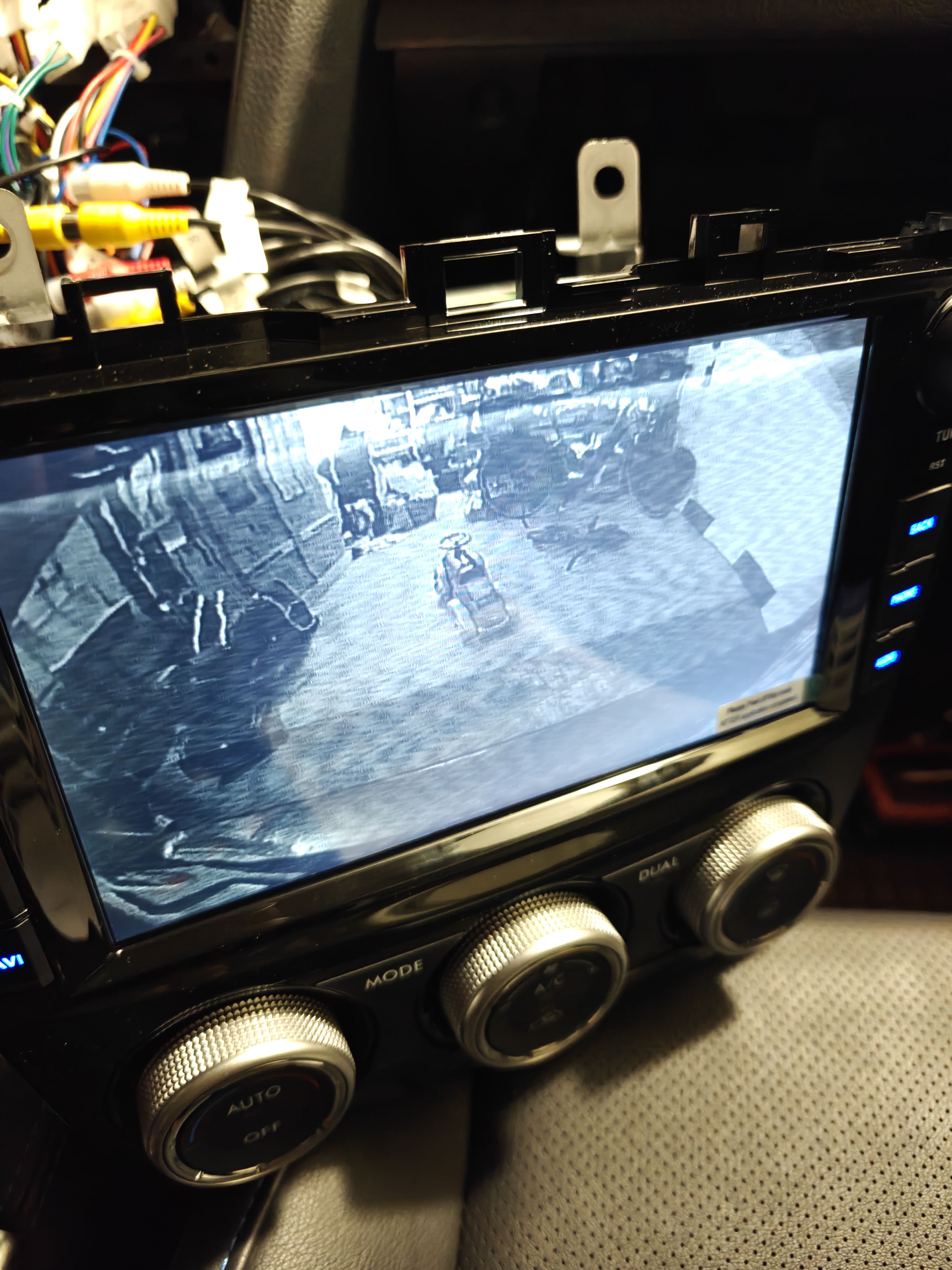

The Backup Camera is very grainy and flickering, sometimes its just in gray scale
Any idea what could be causing this?

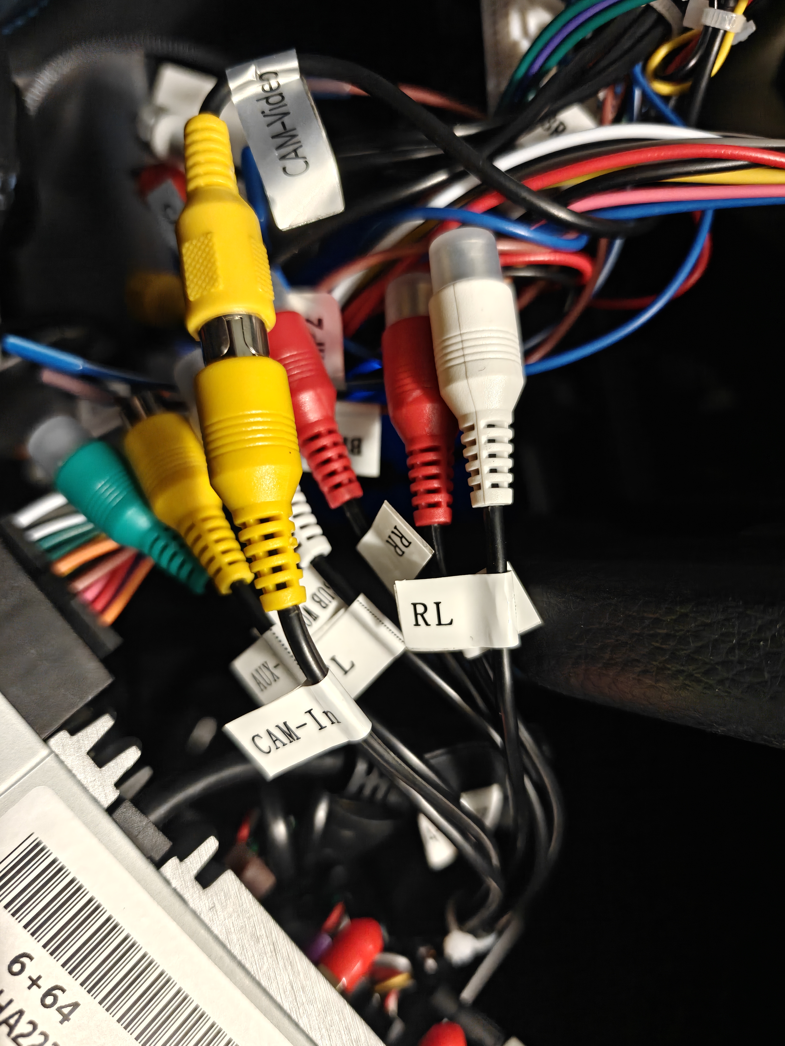

It seems to be a poor connection.
Please connect the yellow camera cable properly.
Please check also check if the GND trigger wire bent .
