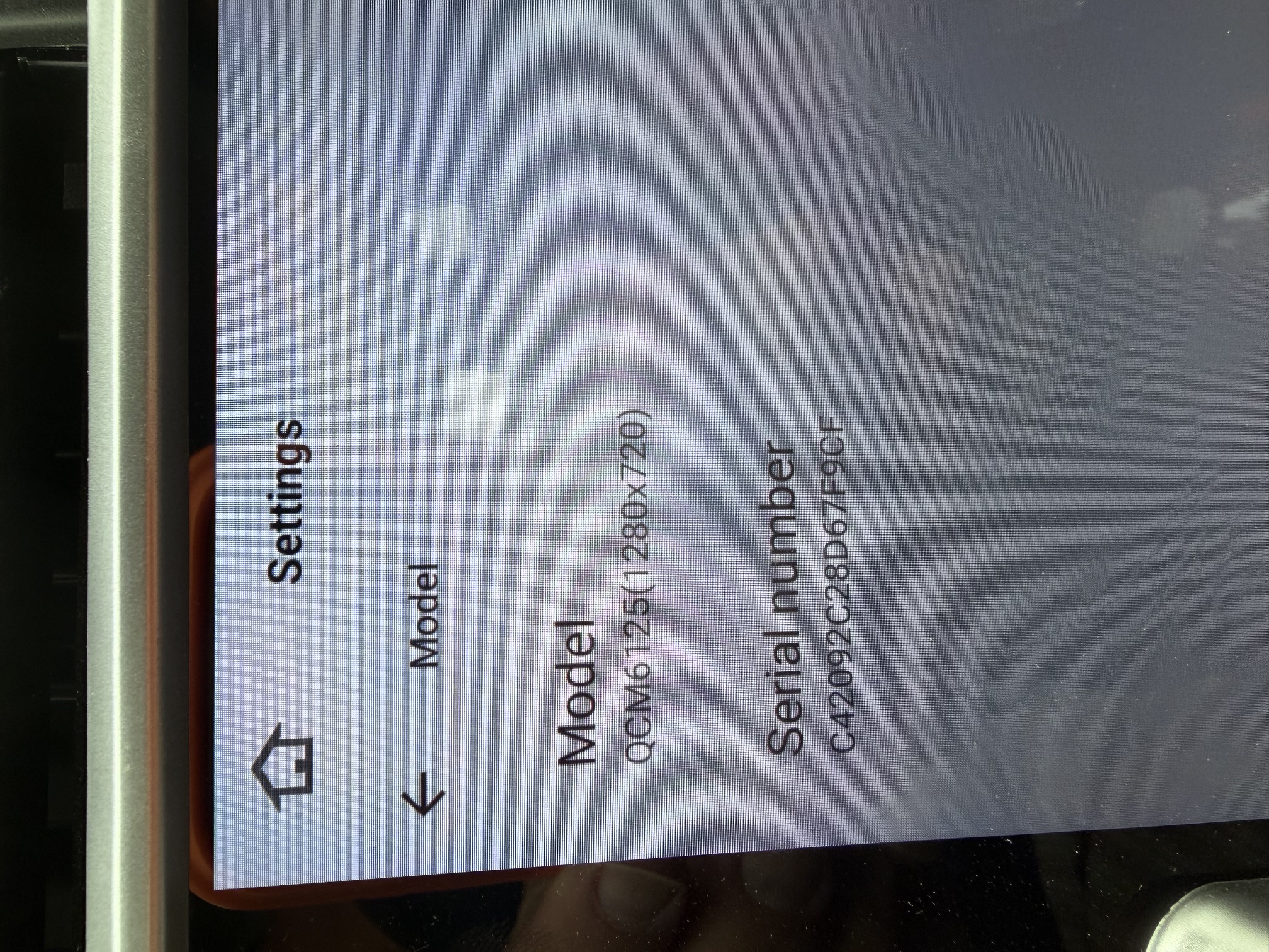

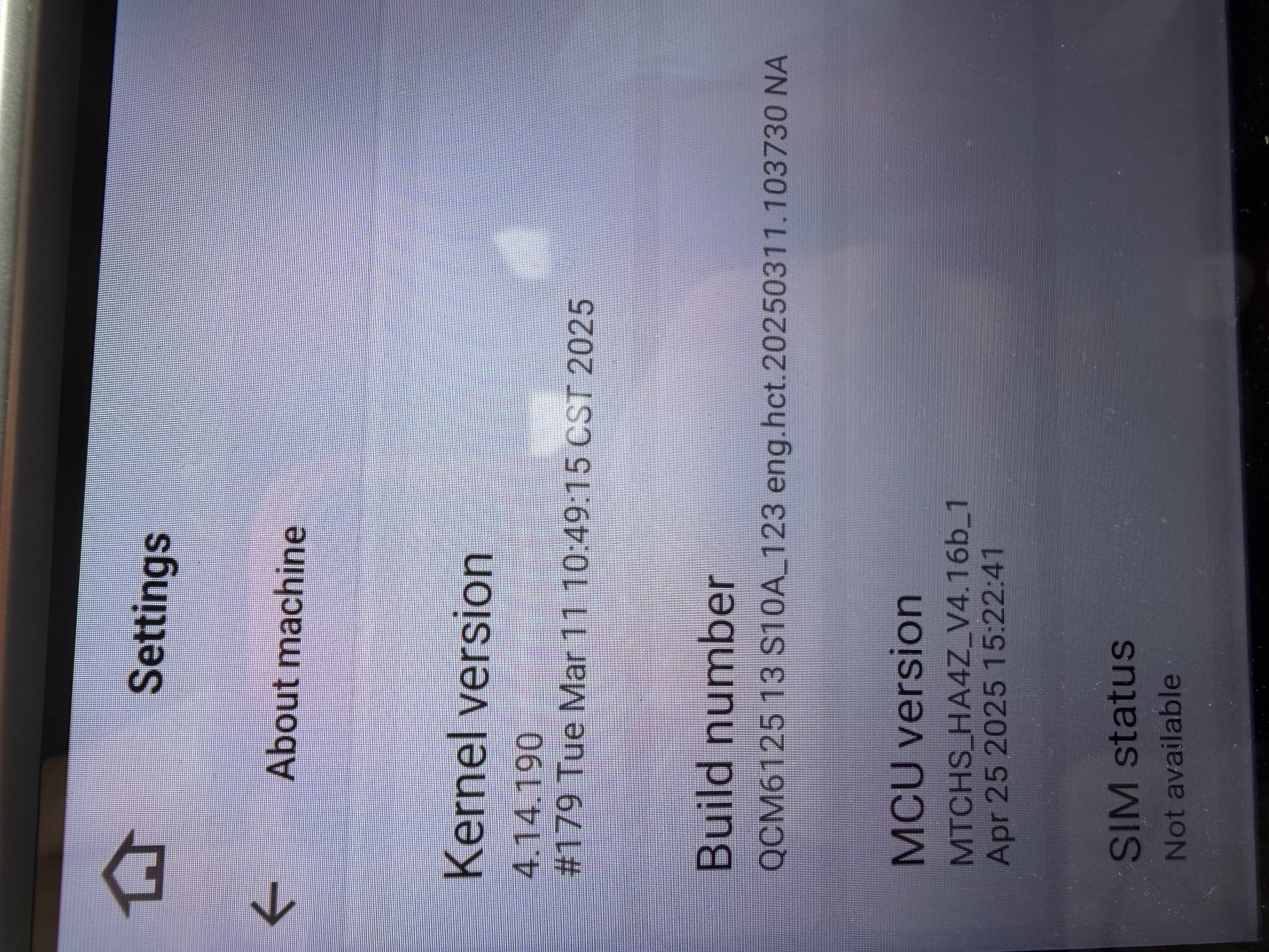

I've had this unit for about a month but the microphone is terrible, the sound quality is bad on the other end of the call. Is there a fix for this?
@MICHAEL G
Dear customer,
Please update the Firmware & MCU to the latest version via the link below, here are some tips to help you get it done:
①G13-V1 Version(20251212) :
Make Sure your unit is QCM6125 Android 13
https://www.dropbox.com/scl/fi/8tyv8vwl02ul1764c0amo/update.zip?rlkey=k07yadgzhm9y3nkd0swnwhf2o&dl=0
②MCU(4.17a)
Thank you for your time and cooperation in advance
