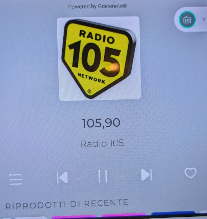

Hi, I'm using my px6 vivid11 unit on Toyota c-hr my2018 Italy.
I see that some radio stations have wrong logo shown.
I'm using stock radio app.
How can I force a refresh?
@Mcgyver83 Hi ,
May i have a pic of showing that issue?
As you can see here. Radio 105 is a radio.station but 105.90 FM is not the correct frequency in my area (I suppose that it's not a frequency associated to this network at all)
In my area. 98,90 and 99.10 is the correct frequency for this network.
