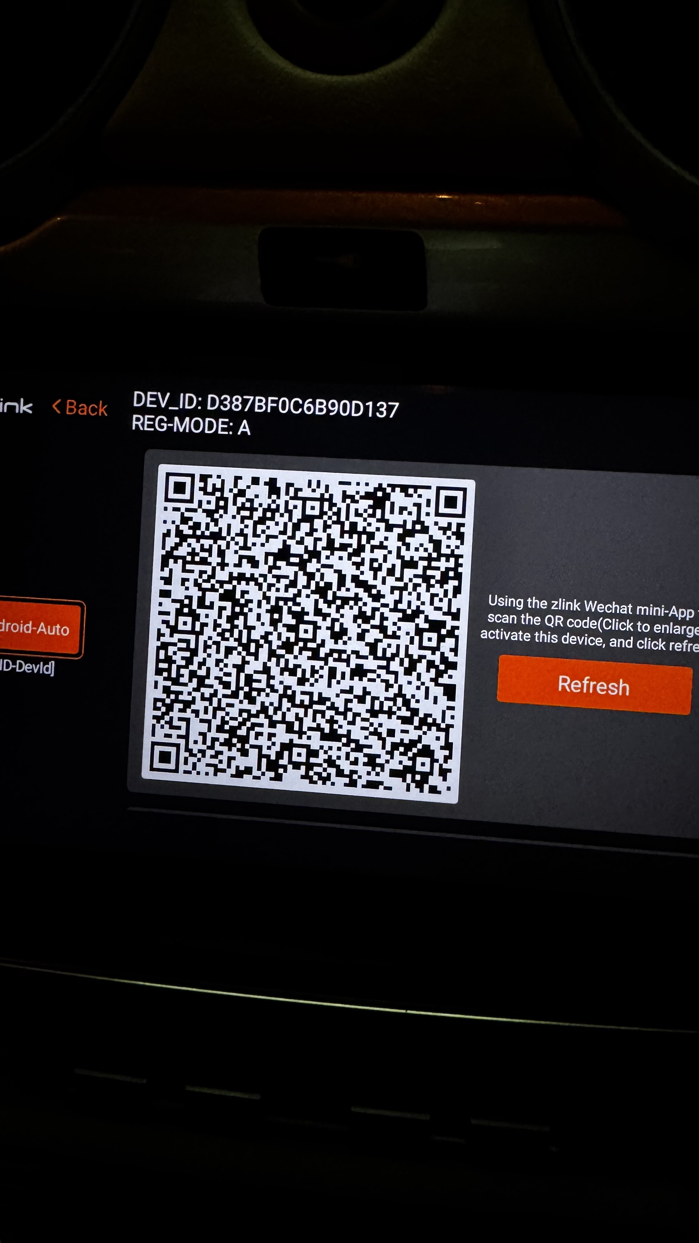

I bought a dasaita PX5 for Qashqai in 2020. I tried with several rom official android 9 and next hal9k android 10 it's the same problem.
i take photos tomorrow to show you the message on screen
@snoophill Jean please take the photos and if you can..a video showing this.
Sorry for the bad quality!
@snoophill Jean your problem is not an activation problem...but a hardware issue...zlink is not recognizing your unit to have a valid hardware.
Are you sure that your px5 was sold with carplay/android auto support?
Where did you purchase that unit?
Ah ok, I think about this problem... I bought on aliexpress on the dasaita official store.
But i don't remenber if when i buy the product it was with zlink..

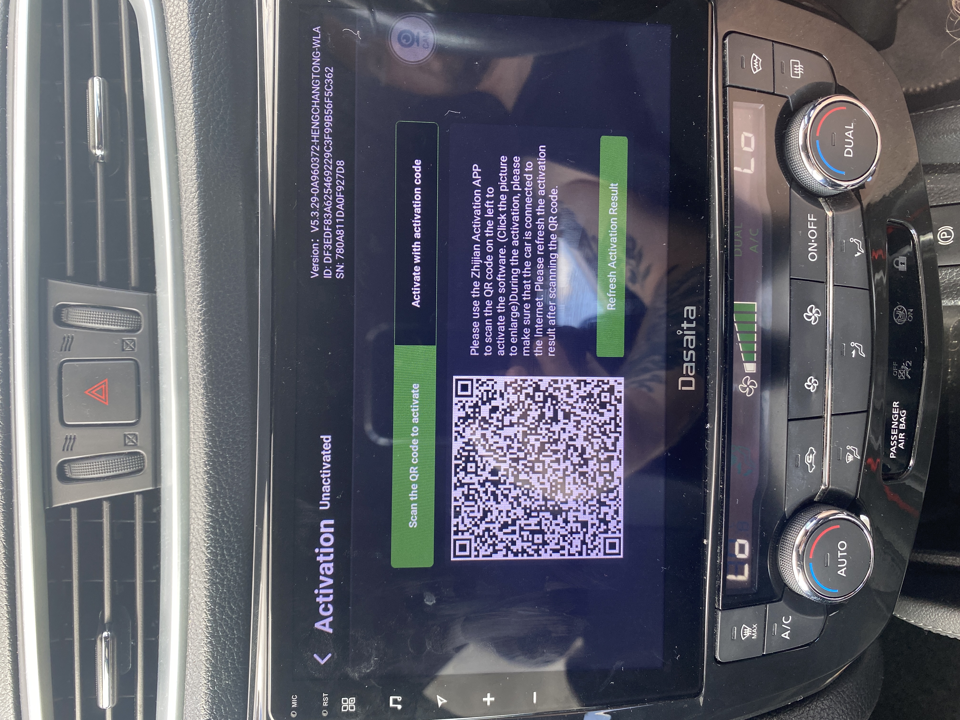

I have the same problem, ZLink won't activate after firmware upgrade. Is there an activation code that can be manually entered?
I'm having the same problem cannot activate after update.
i have accidentally deactivated it could you help me?
@Lucas Tobey
Hello. We'd like to know if you has Dasaita head unit. Based on your picture, we notice that your Zlink is not our brand built-in version. Therefore, we are unable to help you to activate it.
