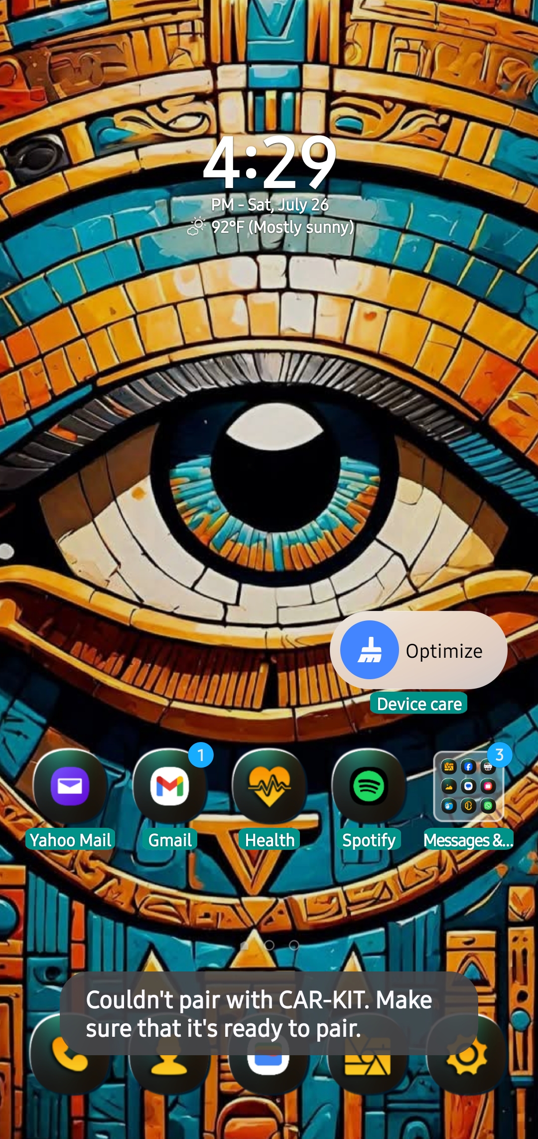

  • Hi 👋🏻.  I upgraded my phone from Samsung Galaxy S25 Ultra to Samsung Galaxy fold 7.
    With the S25, no connection problems.
    Now, with the Fold, there's no connection. I reset the Bluetooth, Wi-Fi and nothing. On my phone, when I try to connect to the Dasaita, when the screen shows up to put the pin number, just flash, doesn't let me try.
    Any help will be greatly appreciated 👏🏻.
  • @Jovan Mercado
    Thank you for your contact.
    Please refer to this link to have a try :
    https://www.dasaita.com/community/forum/topic/174087/how-to-fix-wireless-android-auto-connection-issues
