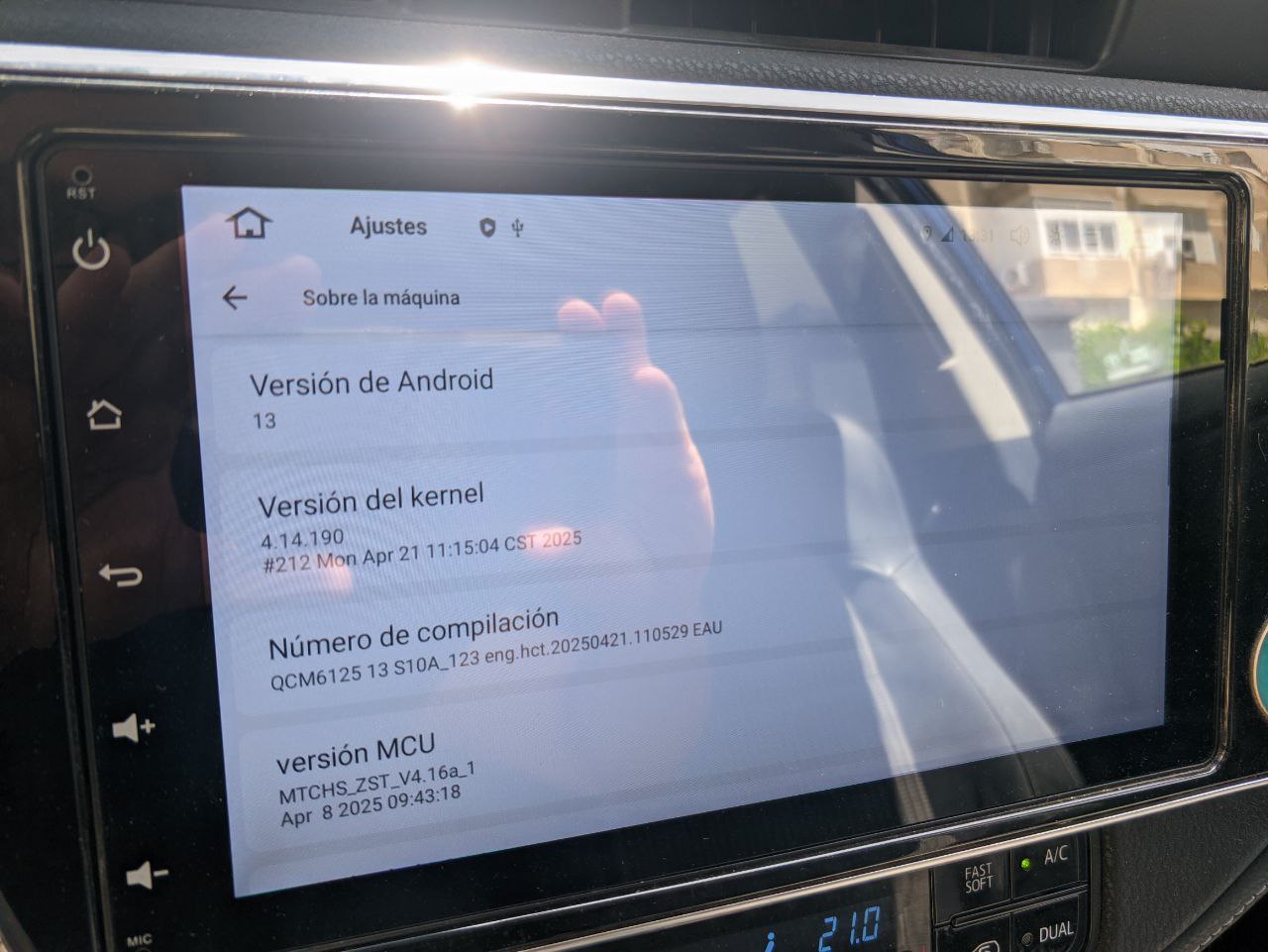

    To further confirm,please go Settings > About Machine, then provide the following picture: Build Number; MCU version.
  • I provided you with this photo some time ago by email. It is the same unit but with the latest firmware zst27_sc138_13_(20250311) and MCU 4.16a. It is the unit of order SP-DA5676. The problem occurs since I bought the unit, which came with the firmware prior to the one in the picture, I think September 2024.
  • @JoMaRS
    For further confirmation, please reprovide us with the current Build Number&MCU version photo.
  • @Support Dasaita Good thing you guys insisted 😅. The firmware version finally was that of 04/21/2025. I attach the picture.
