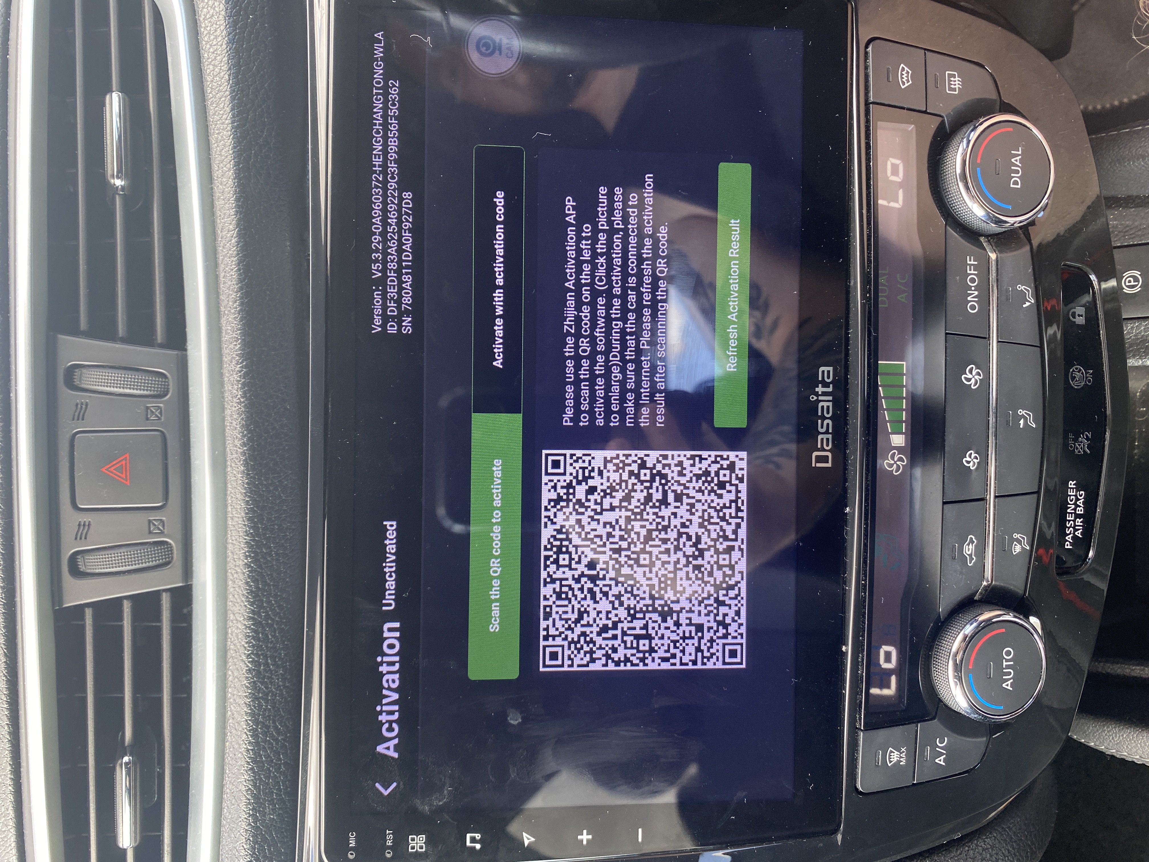

I was having some disconnection issues with android auto so I cleared data and cashe in zlink app. Now zlink app is deactivated. It is asking me to connect to internet, though I am connected. I tried different networks, rebooted the unit but nothing worked.

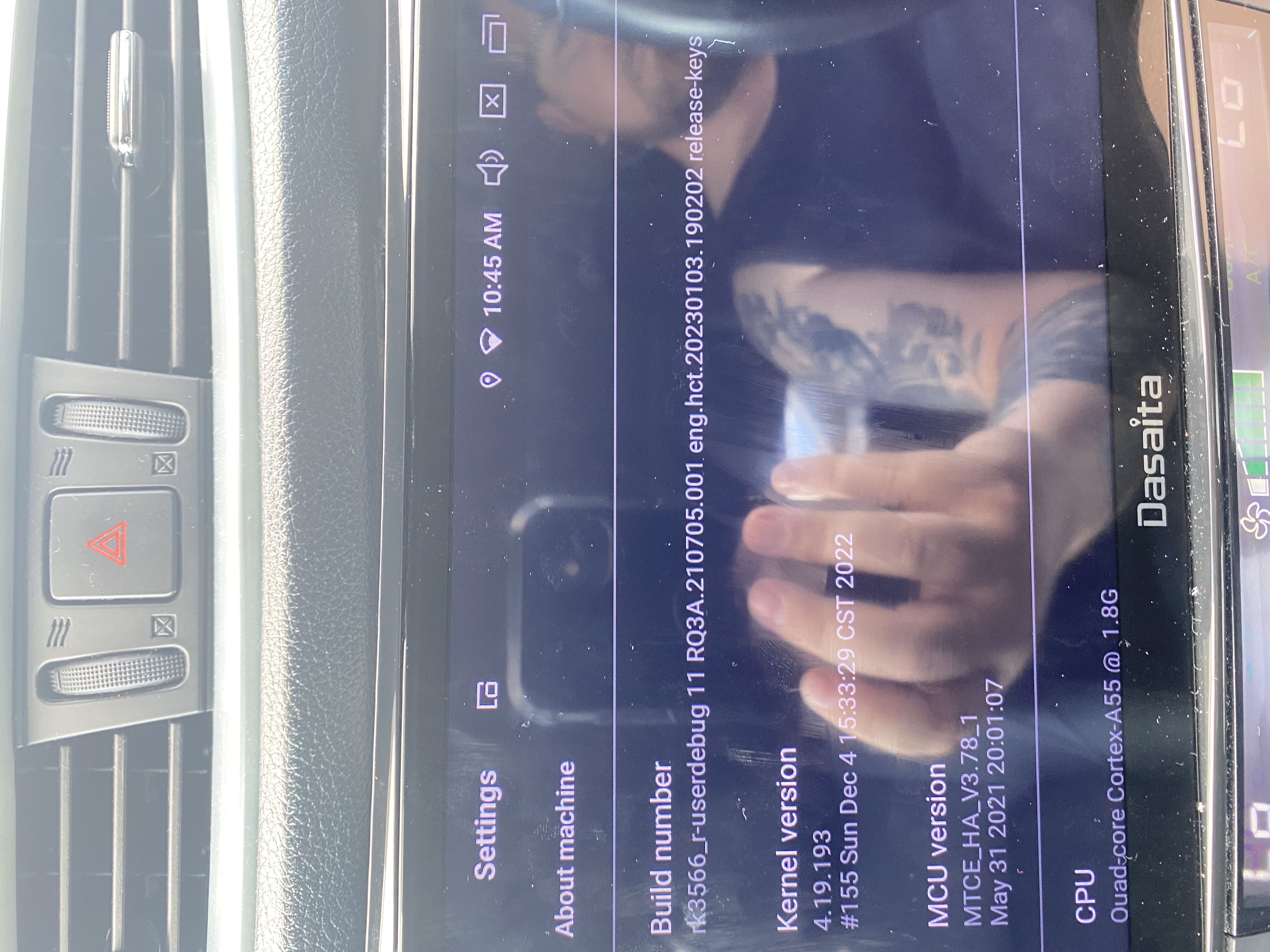

Mine needs activating. Tried home and hotspot but no change. All time zones and time is correct.
@craigy123 Did you try to share the internet to the head unit to active the zlink?
If you try but no luck,please kindly get back to us.
