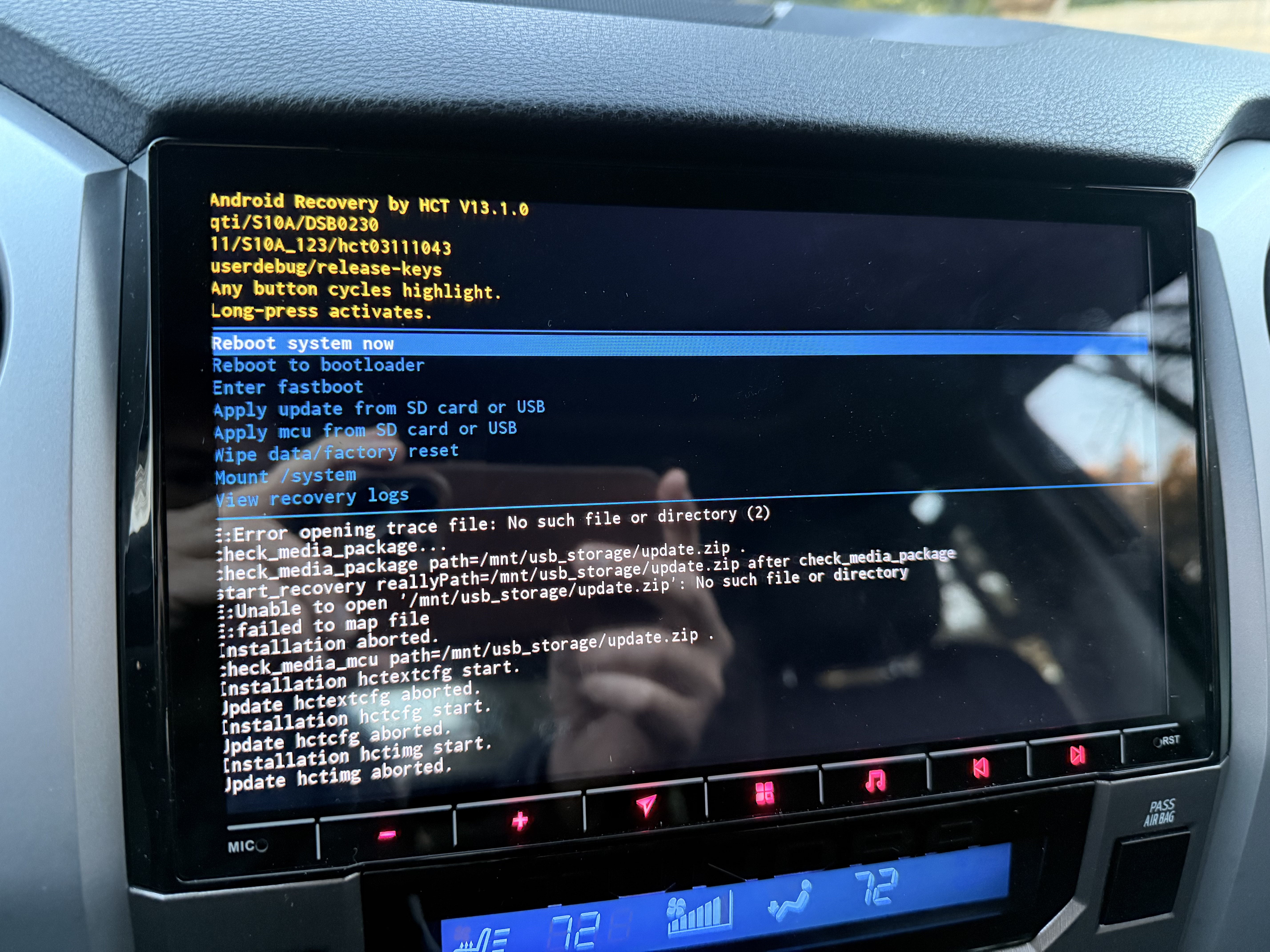

Yes I installed on the usb drive and when I plug it into the truck I get the screen to pop up to say install. The problem is the install fails.

@Support Dasaita I was able to get the firmware update and MCU update to work. I had to pull the head unit and use the other USB to get it to work. I made a few test calls and unfortunately ONLY the internal mic is working still. I tried unplugging and replugging in the external mic, but nothing!! I have checked 10 times and it's plugged into the mic port at the back of the unit and the mic headphone jack is plugged into too. I think something is seriously wrong with the unit. Should I return it?

Please update the Firmware and MCU to the latest versions using the links below. Follow the steps carefully to complete the process.
Download Links:
① Firmware G13_V2(20260811):
https://www.dropbox.com/scl/fi/puxm4pw9s4ypu1j6cxp32/update.zip?rlkey=6v9kkeufk3bkgfzpitt1rwchv&st=3y9hrx5d&dl=0
② MCU 4.18a:
https://www.dropbox.com/scl/fi/amw3k7mtkkxeb6zlbaxet/hmcu.img?rlkey=6g0yol3jrqa5s157fono6qv7s&st=4cf4ksmj&dl=0
Steps:
1.Download both files on computer.(keep names & zipped).
2.Copy file①② to a FAT32 USB drive (root folder).
3.Insert the USB drive into the device→ follow prompts → tick "Wipe data and format flash".
