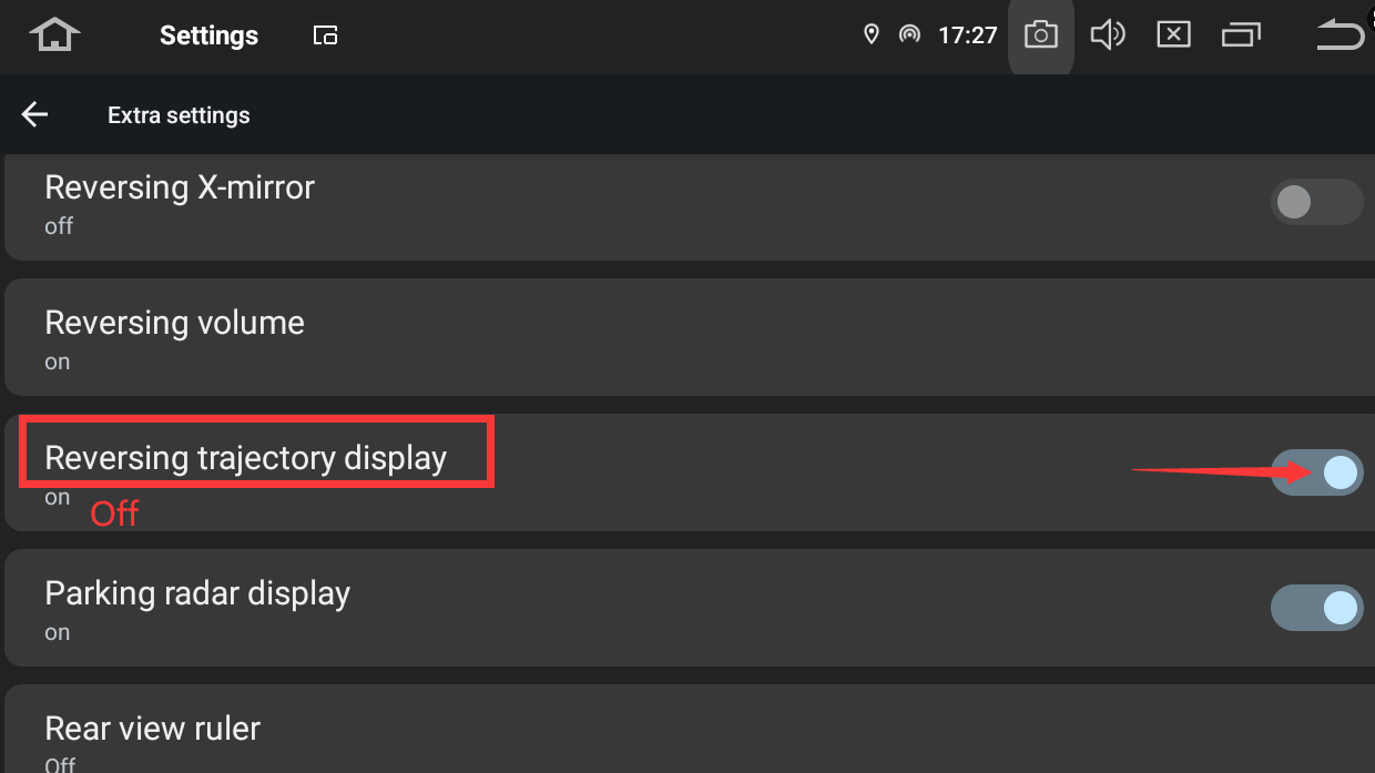

    Hello, Joseph.
    For your information, there is no setting about the calibration.
    In this case, we suggest that you can turn off our reversing trajectory but keep the original blue line only.
    Please try to disable the reversing trajectory display as follows:
    Settings > Car > Extra setting > Reversing trajectory display > Off.

  • @Joseph D'Angelo
    It may be the cause.
    We suggest that you use the original blue line only and disable the reversing trajectory display.
