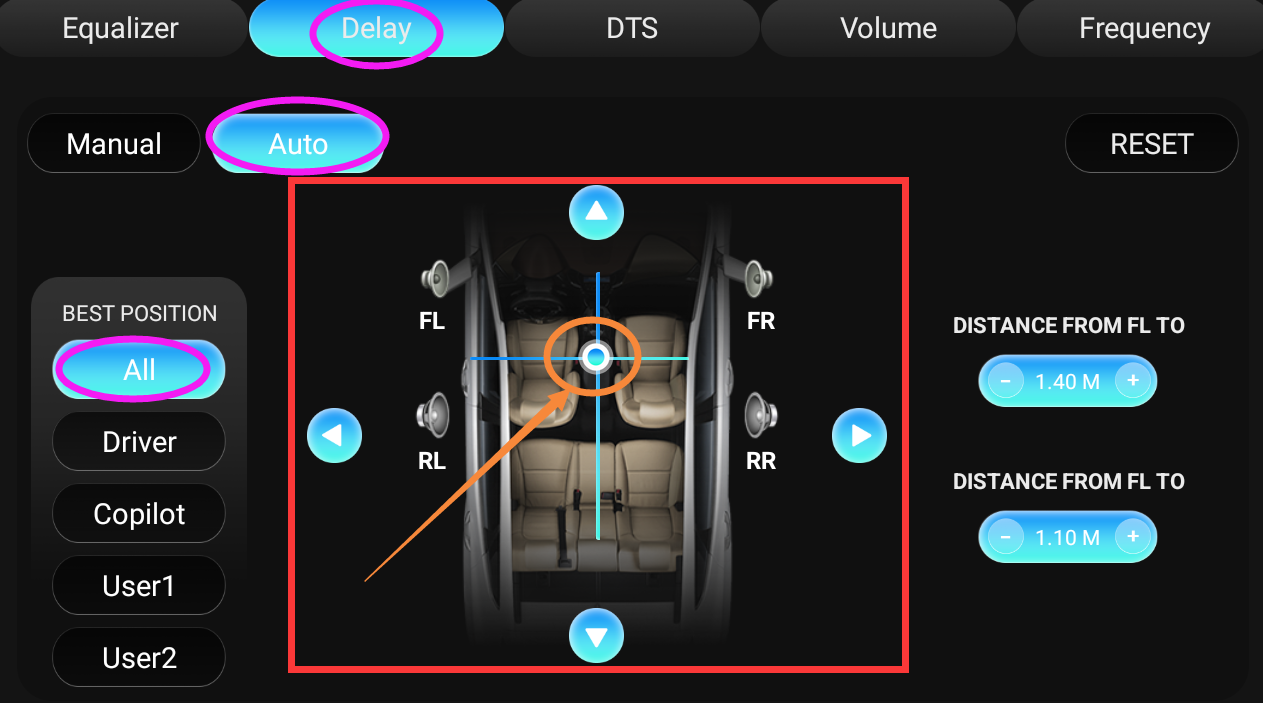

    Then please try to go "Amplifier App > Delay > Auto > All" to move the crosshair to the center,
    then see if all speakers have sound normally.

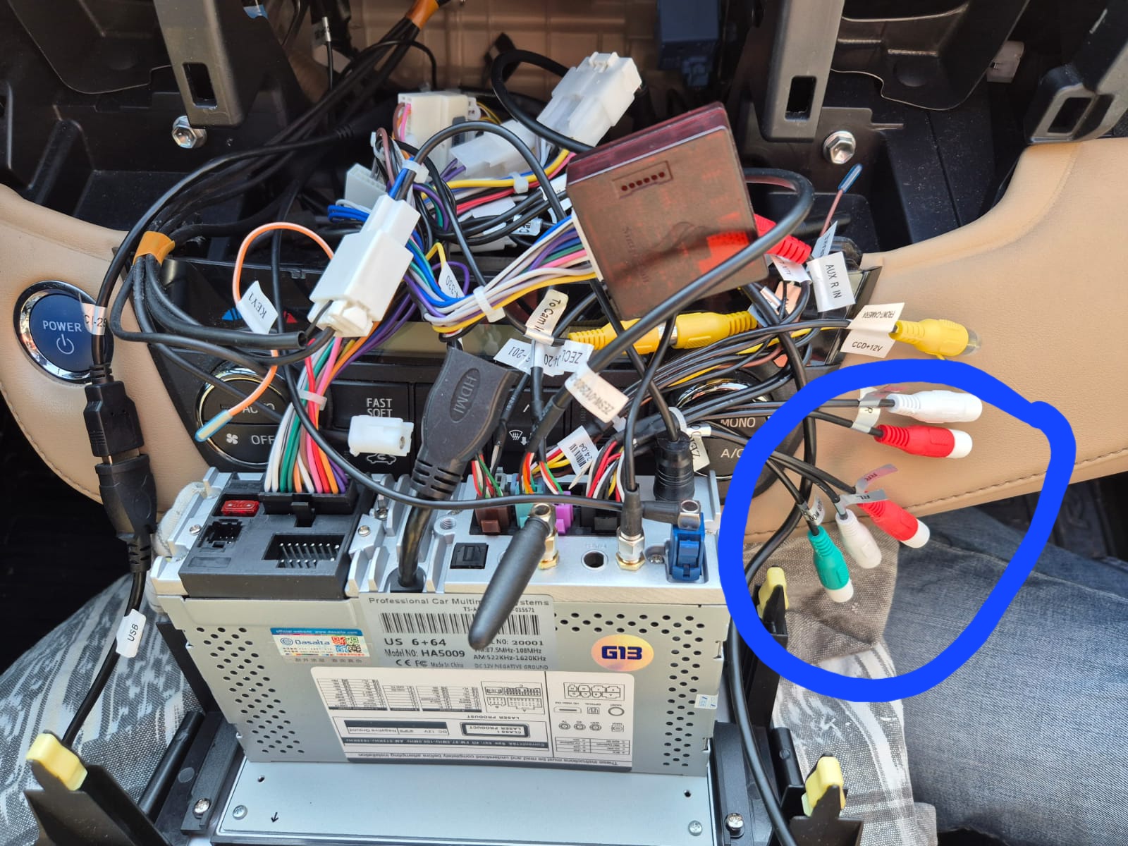

  • The only kabels are not connected are see the bleu circles
  • @Pieter Versluis
    For your information, the blue circles are used for the aftermarket amplifier.
    Please ignore it if your amplifier is not aftermarket.

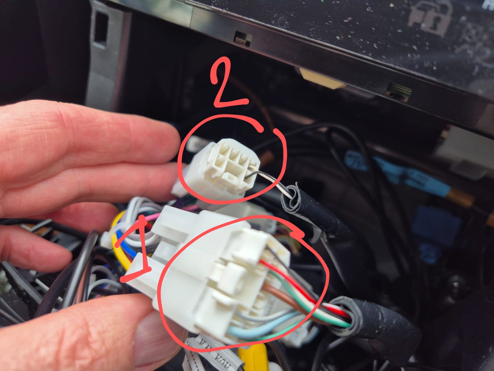

    Please refer to attached picture and make sure that the White Plugs of speaker cables have been connected properly.
    To further confirm, please tell us how it goes after going "Amplifier App > Delay > Auto > All" to move the crosshair to the center.
    1. Hello i check the kabels  zie picture

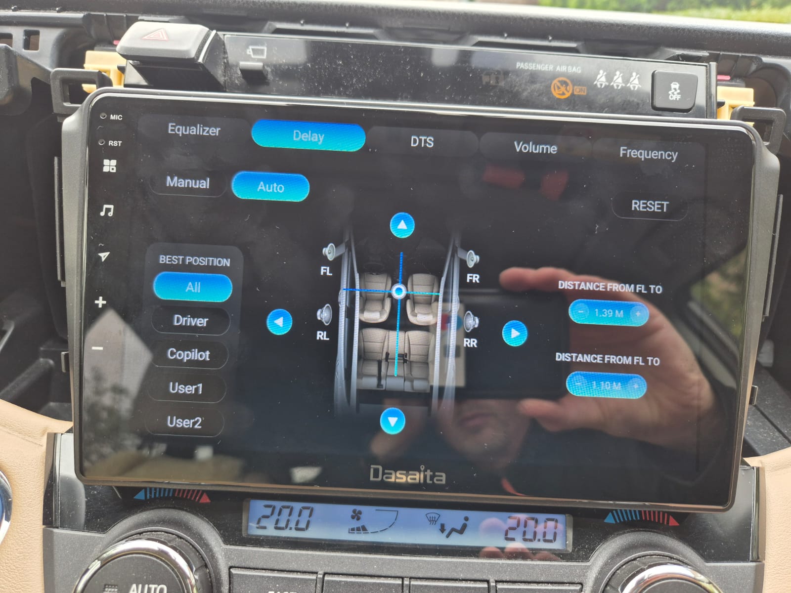

  • And i check the audio setting you ask
  • Still no speaker in the rear

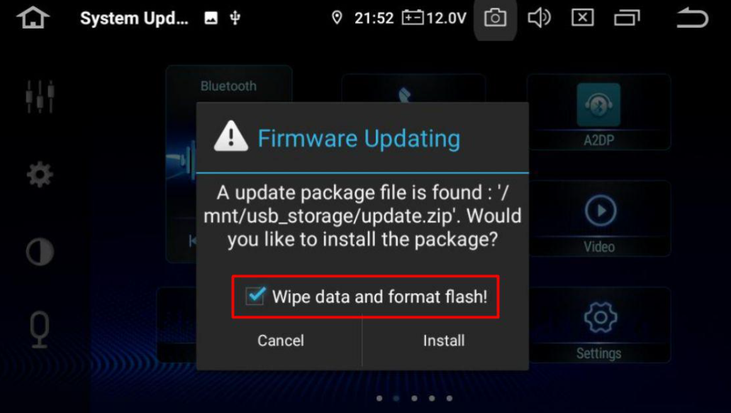

    System Firmware-G13-202504523:
    https://www.dropbox.com/scl/fi/a5h978wsreg9uuipf6bw1/update.zip?rlkey=p77ztea3f3gdhu24t0845i2mq&e=1&dl=0
    MCU-4.16b:
    https://www.dropbox.com/scl/fi/0ihjcsi6snloq2s1kmskv/hmcu.img?rlkey=gqylhwmievf23h5ksqa7xvtyy&e=1&dl=0

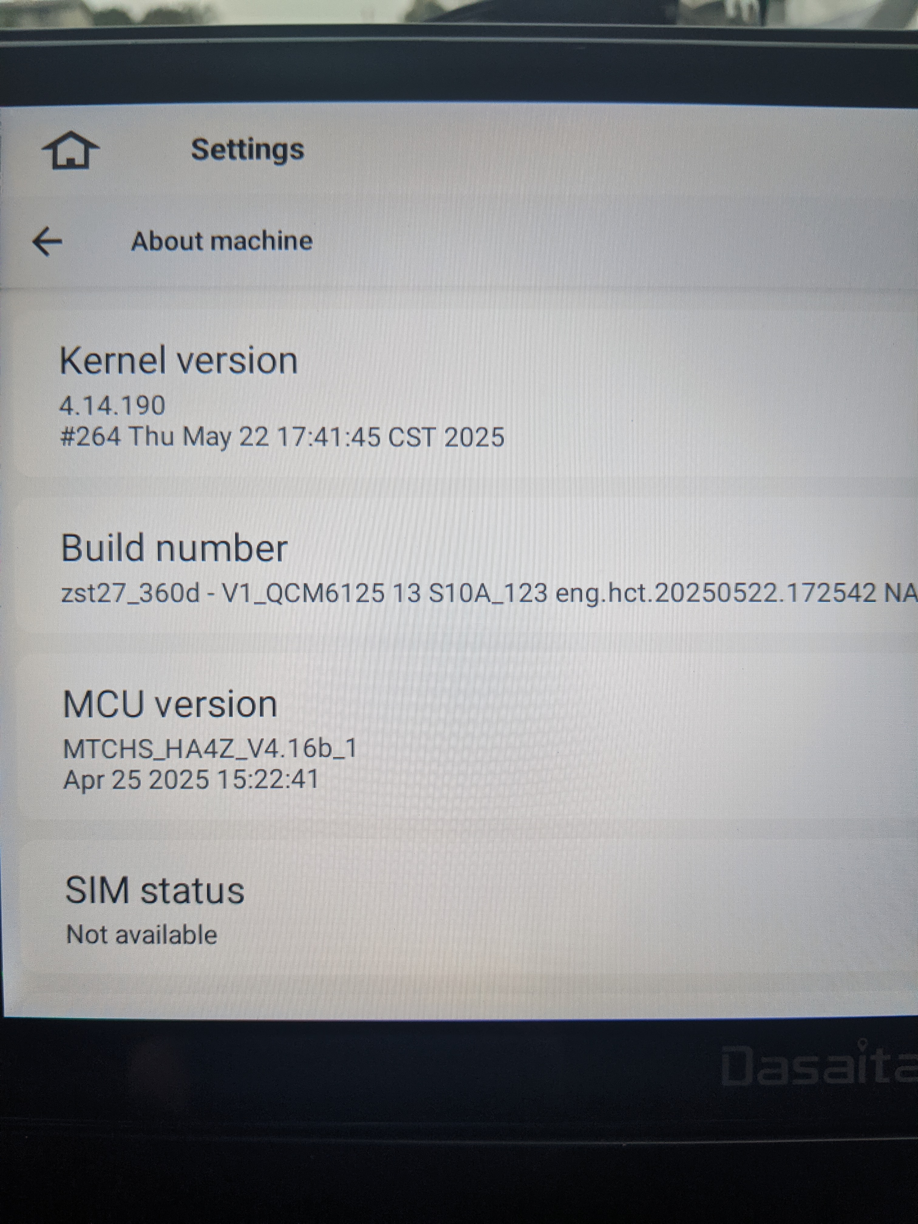

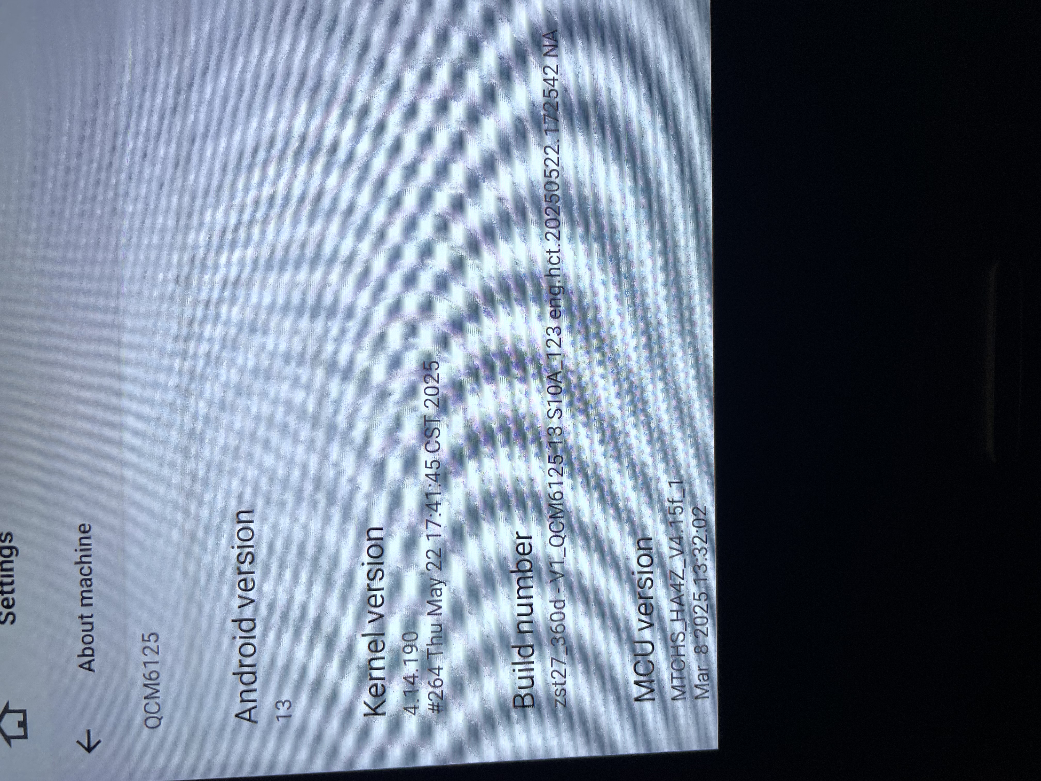

    Could you please go to Settings>About machine and provide the following version information:

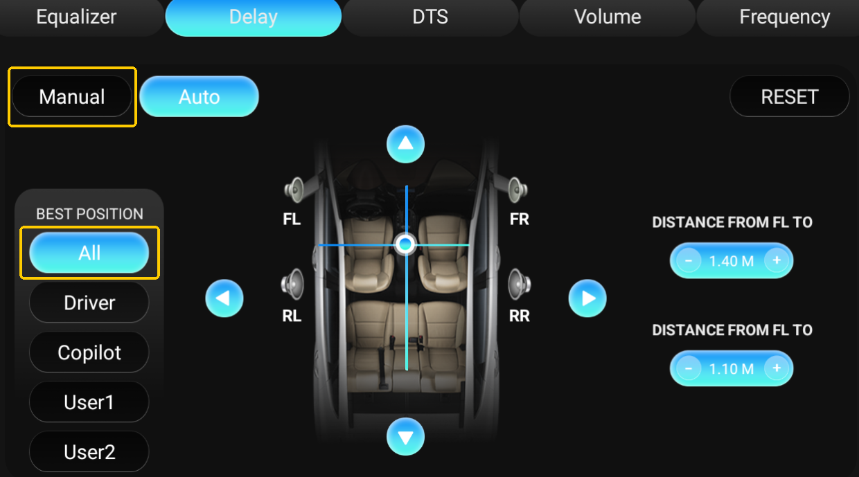

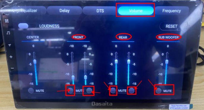

    And please go to the DTS APP to check if the mute button is disable.
    And please set to "ALL"and"Manual"to see how it work.
  • @jose gonzalez Hi jose,what unit version do you have?
