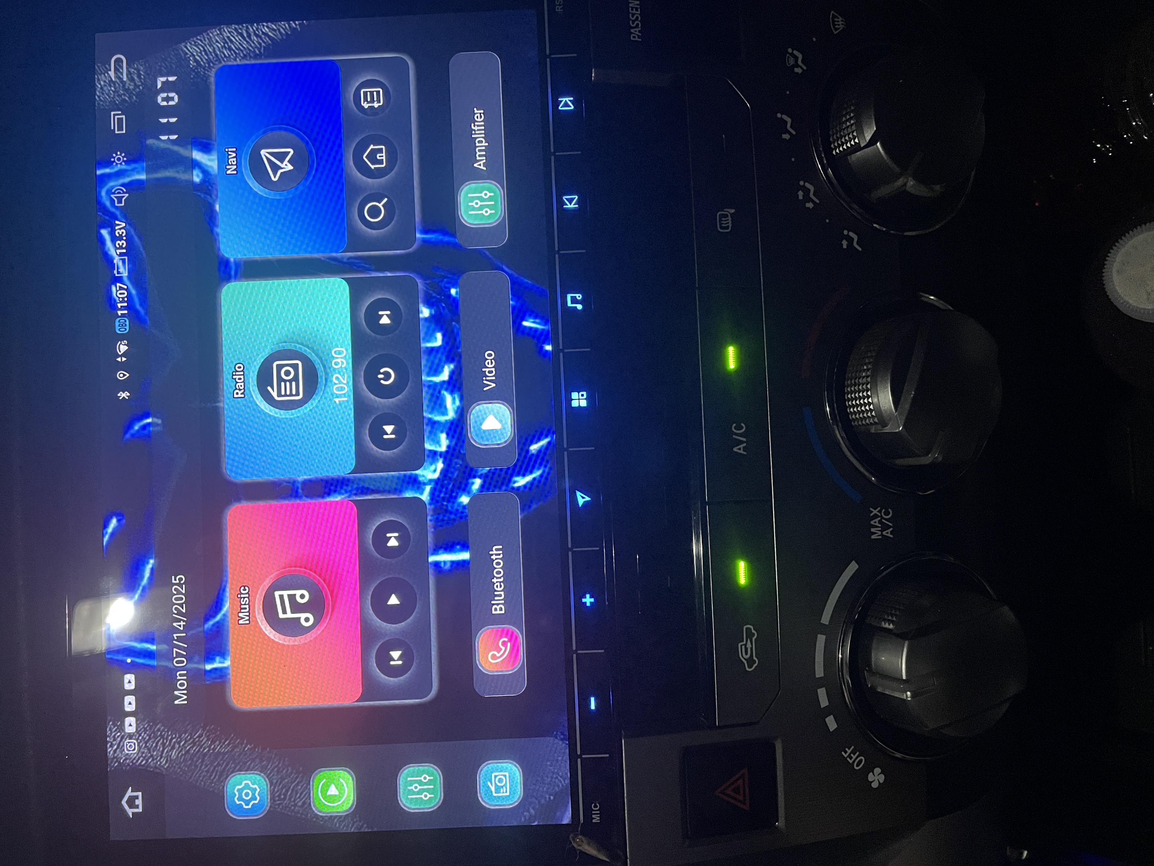

@Support Dasaita as you can see in the picture below the a/c is on but nothing displays on the screen.
@Dennis Tribble
Thank you for your reply.
Is the door information working well?
Please double check if A/C information display 1 second on screen when you on the A/C . It won't display all the time.
If it is not luck, please try to update the system . We've sent the latest version to your message.

@Support Dasaita The door information works fine. I flashed the firmware but still do not have any type of a/c displayed on the screen. Not even for a second.

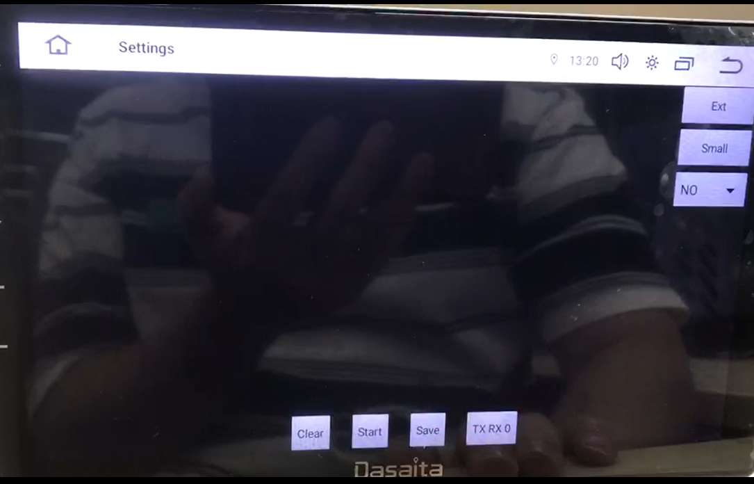

Our technical support advise to logcan the data so they can check the details
Here is the steps of how to logcan the data of A/C on Dasaita unit:
*Please record a clear video of the whole logcan operation
1.Please go Settings>Car>Factory Settings> Password is Logcan .
2.Please turn on the A/C in your vehicle. If possible, please turn on A/C several times to obtain more data.
3.Then click "Save "and then "Exit" .Go to the filebrower to find the CANBUS files ,copy it to the USB driver and send it to us.
@Support Dasaita I have sent the .log file and also a video to your email.
