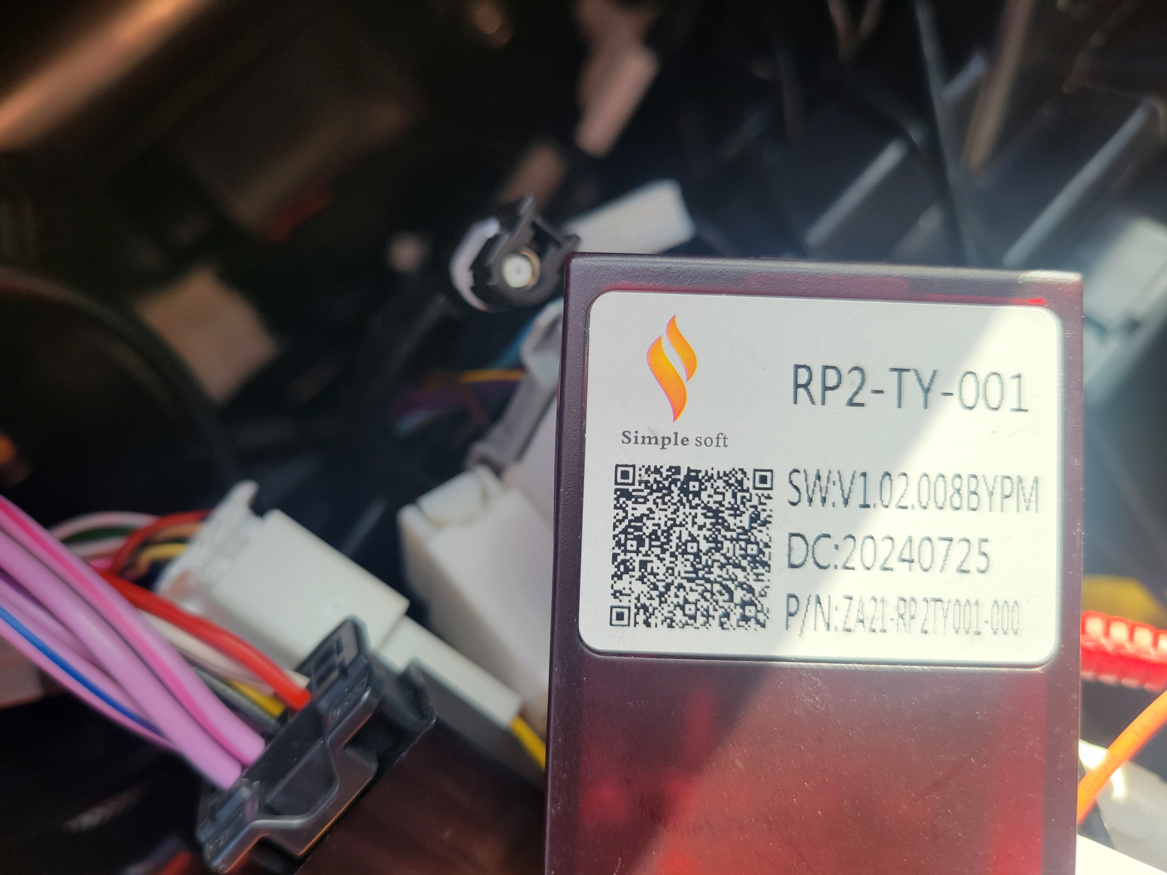

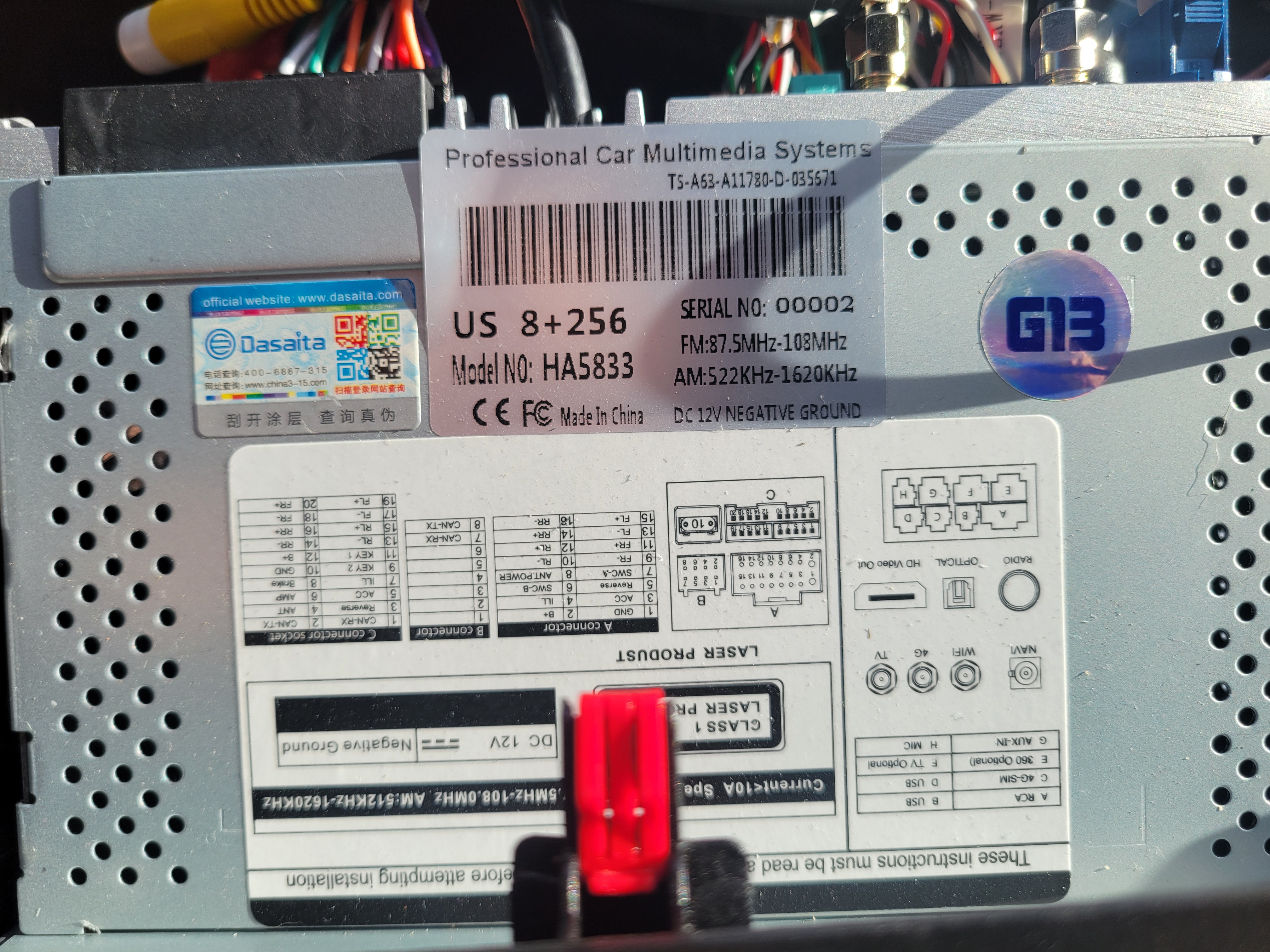

I have a 2023 Tacoma TRD Off Road with a factory front camera. I cannot get F-cam to work on my Dasaita unit. Here is my head unit and CanBus:

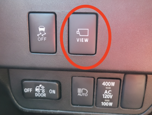

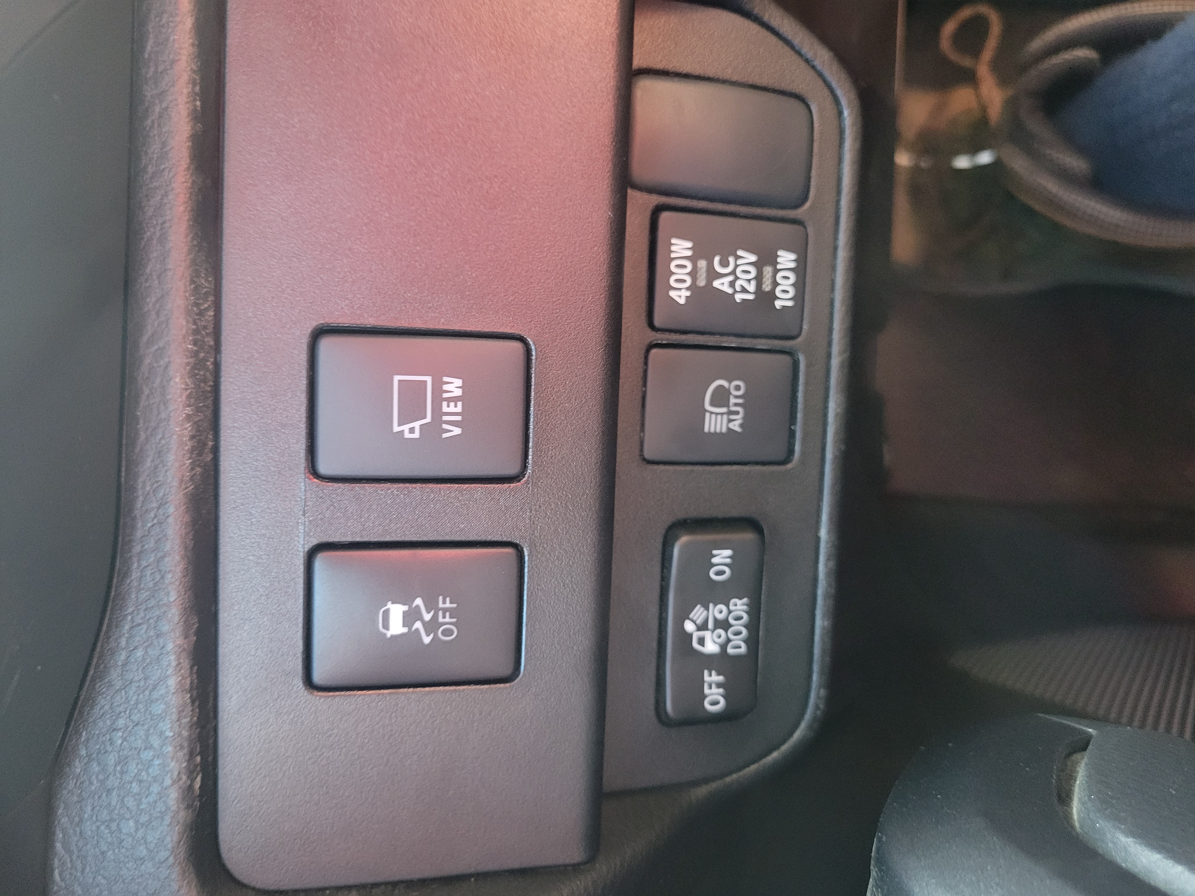

Because I have a factory front camera, I have a "View" button on my dash:

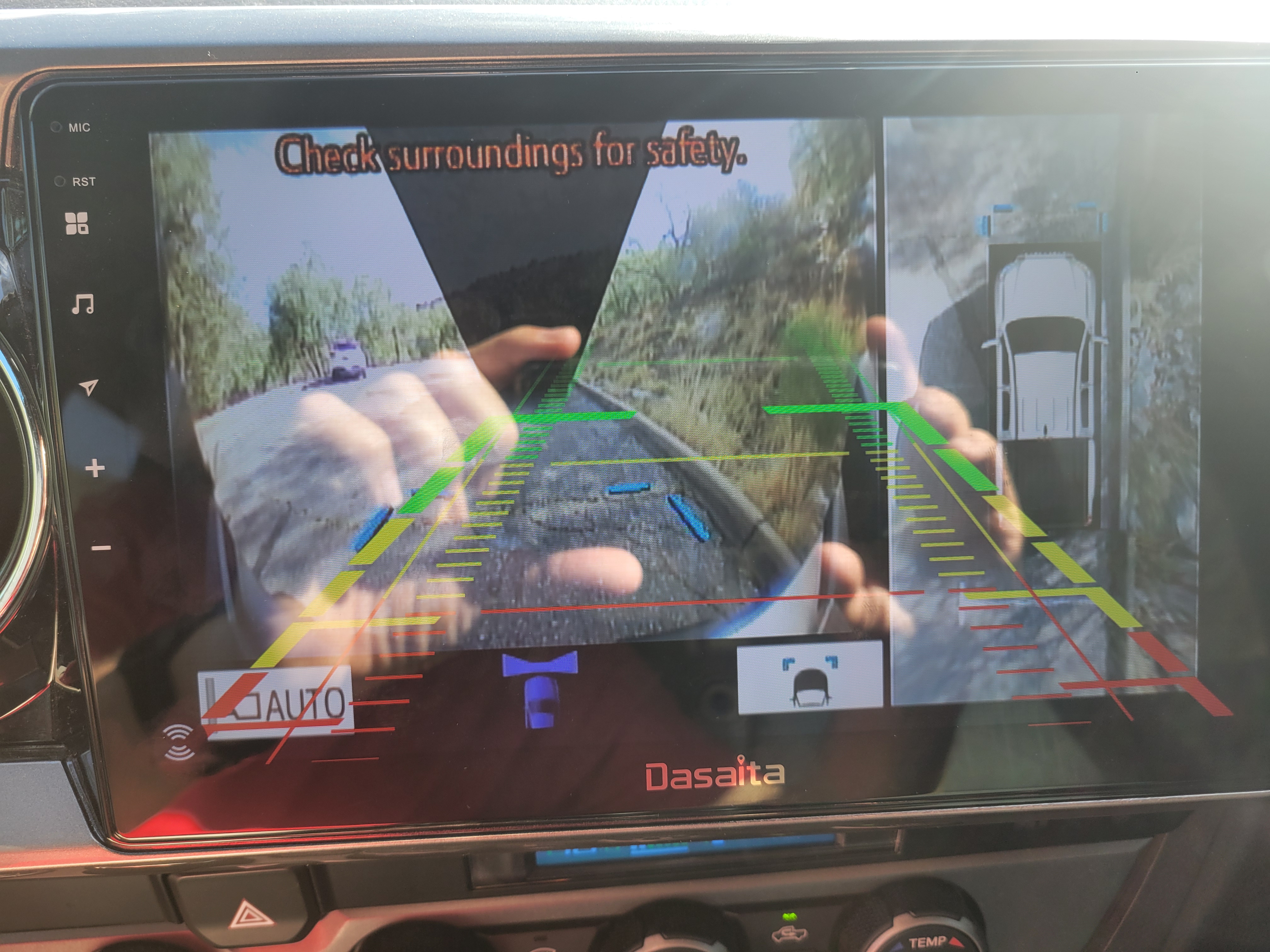

Pushing the View button shows my front camera, but it only works at very low speed - I think under 10 miles per hour. But here is what it shows:

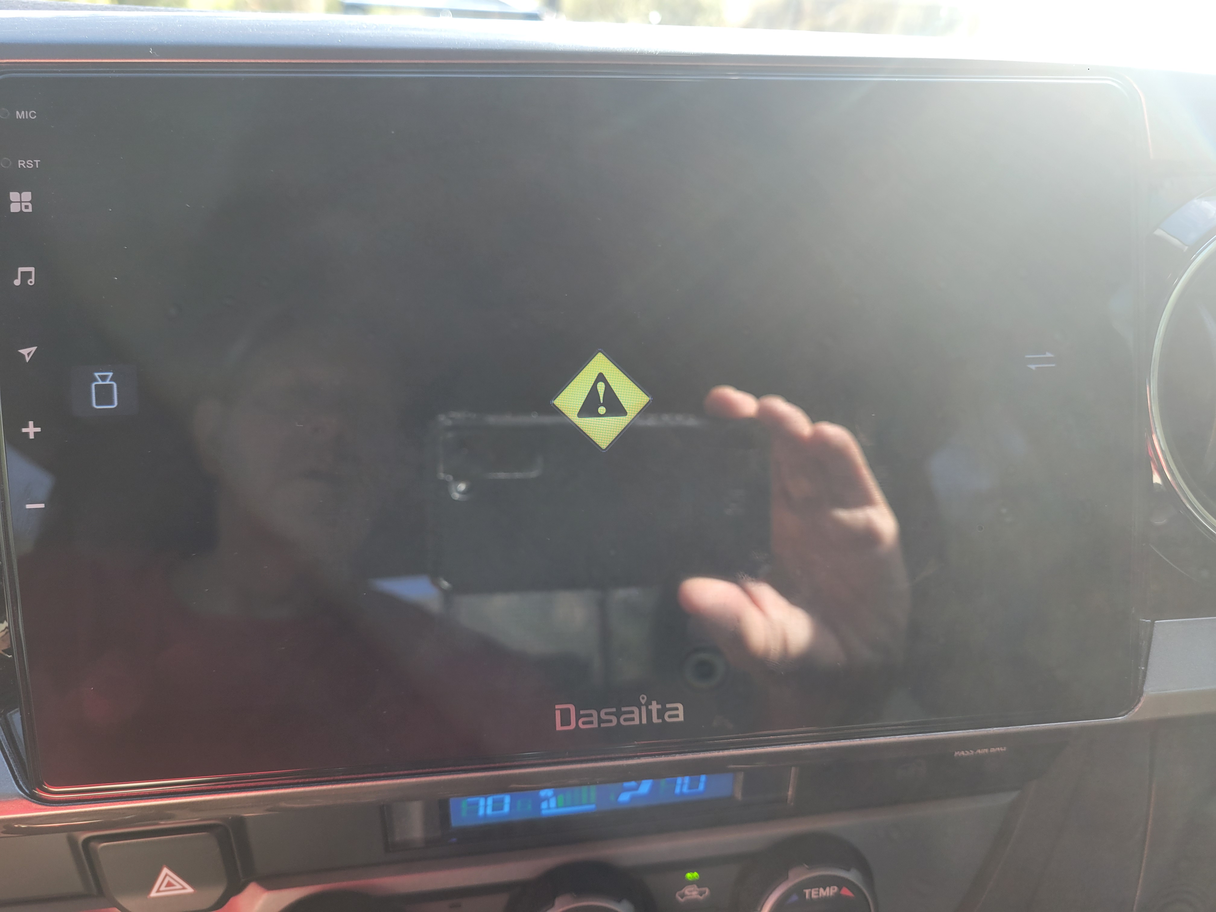

My problem is that I want the F-cam app to show the fornt and rear cameras. But I get nothing. Here is what I see when I open F-cam (just a yellow warning symbol):

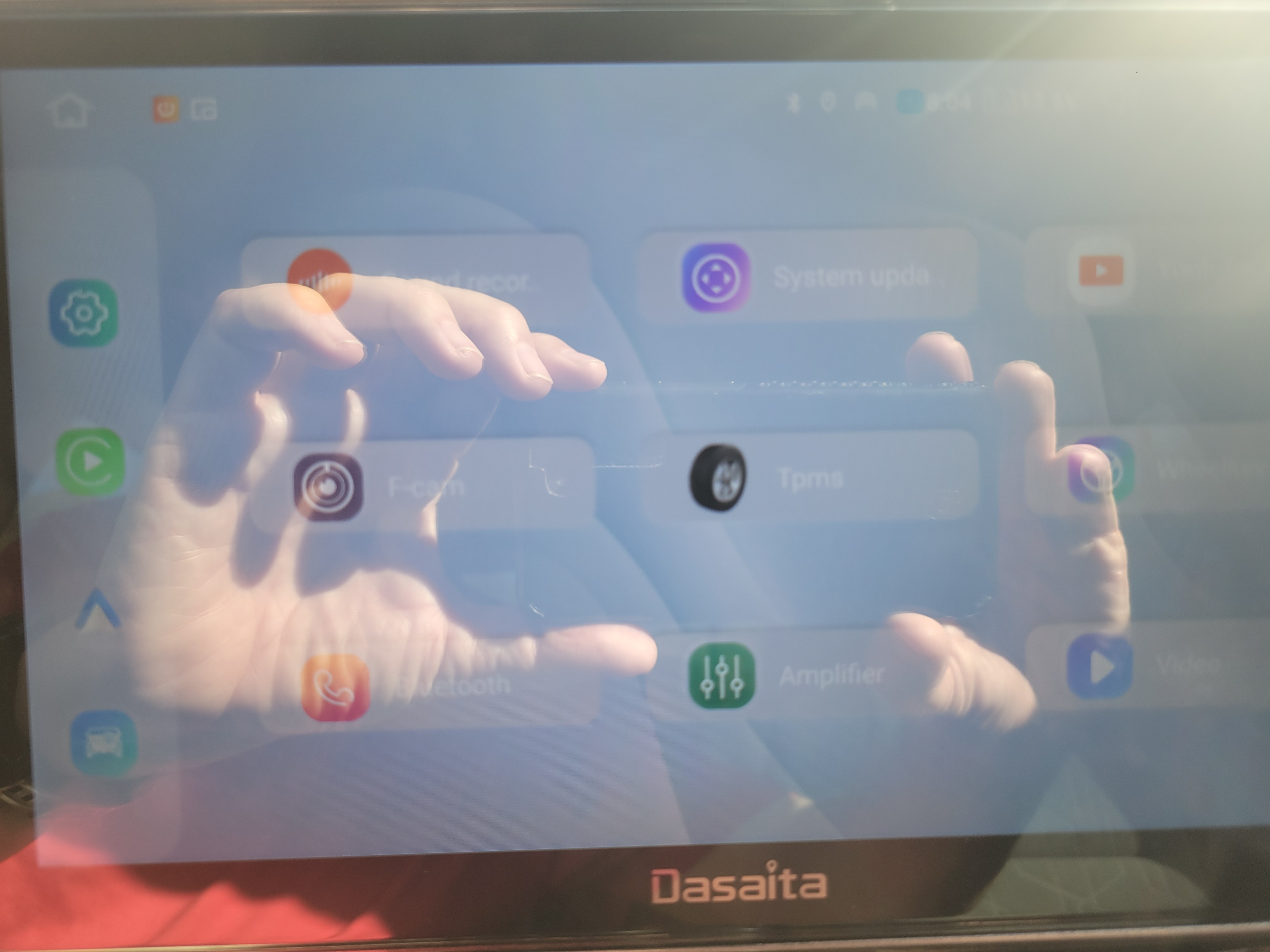

If I tap the little camera icon on the left side of the screen, to show the rear view, then I get nothing too:

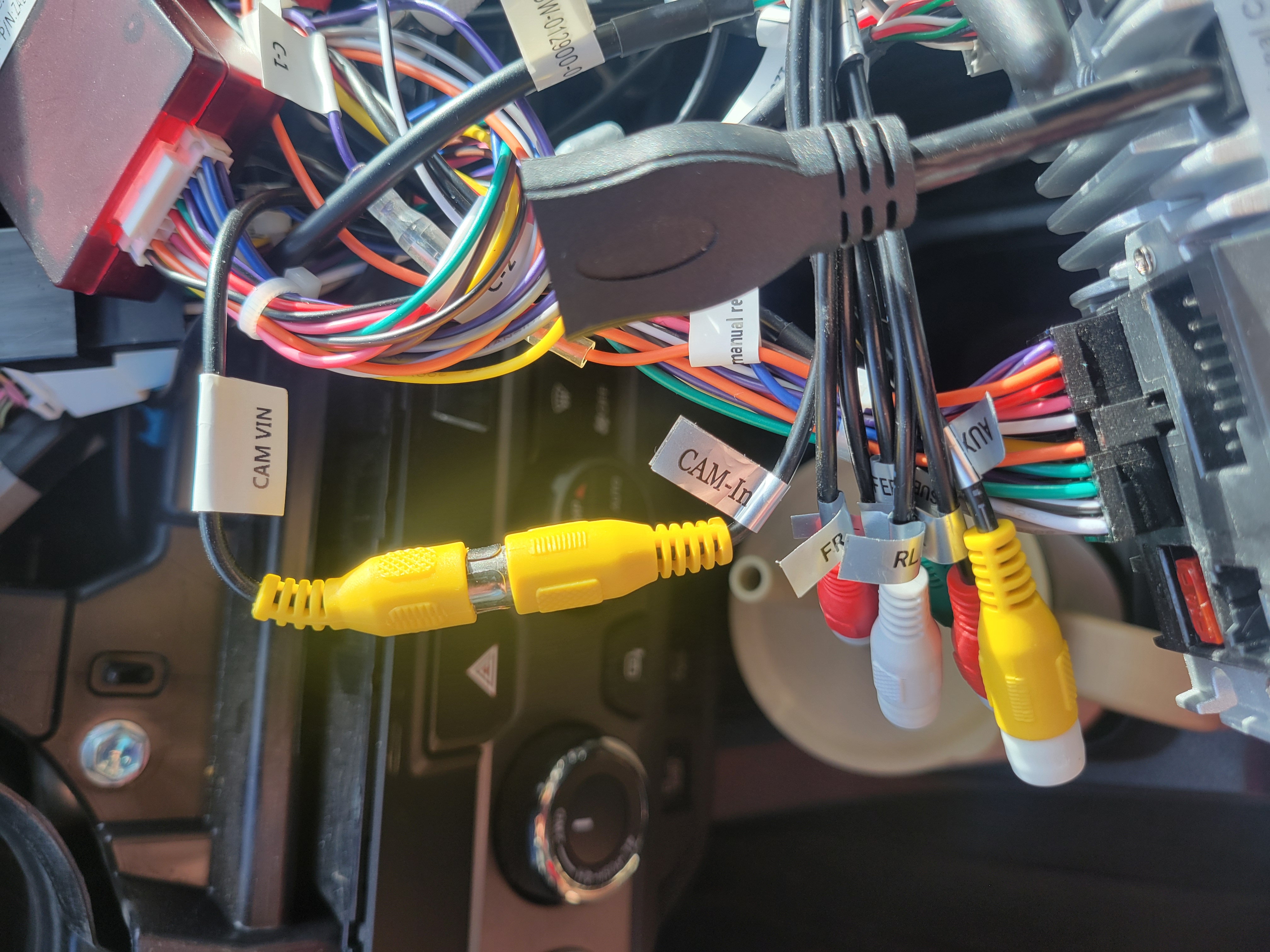

Here is my wiring. I have the yellow CAM VIN male connector from the vehicle connected to the yellow CAM-In female connector on the head unit.
Is the problem that the View button isn't sending anything through the wires until it is pressed, and at that point it takes over the entire head unit?

After checking ,you've connected the unit properly.
For your information, the F-cam app is for the aftermarket camera. So it is a yellow warning symbol .
For the factory front camera, it is from the factory 360 camera .
When you press this "View" button, if the360 camera appears, it indicates that the CANBUS has transmitted data to support the factory 360 camera.
