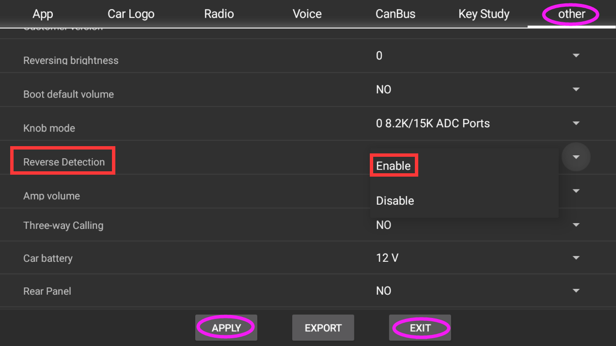

  • @Chriss PC Fix
    About the backup camera connection, please make sure that you have connected Yellow RCA "Cam In" with Yellow RCA "Camera".
    And please confirm the setting:
    Settings > Car > Factory setting (password :126) > Other > Reverse Detection > Enable > Apply > Exit > Reboot.
