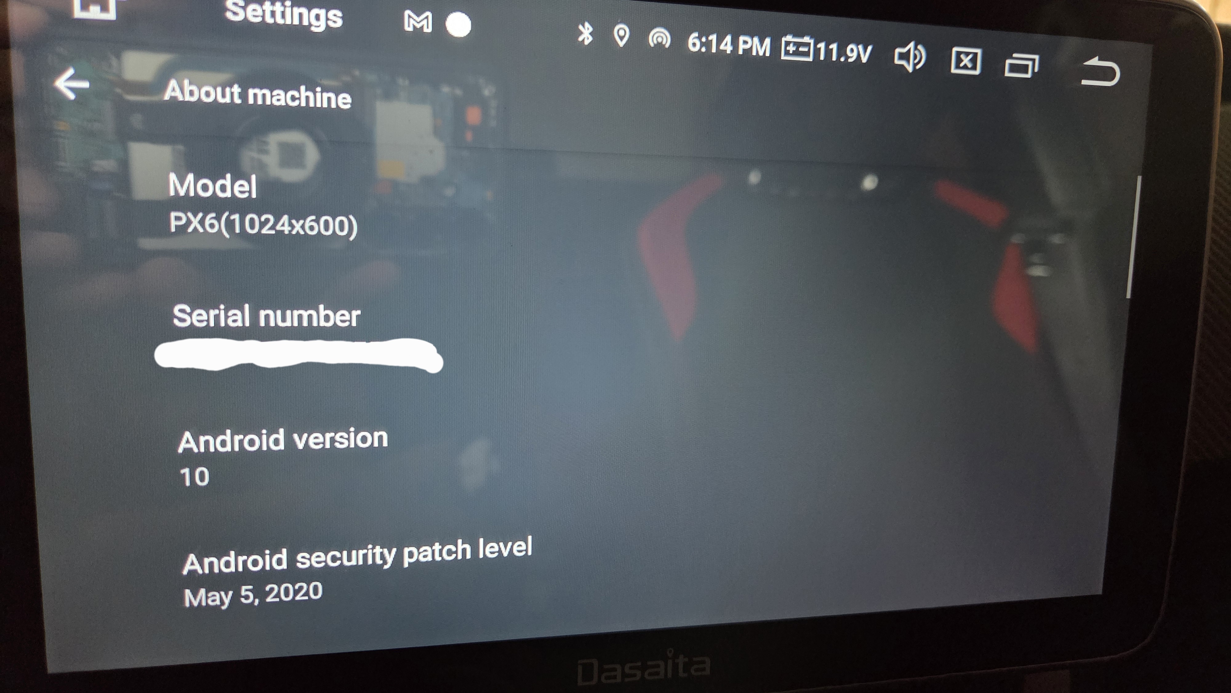

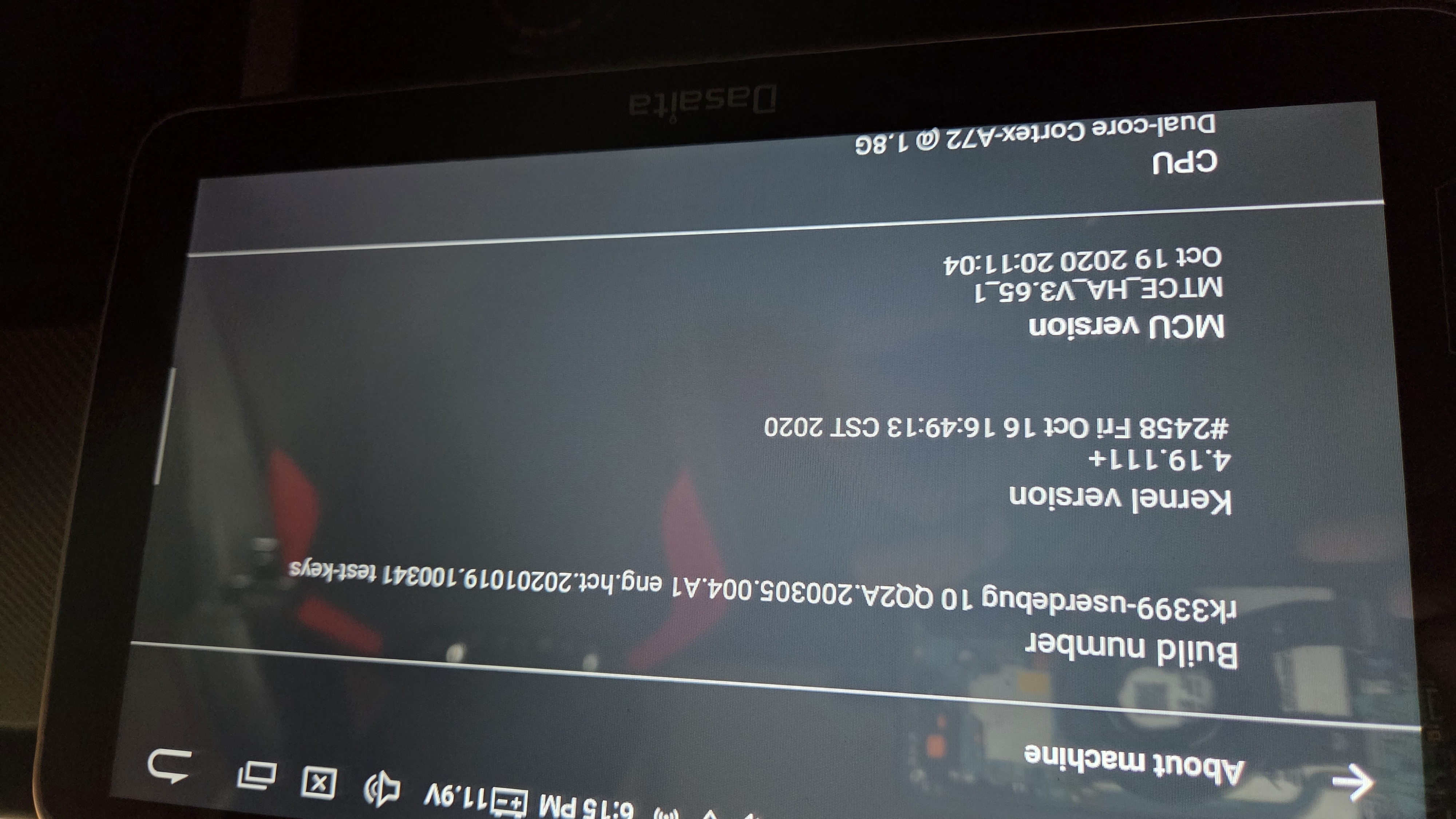

Wondering if my headunit needs updates
  • Hi. I just wanted to know if there is an update for my head unit
  • the question is ...
    Why do you think your unit needs any update? Is anything not working correctly?
  • @Mark T If there is any issue with the unit?
  • The connectivity between the headunit and my phone fails randomly like when i start my car, zlink would not connect. There are also times when it doesnt connect I'd try using the usb connection (I've tried different usb cables to see if it was the case) but it'll go in an out of connection or it wouldnt connect to my phone at all.
  • Another issue would be the volume. When I play my music through zlink it isn't consistent, there are times where the music volume is very soft where I would have to increase the volume. Then the next day it's loud and I'd have to turn down the volume.
