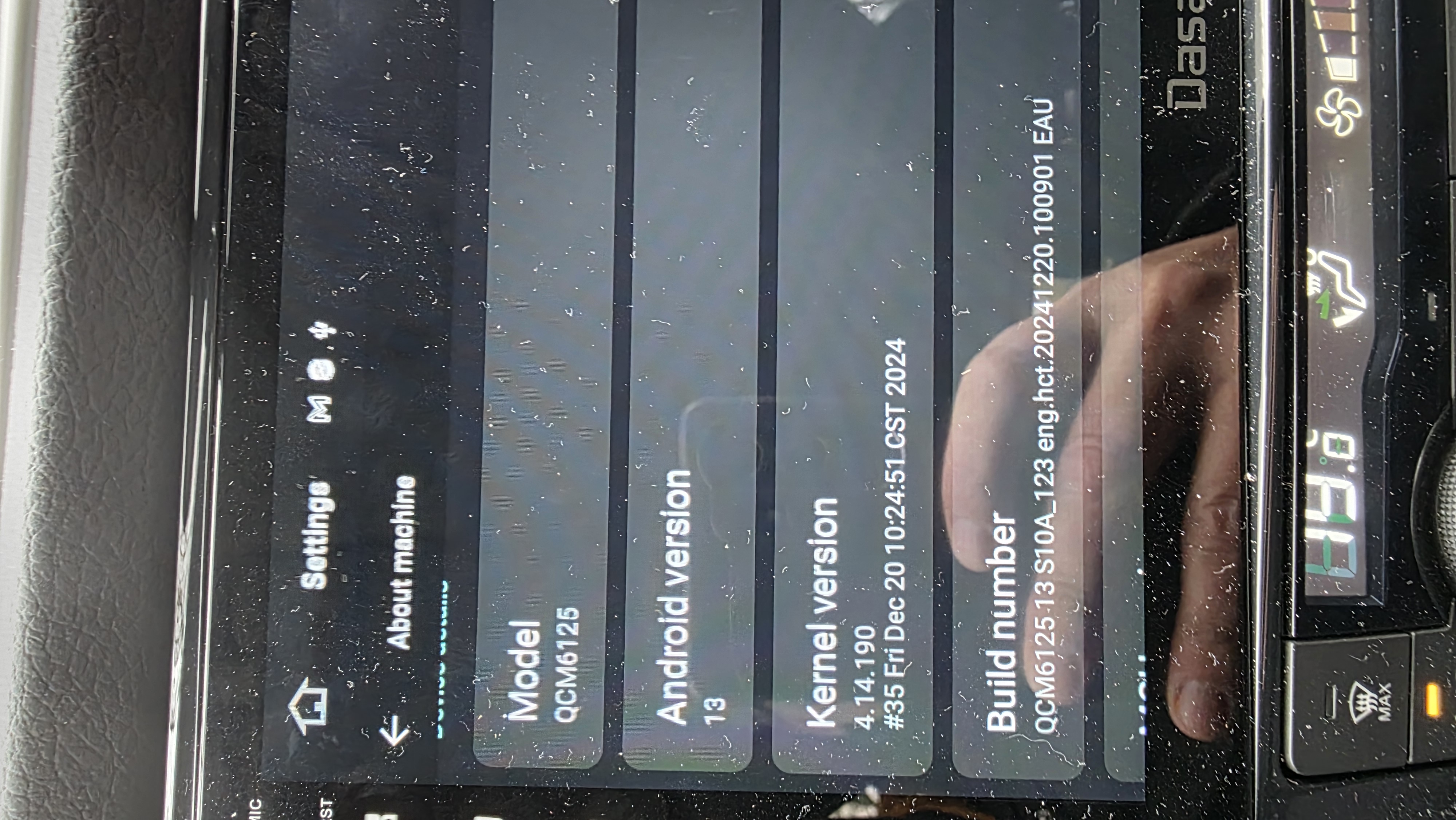

  • The order number was SP-DA7270
    Here a screenshot of the original firmware:  (MCU version was 4.14A)
    Tried all the reset options but nothing helped, now running the latest Vivid V1 version with the new MCU 4.17a
