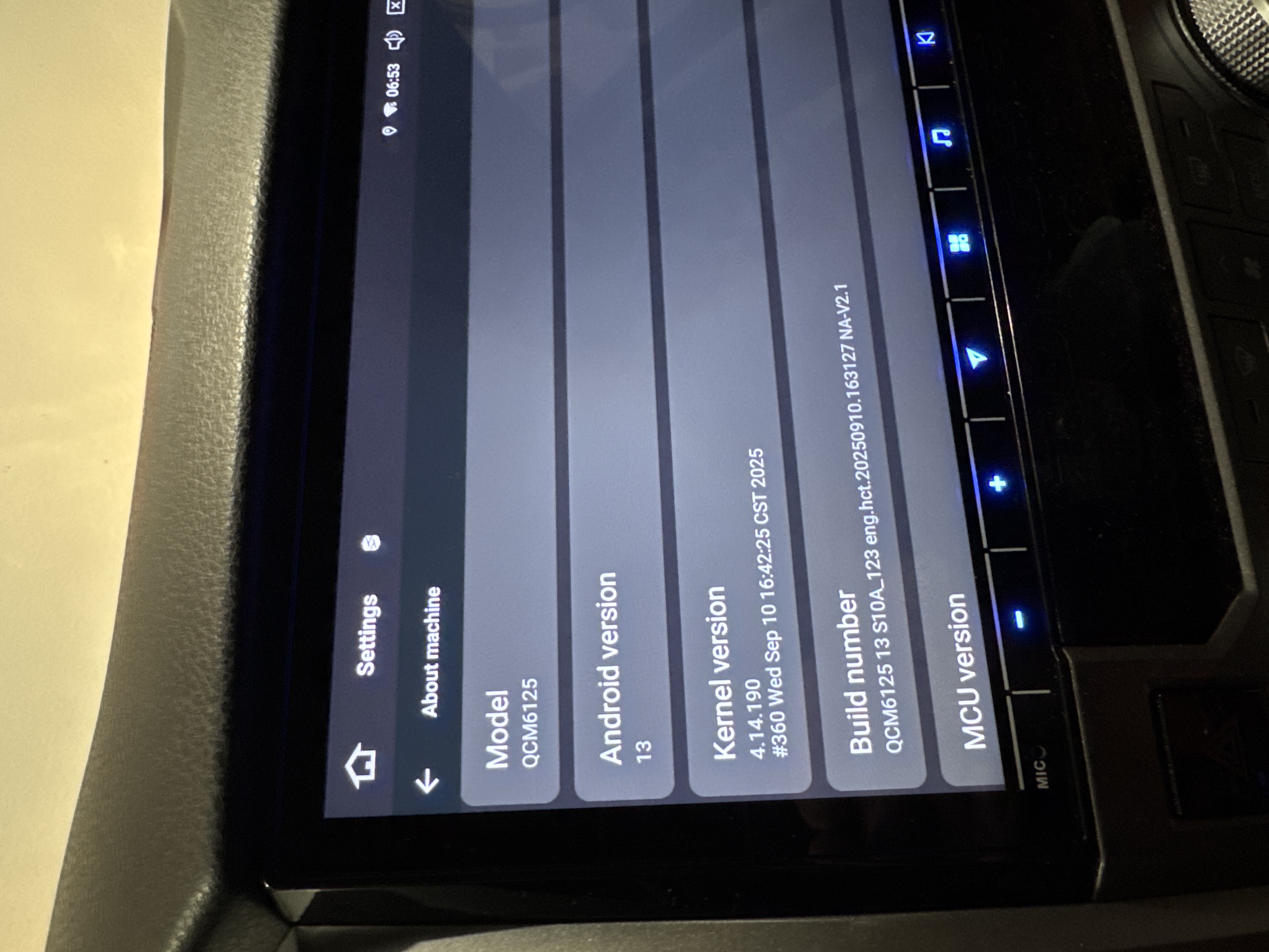

  • @Support Dasaita hi there, youtube does work. I've attached a photo of the error I get from Netflix
  • @Tyson Erdman Could you please delete the pre-installed NetFlix and then download it from the Google Play store?
