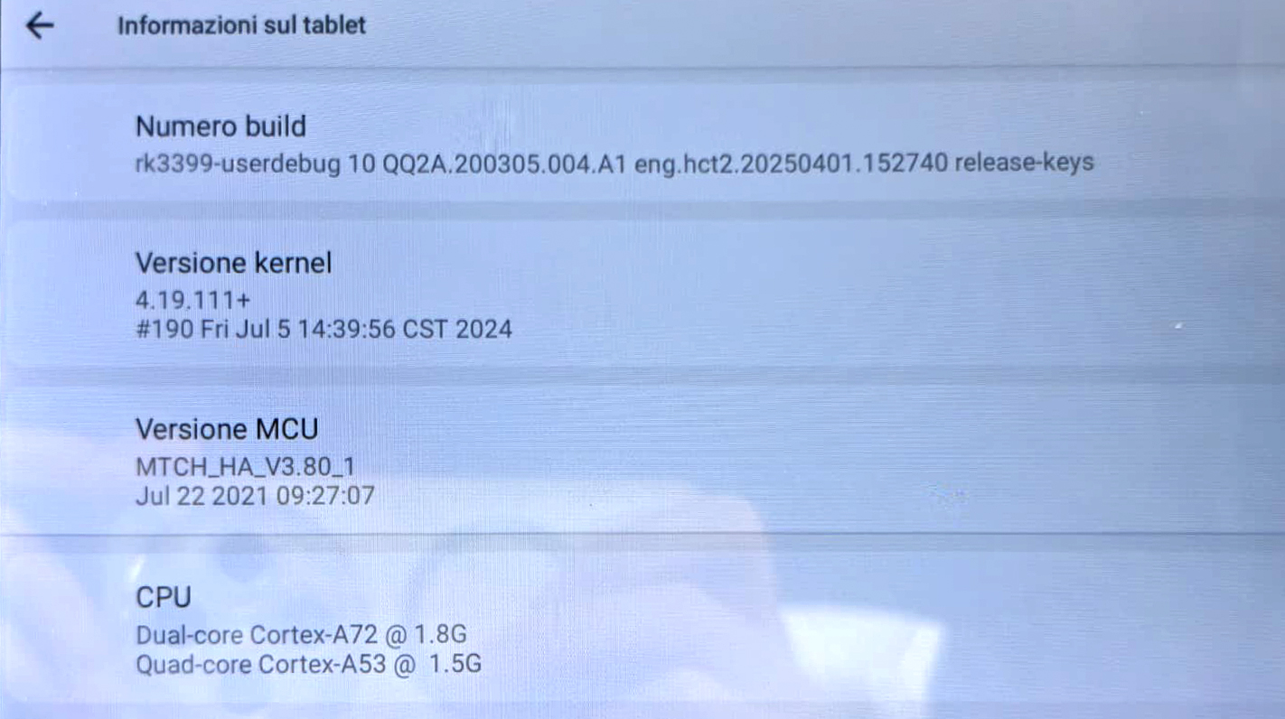

@Edoardo Edo
Based on your picture, it already is the latest version.
