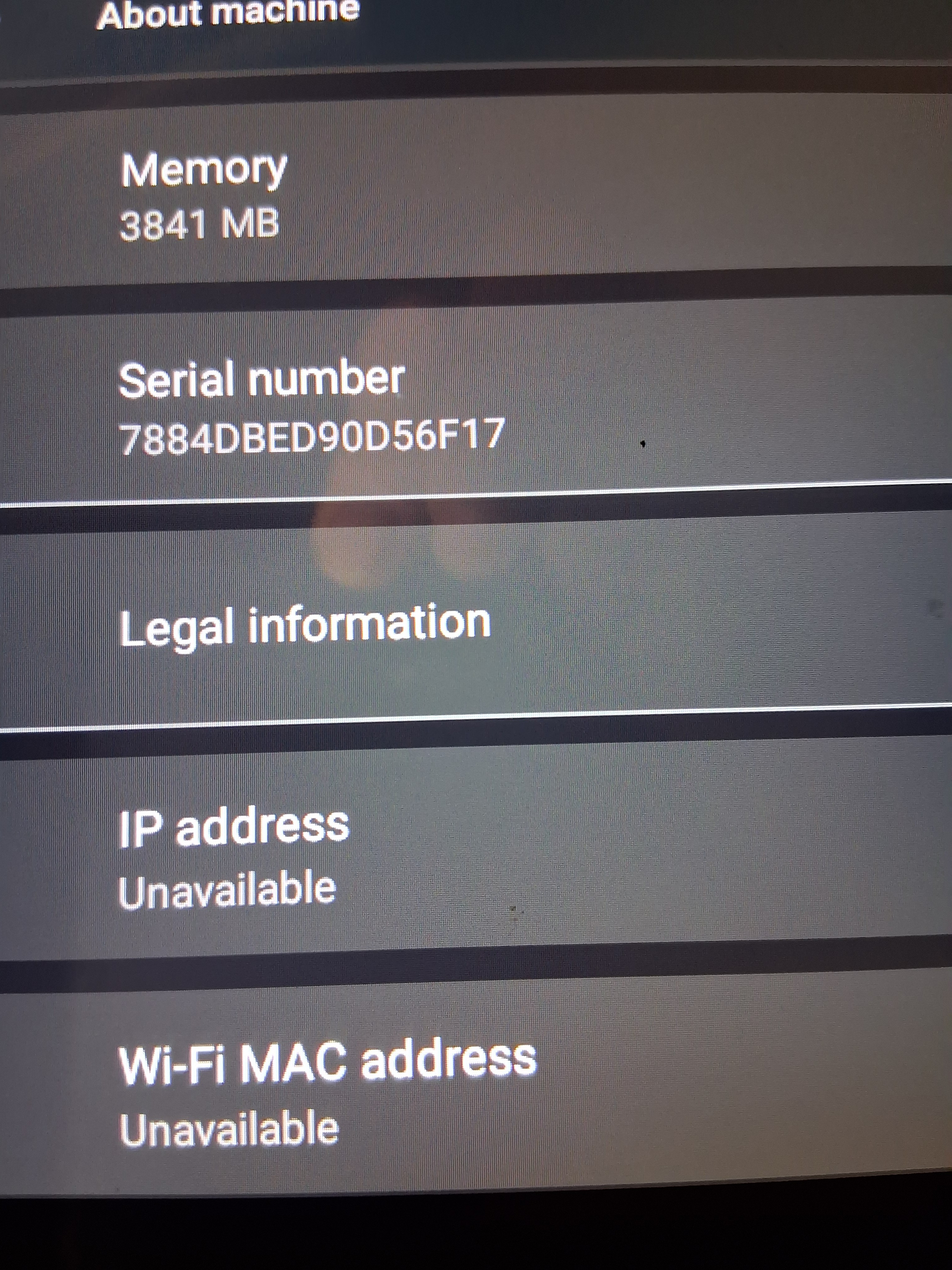

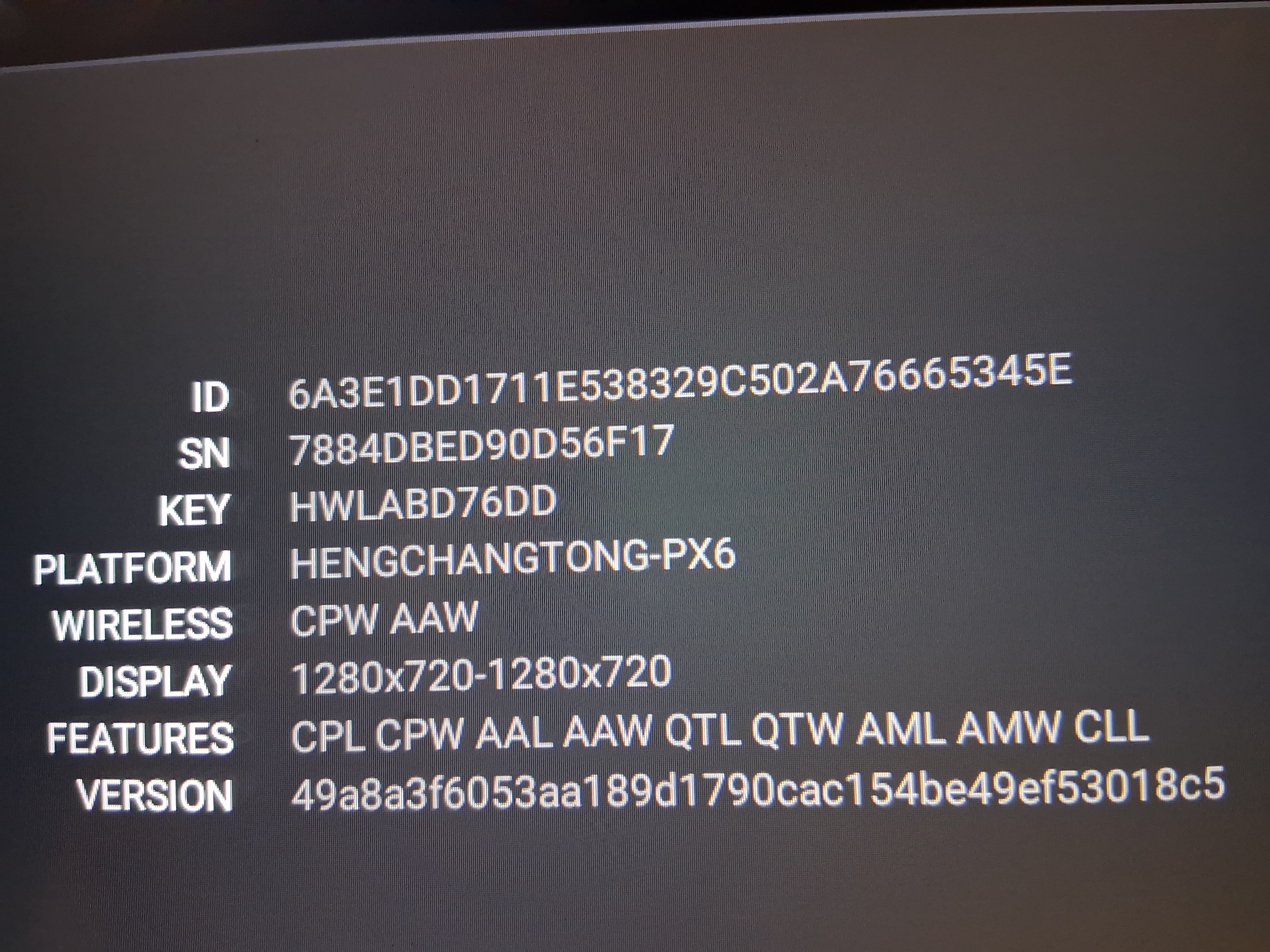

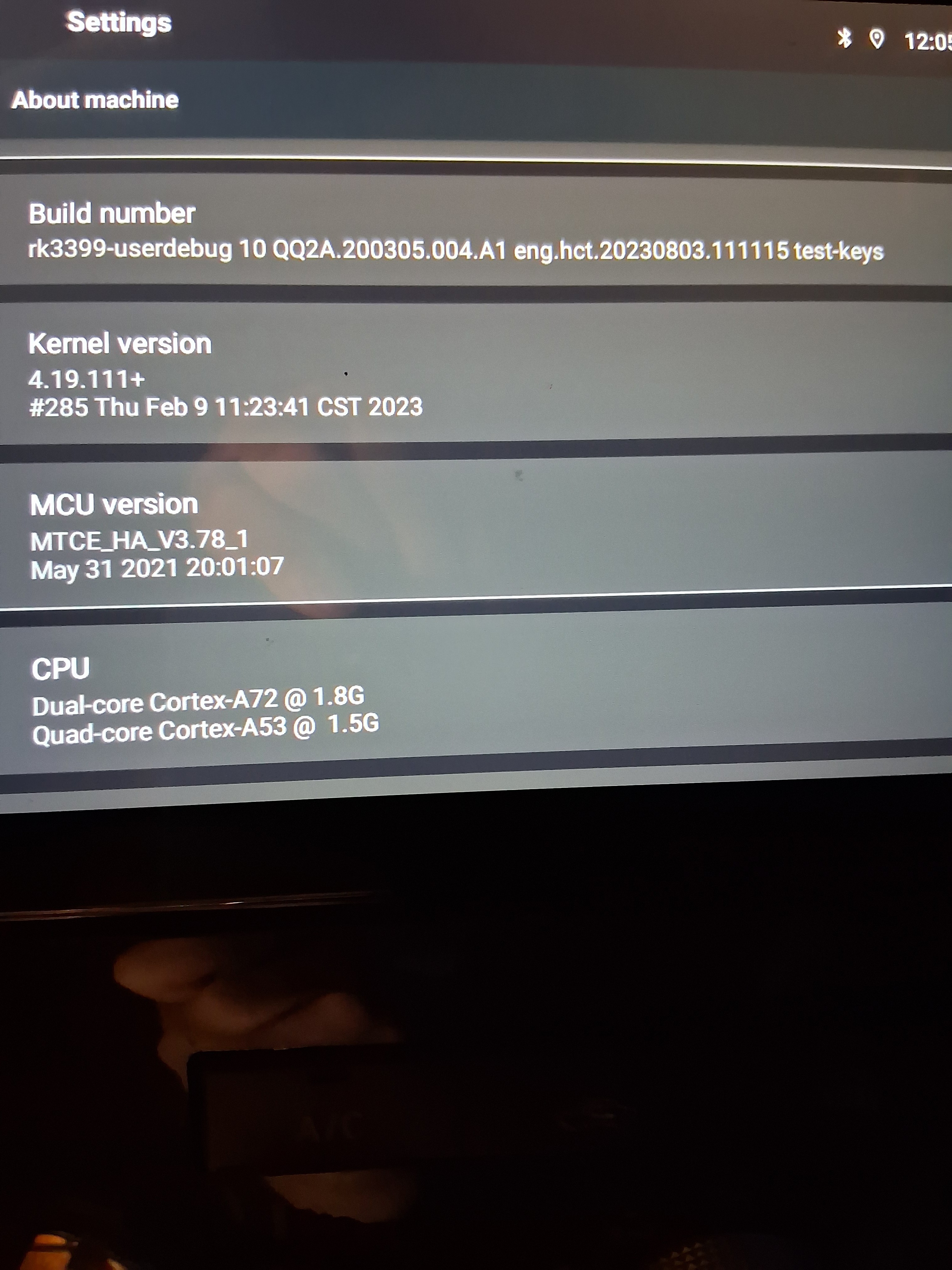

  • i dont have a order number , but i have a aux cable its not a dasaita cable  i had one and  did not fix the problem i will send a few picturesl
  • @Moose It seems that your model is MAX10(Android 10), in this case, we suggest you could purchase a whole set of new accessories cable.
  • i have all the proper connectors as seen in the last photo i sent, and thel aux in adapter ohms out good. this is why i believe the problem is in the radio as in my original post .  is this repairable  ?
  • @Moose Repairing the hardware issue may need new mother board or coreboard which has been stopped producing now. In this case, we suggest you could order a new G13 radio.
