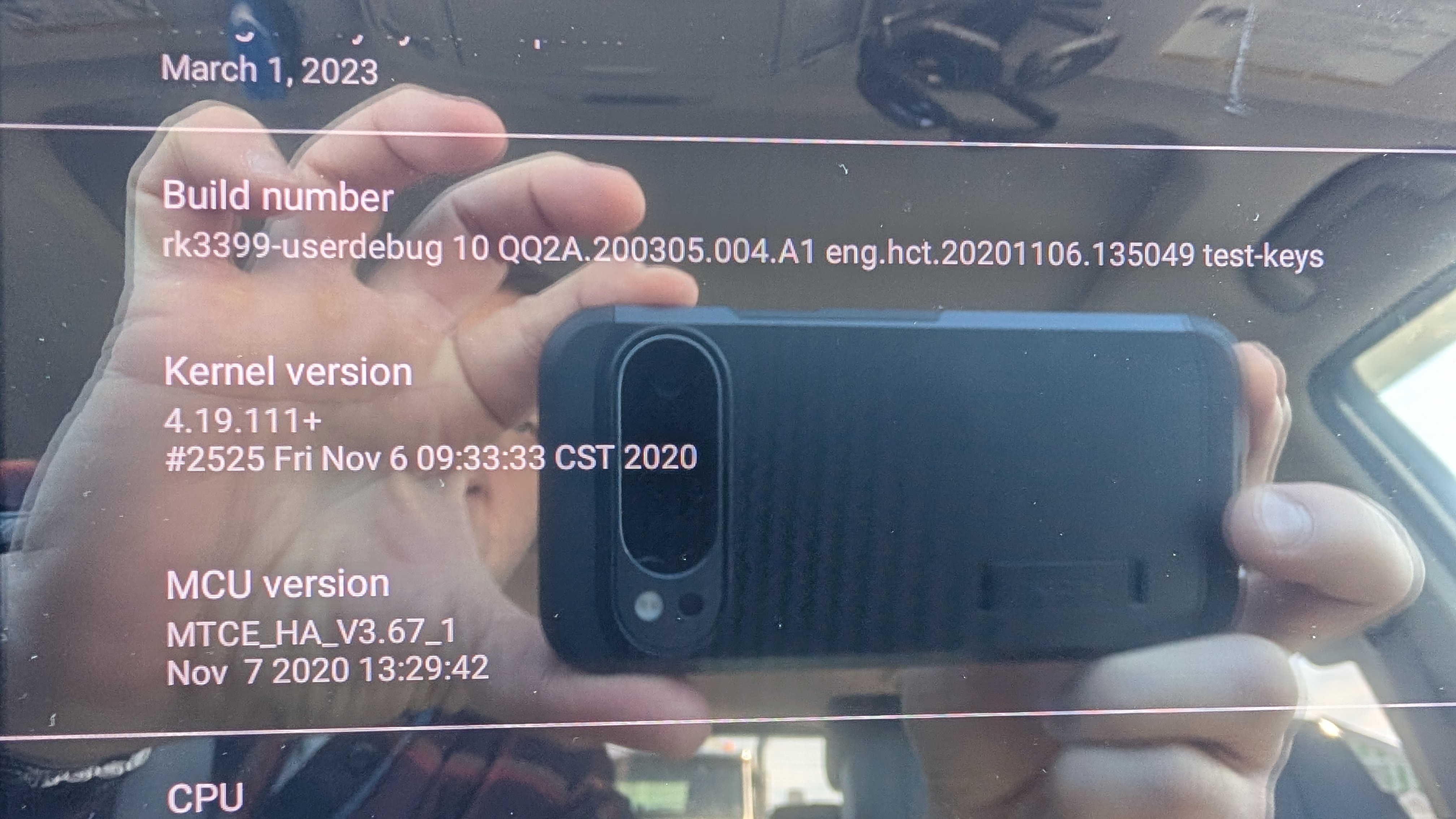

When I purchased my head unit. Your company told me that it would work Wireless with Android auto. It does not, can I update anything to make it work? Here is a picture of my system.
@Trey Simmons Hi there, you could go to Settings > About Machine and send us the current Build Number and MCU Version so that we could better confirm.
@Support Dasaita
@Trey Simmons Please kindly update Max10(20230302):

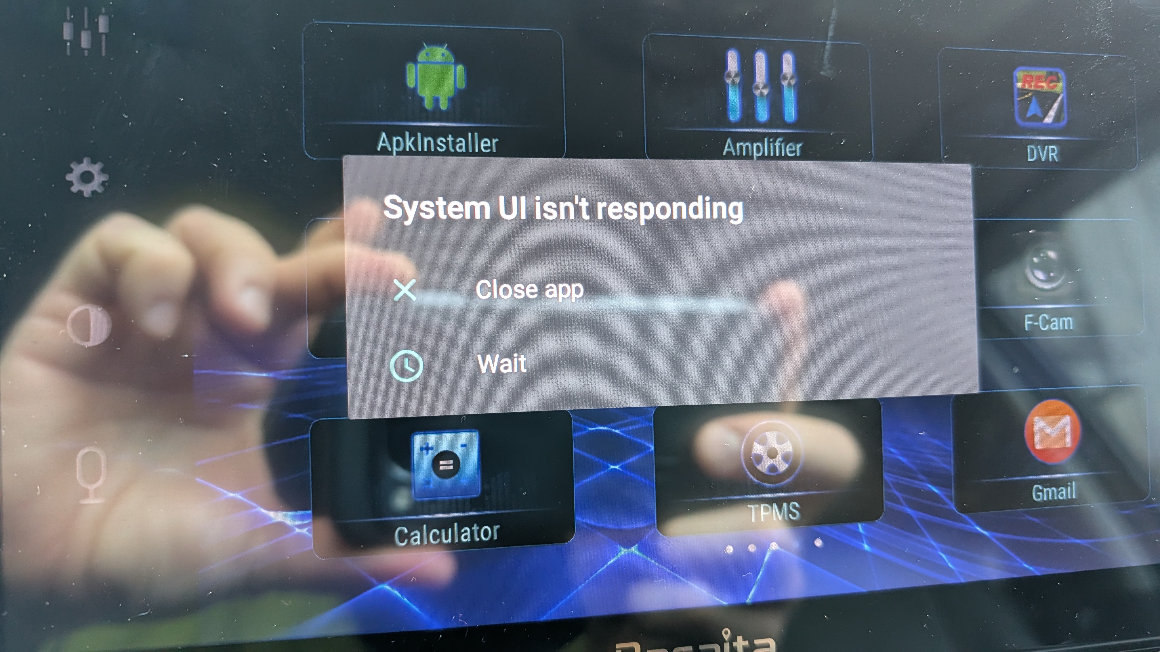

@Support Dasaita unfortunately that didn't help anything and actually made my unit useless. It now throws a "system ui isn't responding" error and then restarts. I followed the update directions perfectly.
@Support Dasaita I am able to quickly navigate to here before it freezes.
